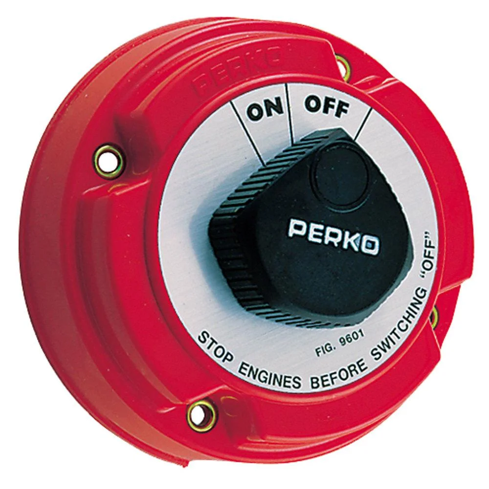

I used one of these for 28 years. Never a problem even when mixing AGM and flooded lead acid
