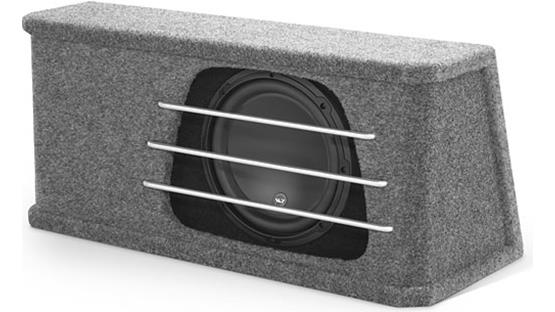

@dfinn I definitely noticed more bass in those speakers than the stock ones. However, I also put a JL Audio 10" in a shallow mount box in the trunk but it is controlled by a bass knob by my right knee. I can turn that down and there is still a good amount of bass coming from the door speakers
I have 12" now but it's taking up allot of space. What model dos you get and did it come with the enclosure?
@bucfl I was considering the 12" but decided on 10" instead since I've always had a better experience with the latter. JL Audio HO110RG-W3v3, and yes it came in a shallow mount wedge enclosure that tucks up nicely against the back of my rear seats
