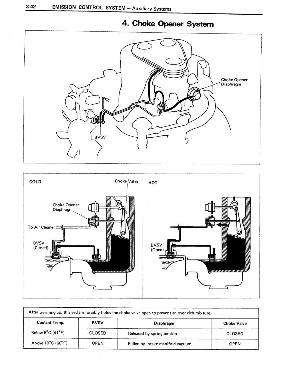

If you have an unmolested carburetor, pulling the choke knob when the engine is warm only acts as a throttle positioner. The Choke Opener system automatically deactivates the choke when the engine is warm.

On the Aisin carb, even with the choke knob pulled-the choke is disabled once you start driving and the knob is just a high idle switch at that point.
With the trollhole the choke never disables and you'll actually limit air into the motor the entire time and possibly damage something. Of course you'll notice this because the truck won't move happily once it's at temp with the choke engaged.
It's a non issue really, but it doesn't have the "auto choke lockout" that the Aisin does.
