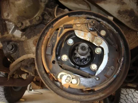

So, I was running a couple of errands with the 45 when I left the parking lot and drove away. I got out of the parking lot and down the street a bit when I started to smell something. I knew something was wrong and iommediately thought it was the trasfer case as I had taken off the PTO cover to see if I had the PTO gear earlier. I looked for a place to pull over and there was a gas station ahead so I thought I would go till then. I then heard some strange noises and then it seamed to drive normal again.
I still pulled into the station and parked and though "Oh my God" I hope I didn't royally screw something up! I looked around the cab and immediately noticed that I had not let off the parking brake. I disengaged it and thought that whatever I had broken in it, it was not hampering anything now, so I drove it the short way home with no issue.
I figured I must have broken a spring or worse in the parking brake, so I wanted to have a look at it before I drove too much more.
The whole assembly care apart pretty easy except for that damned staked nut holding the drum on. Once I figured out how to get that nut off, I found that everything inside the brake was perfectly fine.
What had happened was that the adjustment had popped out and the brake would not engage. So, after I put it all back together, all I had to do was to readjust the brakes so that the pads would make contact with the drum.
So, if you ever end up in this situation, try to readjust the brake before you tear into it if everything else seems to be fine!

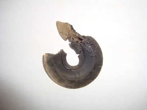

By the way, my rubber cover that goes over the adjustment nut is worn out. Does any one know if a new one can be obtained still?
yes, the rubbers should still be available. don't feel bad...everyone has done it. i learned real quick in cold weather states not to set the brake when it's real cold out because the shoes can freeze to the drum and won't disengage.

For that grommet just use some insertion rubber and wad punches to make your own.
That what I did and I've found it lasts even longer than the real thing (besides working just as well at sealing the gap to stop dust/dirt entering).

I think the insertion rubber I used would have been about 3/16" thick and the centre-hole needs to be a tight fit on the brake-adjustment-hex so that it slips into the indent and gets held there solidly.

Yes, the rubber adjuster grommet, return springs, shoes & drum are still readily available from Toyota. Just did a p-brake job last week
Any idea how much the grommet was and a part number? It's the only piece I need.
I guess any grommet of the right size would work, just drill a hole in it, but if they are still available, I might as well get one.
