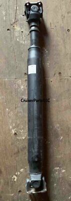

Driveshaft rebuild and balance are under $150 in Tucson per shaft at most shops (except Western Differential $$$). i have had shafts done in Salt Lake, Billings MT, Harrisburg PA, and Tucson and all have been really reasonable.
If your yokes and splines are blown and you need a new one.
$99 on ebay
Then get it retubed to length.
I cannot understand why people are afraid of driveshafts.
