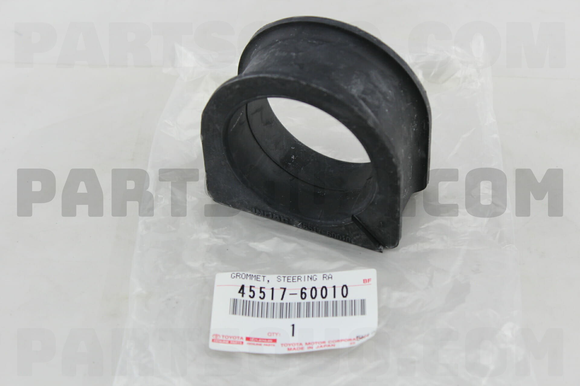

You may want to pick up this along with your new rack if it isn't already on your parts list.
