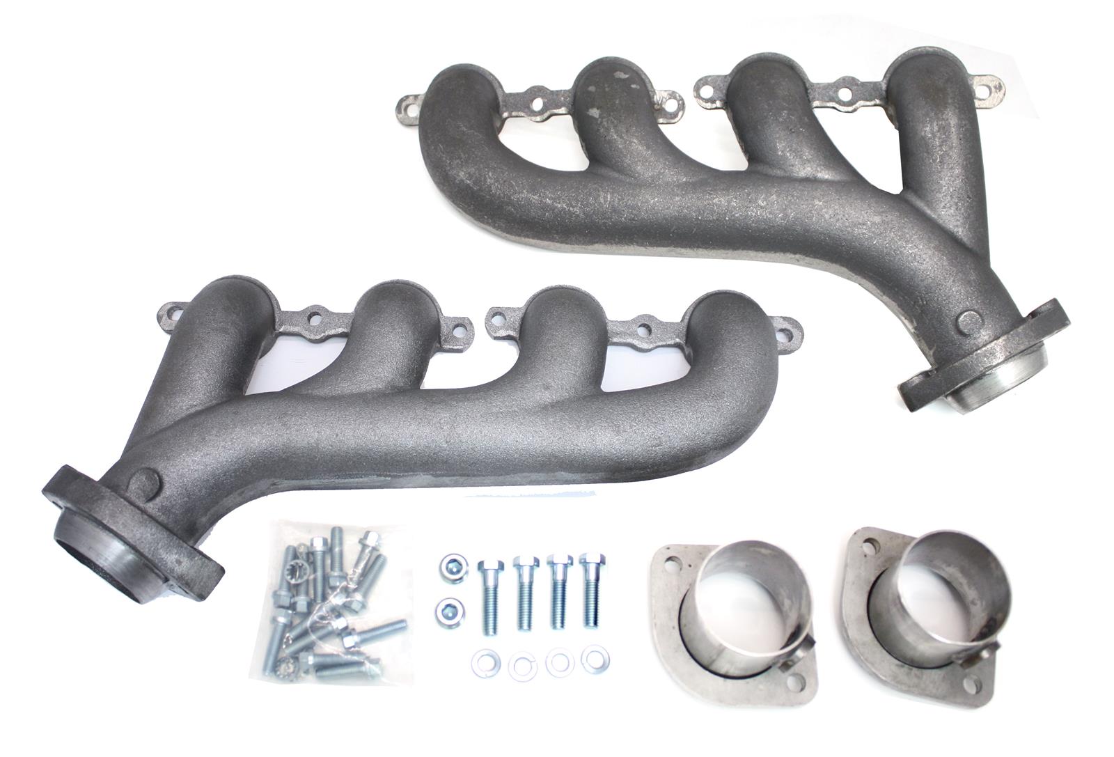

You’re going to re-seal the oil pan when you swap the pan out anyways. By the way, buy these, an actual good use of money for a LS swap:
^ He's on to something. You don't need to do much to those engines. Maybe add the Summit cam if you want to.
Just pressure wash it. Seriously. I bet it has perfect compression.

On the manifolds - I've been keeping an eye out for the C5 manifolds for dirt cheap. Good to know there's a fairly inexpensive, known good solution out of a box.

Those C5 manifolds are not what you want, they're going to go right where you're going to want to put your motor mounts

Sanderson Headers was the only supplier that snuck past my motor mounts.
Thanks Jim. Are those headers leak-prone? I hated dealing with leaky headers!
