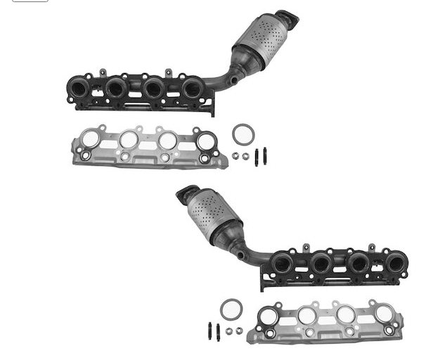

I noticed significantly more power on my 2007 with LT headers. Made a very big difference in the "butt dyno". My GX has plenty of power with the LT's and an aFe cold air intake (with the vast majority of the gains coming from the LT headers). Not only do the OEM manifolds crack, they are crazy-restrictive when you compare them to the headers - they really choke up the 2UZ.
As mentioned previously - I'd only go with LT's if you are 100% sure you aren't going to have to deal with intrusive emissions inspections, either now or in the future. Living down here in the Ozarks I fall into that bucket, but many folks do not. Otherwise, get the ST's and keep you cats.

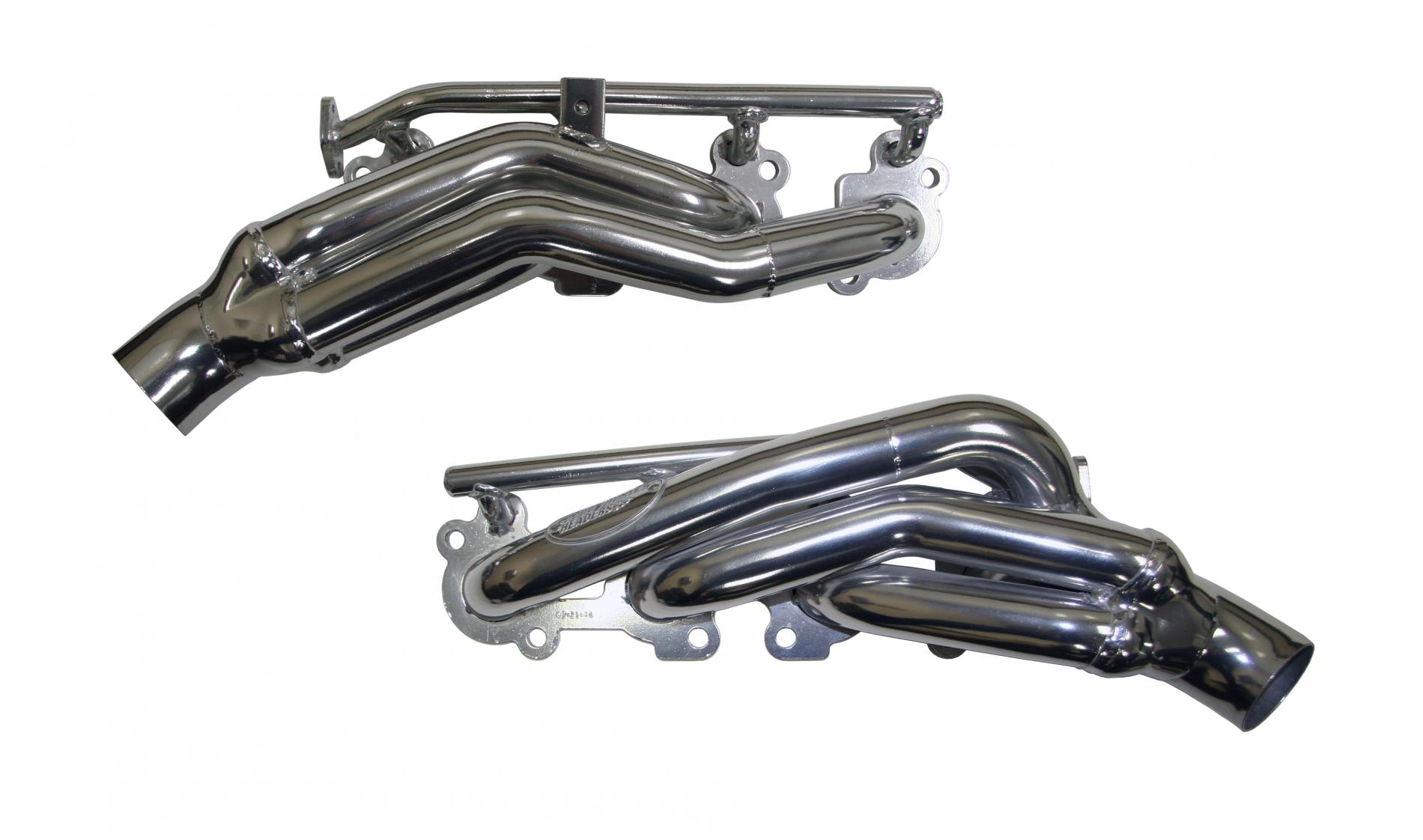

LT terminate in a flange which bolts up to stock flange upstream of 2nd cat. To retain 1st cats to LT headers (or welding a flange to cat and bolting up to LT) you'll end up doing custom downstream of header replacing the Y-pipe to get 2 cats on each side before the Y-junction going into the single exhaust. At that point, might as well go full custom with twin pipes, each side has its 2 cats, resonator and muffler, or aftermarket with appropriate cats and muffler(s). 🤷‍♂️
The LT bolt up to the stock downstream flanges overriding the 1st cats.
LT are 4:2, 2:1 collectors

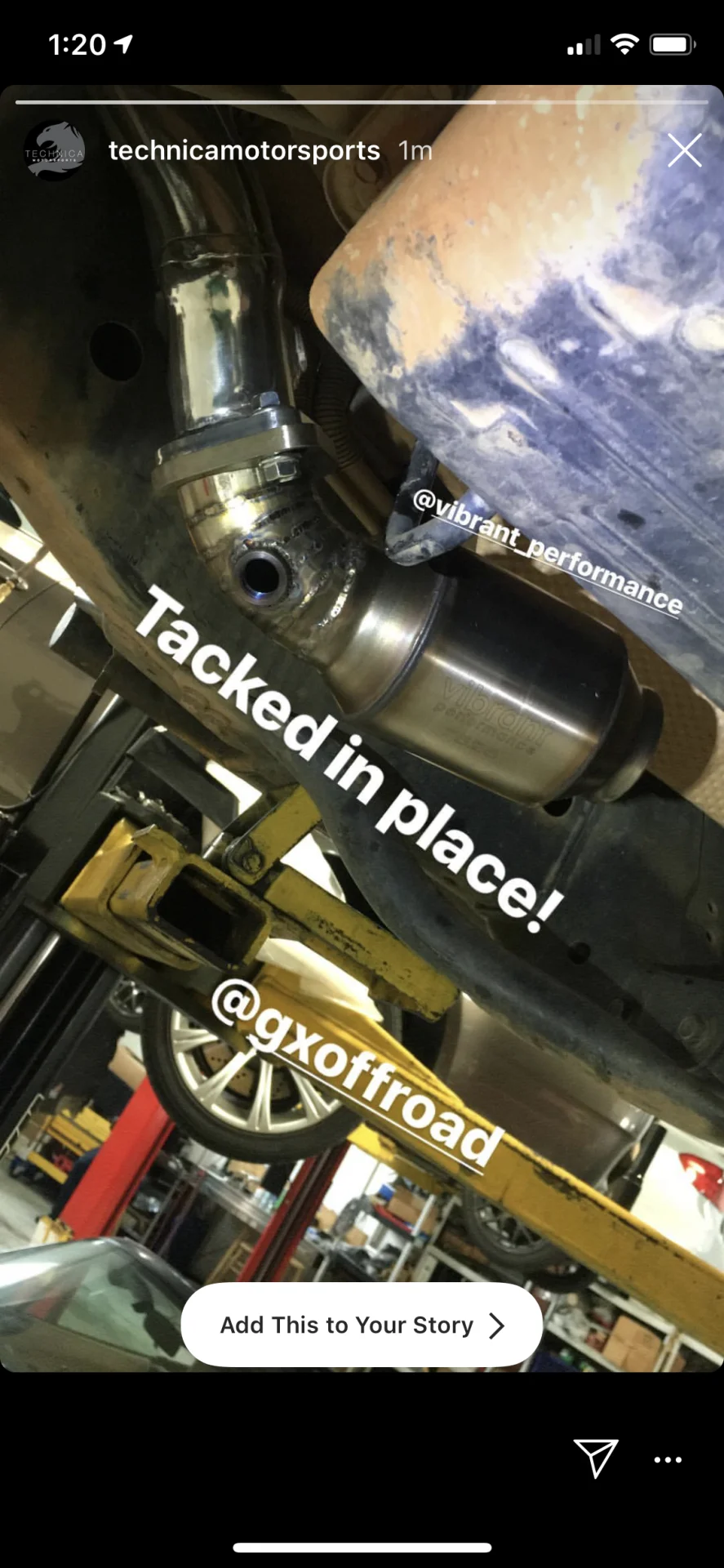

The ST get stock 1st cats welded to them, but this is a fiddly process.
Unbolt engine from mounts and jack up, remove manifold and cut top of cats off per DT instructions, loosely fit header to block and lower onto mounts, mock cat to header and align downstream flange (repeat previous as needed to get proper alignment of cat to header in situ), tack cat to header, remove header and cat, fully weld cat to header, replace header with cat to block and bolt up, lower engine and bolt up mounts, bolt it all together.
ST are 4:1 collectors.

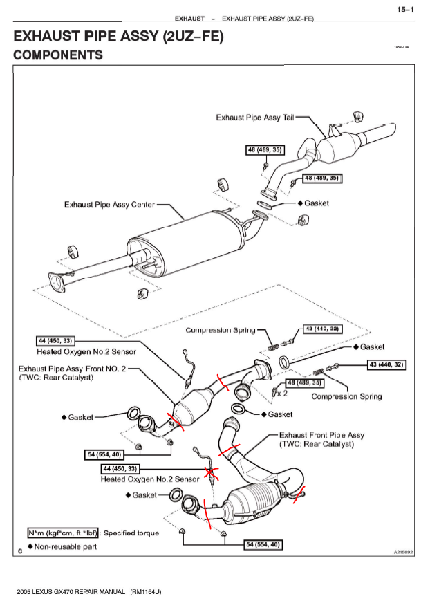

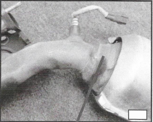

Pics from DT instructions (linked above) showing location of cut to be made removing cat from manifold tube and cat welded to ST's open pipe
View attachment 3124312View attachment 3124308
View attachment 3124297View attachment 3124289
The flange downstream of the 1st cats downstream of the manifold bolt up to the flanges in pic above right.
Each side is: block, manifold, bend, cat, flange;
driver goes pipe/bend, cat, bend, tube, bend, flange to Y-pipe collector;
passenger goes pipe/bend, cat, tube with Y-collector from driver, then flange;
then pipe, muffler, bend, flange, pipe, bends, resonator, pipe, tip.
Sadly, I haven't been able to find a singular diagram showing all this as is laid out in the truck...

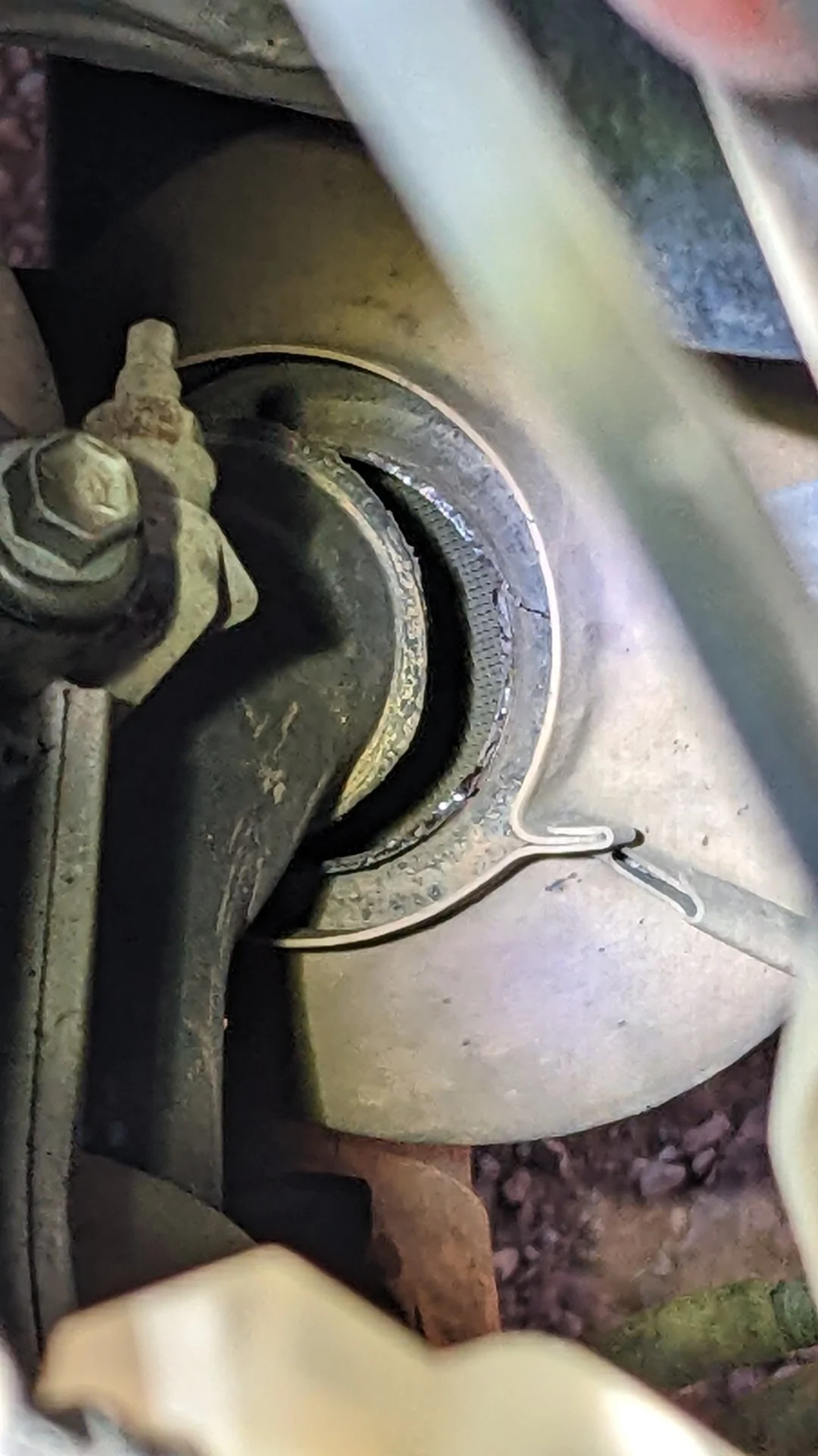

My driver side exhaust gave up the ghost this weekend, so my issue is forced.
(Looking down @ manifold- cat-mani weld fail from engine bay,. Driver a side)
Going for basic DT install: remove bits, cut top of cats, fit to headers, tack, bench weld, install.
Need more tools, flange studs are external torx, need e-torx socket (8mm?)
Most of your studs will probably come out as more of a bolt. If a stud does stay in I would probably re-use it. The etorx fastener is kind os small/weak and stripped whem I tried to use it to pull mine.
I really think you have a broken powertrain mount somewhere. The OEM manifolds really shouldn't beeak like that unless there is flex in the system that is not supposed to be there.
I agree. Having seen my motor mounts when I did the RCLT and 200 series rack upgrade and having to replace them you should for sure suspect them haha.
