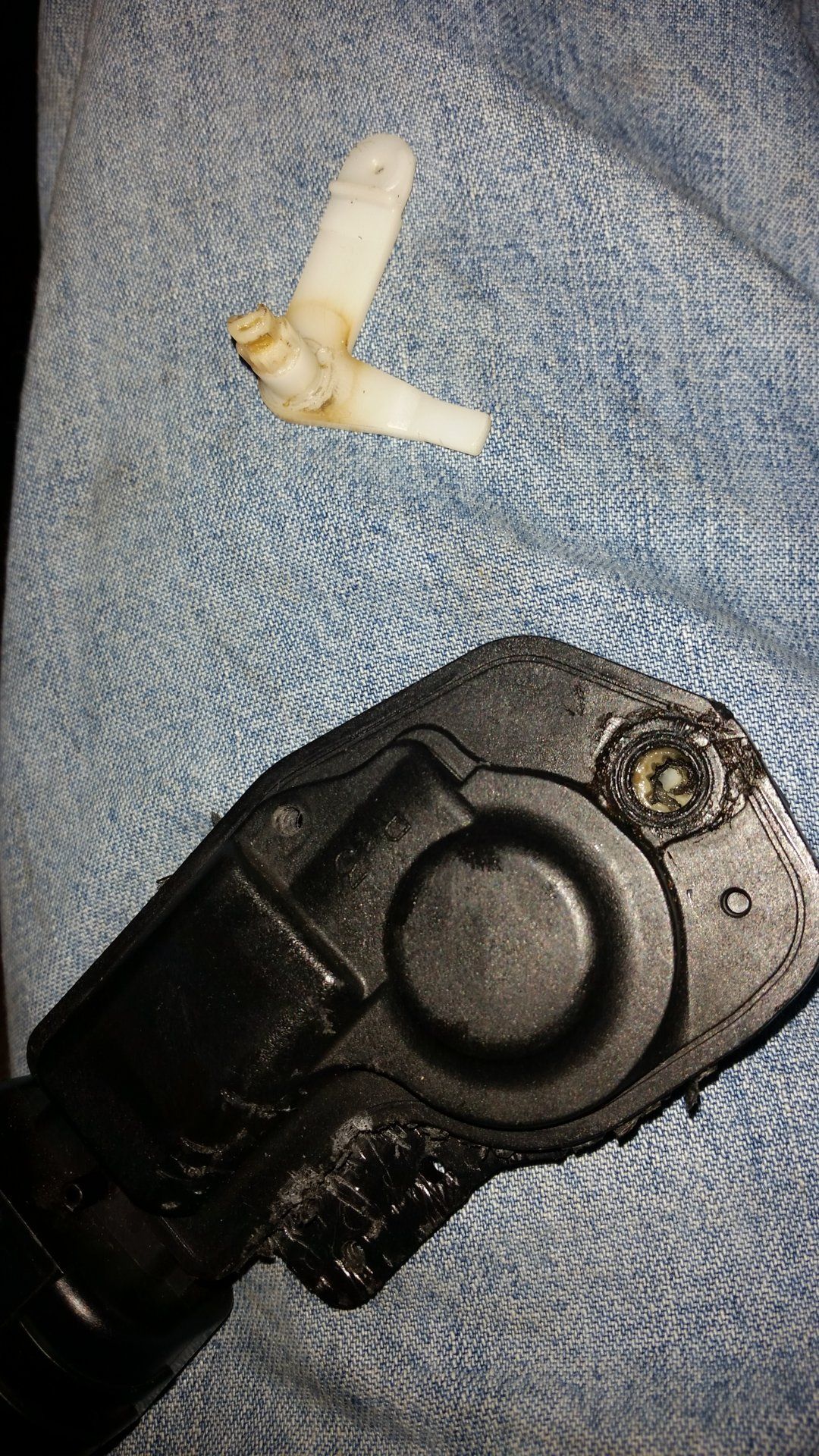

Here is where that small black pieced came from! Mine fell of to, I was looking at Camry Actuators and ran across this pic. Same act. as my LC, Im going to order one and give it a try. Why are some having to reprogram their remotes? Thanks!
1997-01 Toyota Camry Door Lock Actuator Front Passenger Side - 1ADLA00074 at 1A Auto.com
View attachment 1622323 Has anyone tried this or know of a better option? I have a cable stop broken on one end( circled item). I replaced the motor already but the plastic end on the cable is broken... I’m assuming that the item for sale just has a replaced motor in it...what do ya think?

it uses round. Kick in get it done mode and after 1 minutes with a grinder I now have a "D" shaft motor
and all working door locksAnyone had this happen while trying to open up the actuator? Apparently the teeth are now broken, any solution for this? Is there another actuator out there? Thanks
After looking at it, it seems this piece just pops out, maybe not broken after all. I may be able to swap this piece into the new Camry actuator I bought!!

Why? If you can get this far, you can swap the motors in there.
