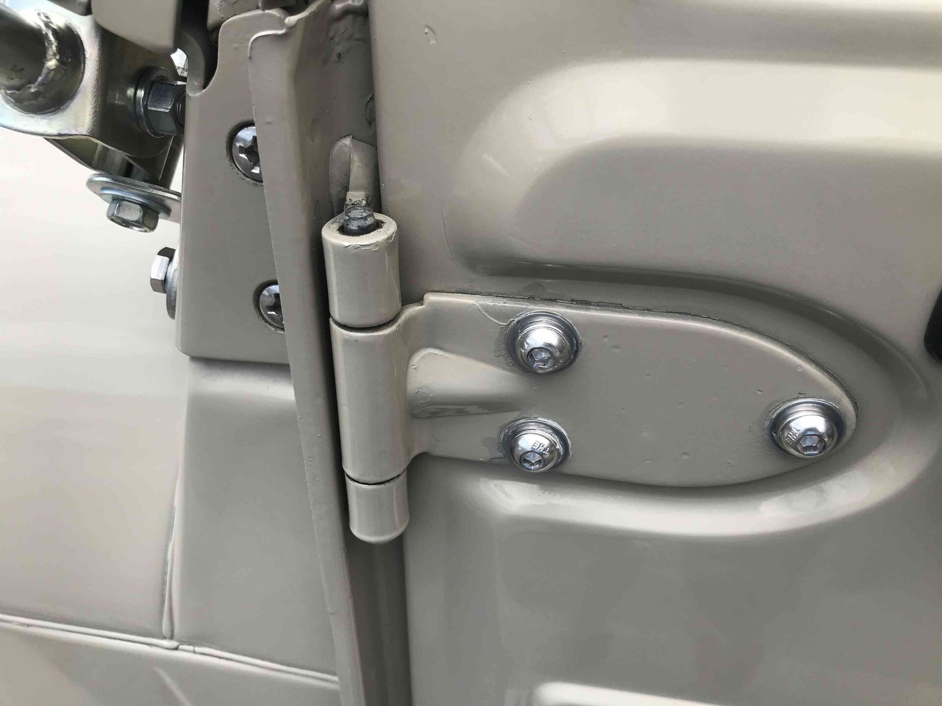

I remove my top and doors every spring and put them back on every fall. I have OEM door hinges that are a pain to remove. Anyone have any luck removing only the pin from the OEM hinges?

Go this route from @SMG . If you're only pulling the doors once per year these SS pins are probably a better option. Takes me about 5 minutes to pull both doors.
The pins will come out of the oem hinges, it'll just take some effort depending on what you have to work with. You'll have to pivot the windshield forward a few inches to get the upper pins out. Do some searching in the forum and you'll find plenty of threads with pics.
I have seen somewhere people grinding one side of the top pin down a little so you don't have to fold windshield. Anyone try this?

1. Not sure why you would want to weld them, you would lose the ability to adjust them. Mine are just bolted on to the stock mounting plates.
2. Yes, you will want to do that, because the opening in the tub is large enough to be able to move the hinges for adjustment.
3. That's what I did.

Threaded on both ends, so could take out top and push down through.

Are the pins threaded? My pins have a rounded top which leads me to believe they aren't threaded. I removed one hinge from the tub, put it in a vice and pounded on the pins but can't get them to budge. Afraid I'll start damaging the pins if I pound any harder. Might be easier to replace all the hinges.

The OEM pins are not threaded. You just have to pound them out. A 3 pounds drilling hammer and correct size punch is what I used. I don't know if having the hinge off the truck in a vice is doing you any favors. Having it bolted on to the body and door with the door shut is way more solid than a vice could do without damaging the hinge. This was not an easy job for sure. Can you take a couple pictures of what you're working with and posting them up? Depending on the condition we might have different suggestions for you. Most people go with the @SMG pins b/c they don't want to deal with the tub-side hinge bolts. I assume you pulled off the passenger side? The driver side is a bigger PITA. I took one look at where those bolts were and about 3 seconds later decided to just use @SMG pins.

Correct, I removed the lower passenger side hinge. I'll have to remove the fuse box to get access to/remove the upper driver's side hinge if I want to replace the entire hinge. I'll try pounding out the other passenger side pin that's still on the tub with a 3lb hand sledge and a punch. I'll post pictures but not until this weekend since the LC is at a second home in Wisconsin for the summer. Maybe I don't have OEM hinges but I'm sure guys will be able to confirm once I post pictures.

FWIW - Once you get the OEM upper door pins out, you can reinstall them upside down. It has been four years since I've had my door off....I just hope it isn't that much longer till I go topless and reinstall the bikini & soft doors!!!!

Update: Success! A 3lb sledge and correct-sized punch was all it took. One of the hinges put up a fight but eventually surrendered. Thanks for the great advice.
