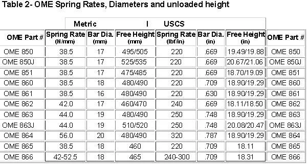

OME851 light load
OME850 heavy load (20mm taller than OME851)
Our Land cruiser coils have a linear rate-the spring rate is constant during all stages of coil compression.
We do not have any data regarding the medium spring with spacer versus the heavier spring.
Edit May 2006 Two tables I develepoed from info on Slle and Cruiseroutfitters sites as part of the new FAQ I am doing. Similar to lots of data posted here on. Updated this post so I had a place the link it from.

so basically, if the rates are linear and the same for both heavy and med, and the springs are linear, that would mean that there should be no difference whatsoever dynamics wise between a heavy and a med+spacer the same length, right?
How about sturdiness, stability etc?
This is exactly what I'm getting from reading this ..... however, this would not explain why people with heavies and light additional weight experience a rougher ride. So either this theory is flawed or the people with the heavies and rough ride are "feeling" something thats not there? :confused:

All these springs probably lift the vehicle their stated height if you have the weight on your cruiser that they are rated for. In other words, add 200 - 300 lbs. to the back of a cruiser with heavy springs and it will probably sit at the same height as the mediums without the extra weight.
J spings would sit an inch higher than the heavies with the same weight.

I would suspect that the heavies are comprised of material of a lower tensile strength in order to have the same Lbs/inch rating, if you remember that cutting a spring down increases its Lbs/inch rate! :)

To simplify things you’ll have less space between
your spring coils using short springs+shims compared
to longer springs of the same rate and the same amount
of weight.
What does this mean, simply you’ll have less compression
travel with springs+shims i.e. less space between coils.
