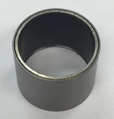

On my 2007 tundra I have replaced driver side CV axle needle bearing with bushing to help control vibration and shaft float common on the front differential. East Coast Gear Supply offers bushing for Tundra and other rigs. Since the front axle is same except of length. This should work for LC200 as well. It is not an issue at stock height. But after lifting this is known to be an issue in Tundra.
My question is does 200 series front differential uses needle bearing or bushing? I will be doing a lift in few months and collecting parts at this time. I like to knock this out of the way when I swap parts with Tundra IFS.
I understand if you are using ARB front lockers then this is not an issue. I am not planning on ARB lockers at this time.
@bjowett @just differentials @TexAZ @sleeoffroad @cruiseroutfit you guys are experts. Any feedback would be greatly appreciated. Thanks.
Thanks. I also got a response from ECGS that bushing does not work for full time 4 wheel drive model. One less thing to worry about. Bushing is only applicable to part time 4 wheel drive.
In the 200 there is no bearing, the CV stub sits and spins right in the diff housing. There may be (?) grooves machined in to the bore to supply lube... I need to double check. The bearing exists in the part time trucks as the CV and stub are spinning while in 2WD, but the diff housing is not.
How is this holding up on your 07' Tundra? I just ordered a bushing from ECGS for mine and was curious to get your feedback. Thanks
No issues and my axles seals never leaked again. It’s a good design compared to needle bearing.
