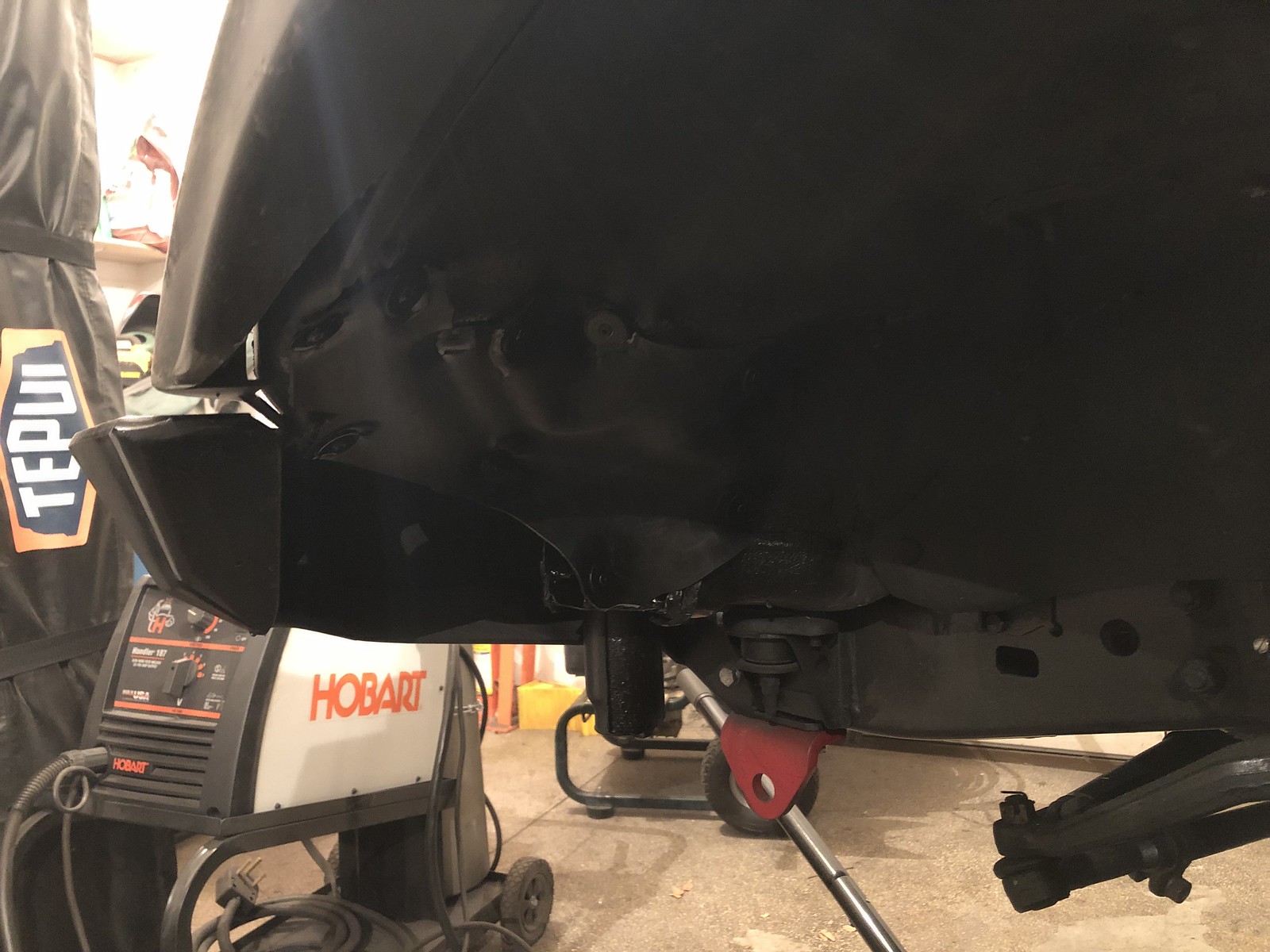

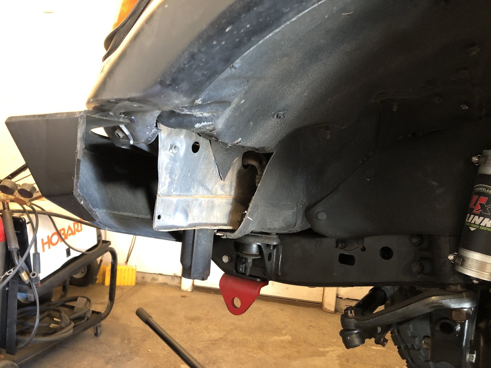

I didn't do any trimming until I had the 37's but that's also because I didn't move the axle forward until I had the 37s. But my lift height is a little taller than what you have planned and I am pretty confident even with 35's you may have some minor clearance issues to address after moving the axle.
This is what I took off the bumper wing (was originally flush with the edge of the flare at the wheel arch.
80 mods by Adam Tolman, on Flickr
This was the first sheet metal cut of the inner fender. I also removed the part of the core support that is still visible behind this cut. Cut the core support to match this cut.
Cuurently the area is covered with a thick rubber "inner fender liner" that is riveted in place. Eventually I will do a full sheet metal repair to close it up and give it a more "factory" appearance. But I'm waiting to do that until I get the truck ready for a repaint and have some other sheetmetal work I want to do in preparation for that.
