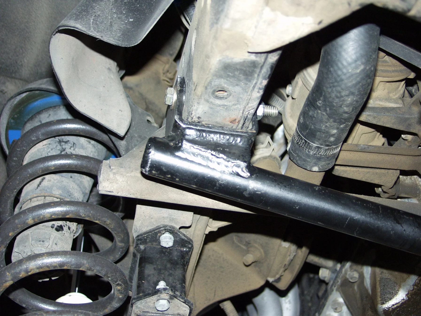

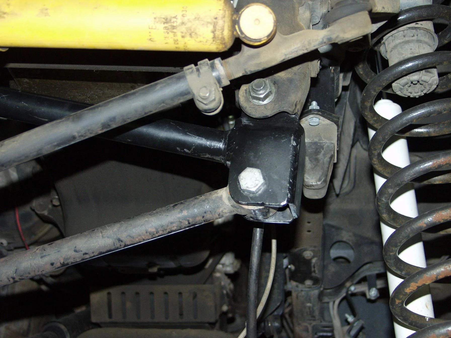

I don't anymore. I might be the first. I built a whole kit for Man-a-Fre in the mid 2000s. I had drop radius, drop rear lower control,
drop front and rear panhard and drop upper rear control arms. I also built Lower and upper rear controls, the upper being adjustable on the truck. After the crash the market dropped out and Man-a-fre never really got back to the size they were. Man-a-fre only kept the FRABs ( front radius arm bracket ). Chinese parts like the lower rears became available cheaper. We made ours from 2 3/8 x .375 wall DOM. The Chinese stuff is much cheaper. I will admit that the original Slee arms were even better. His first ones were TIG welded
Chromoly heavy wall. When the mild steel stuff started hitting the shores the high end parts became hard to sell. Slee went to
lighter stuff, .188 wall DOM. Many of the Chinese units are just solid 27mm mild steel bar. Some are tube but Chinese and India
sourced DOM is not the same as US or European sourced DOM.
Yeah, you were out in front of this stuff! These types of geometry corrections are really quite significant in restoring proper handling (even though most of the aftermarket ignores them.)
I always raise the panhards when I can, but the front of the 80 is a pickle in that department. :) Do you have any old photos of your front drop solution?

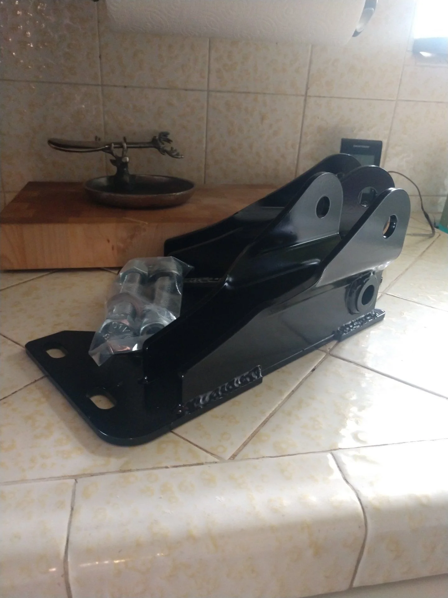

I just finished up some rear panhard lift brackets for the 80, in fact. Selectable for 50, 75, 100, & 125mm lift heights (similar to my 3rd gen 4Runner stuff.)

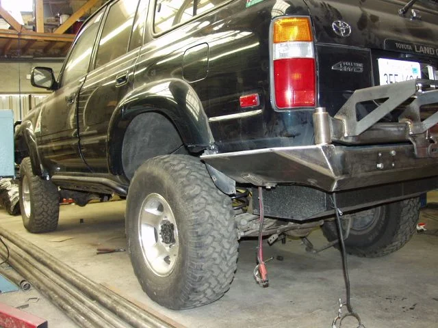

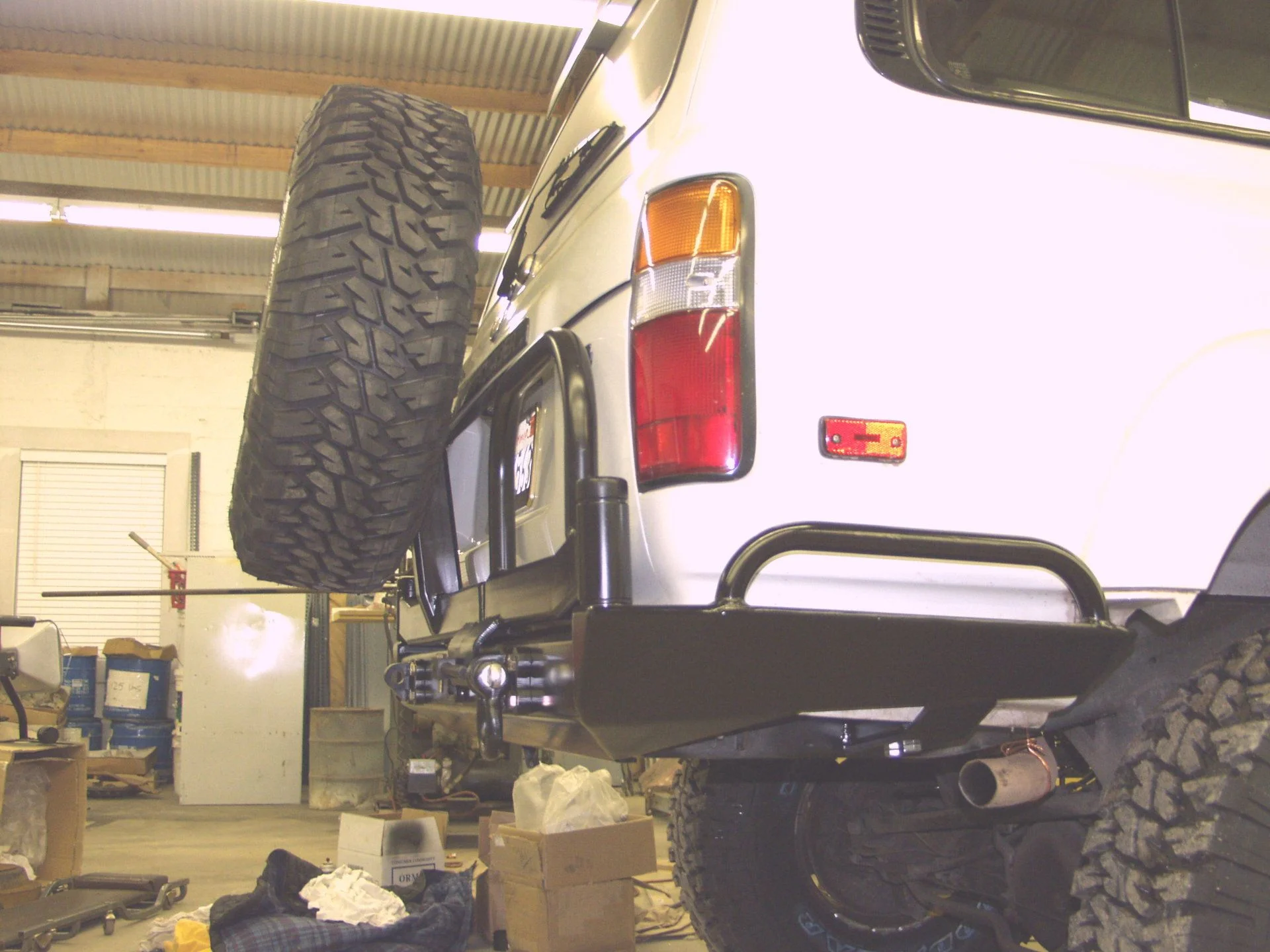

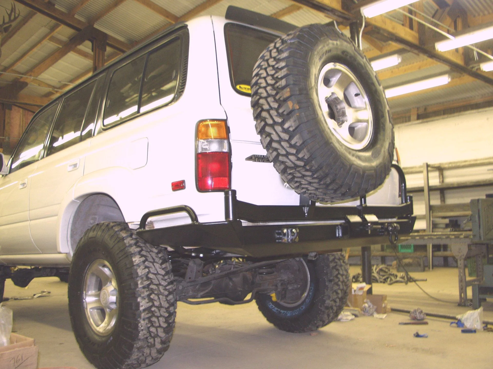

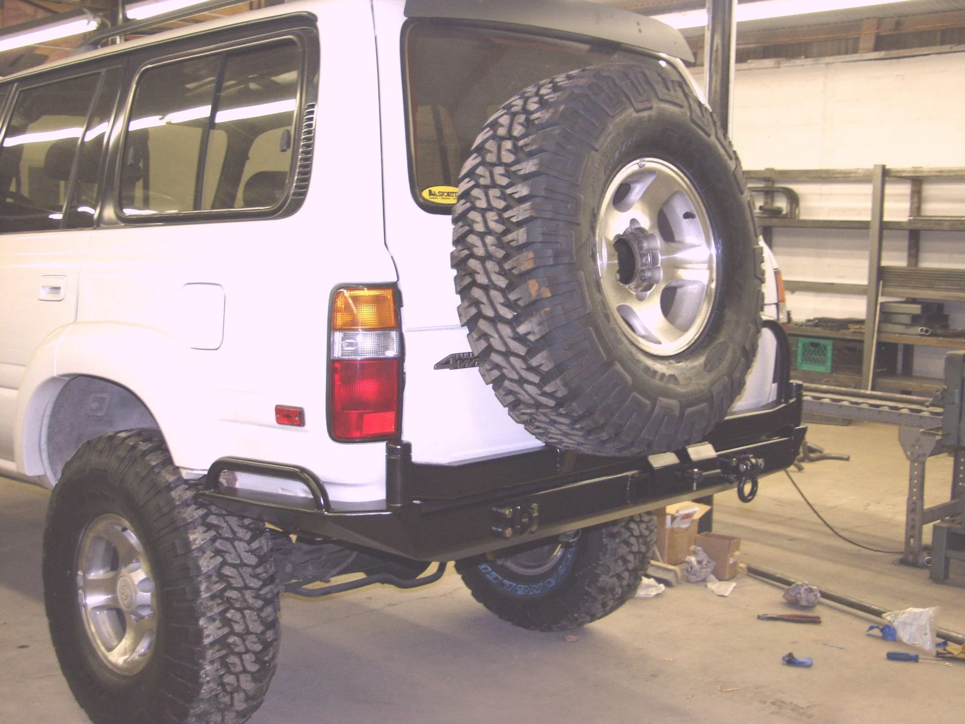

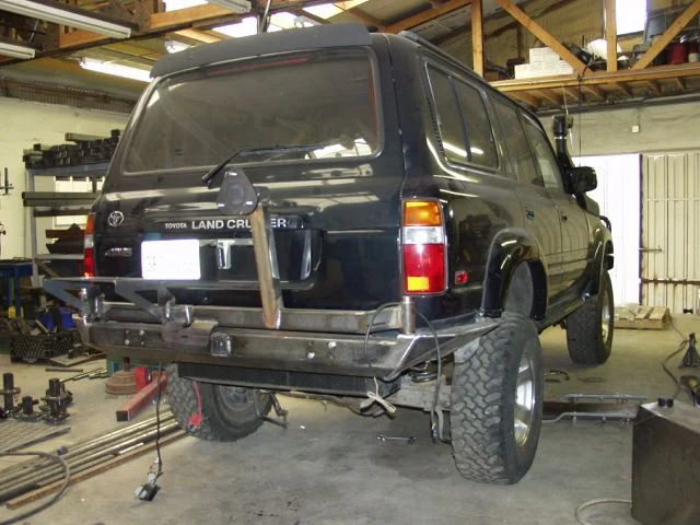

These are pics from the first prototyping. Certain appearances changed in the execution but geometry and concepts are
right. Prototypes are the rough drawings. Later you add the pretty
The first80 rear . I believe these were the last two I built in 2002. I was selling through Man-a-Fre. They couldn't get any interest
over the three years so they cancelled them
Lots of good stuff going on there - tight to the tailgate, high clearance sides - that's impressive for that long ago!
very nice.

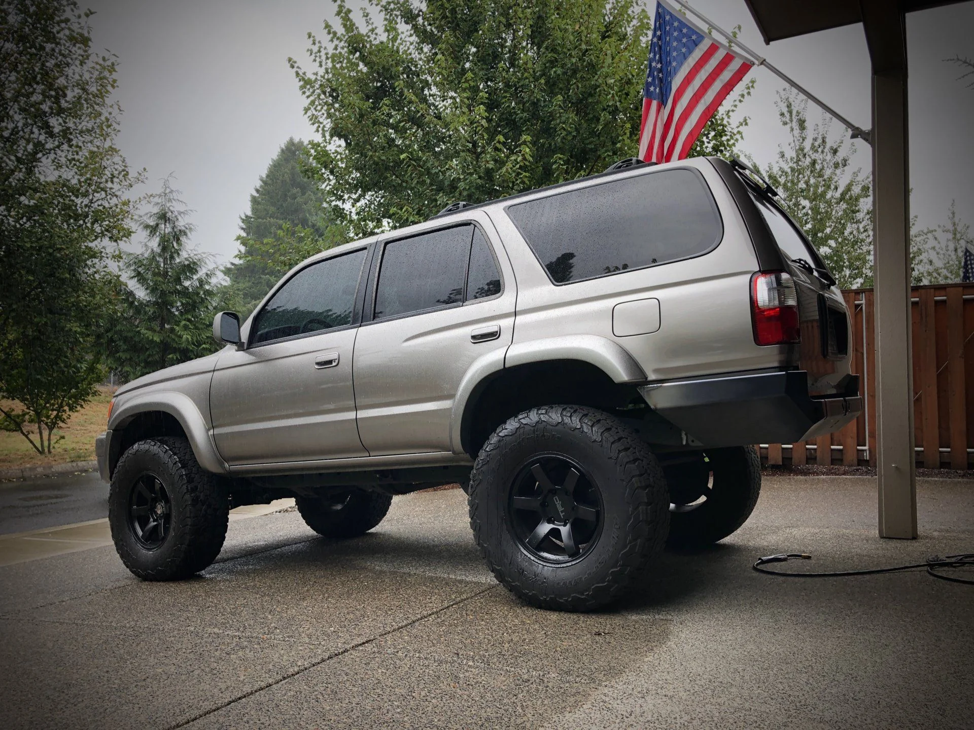

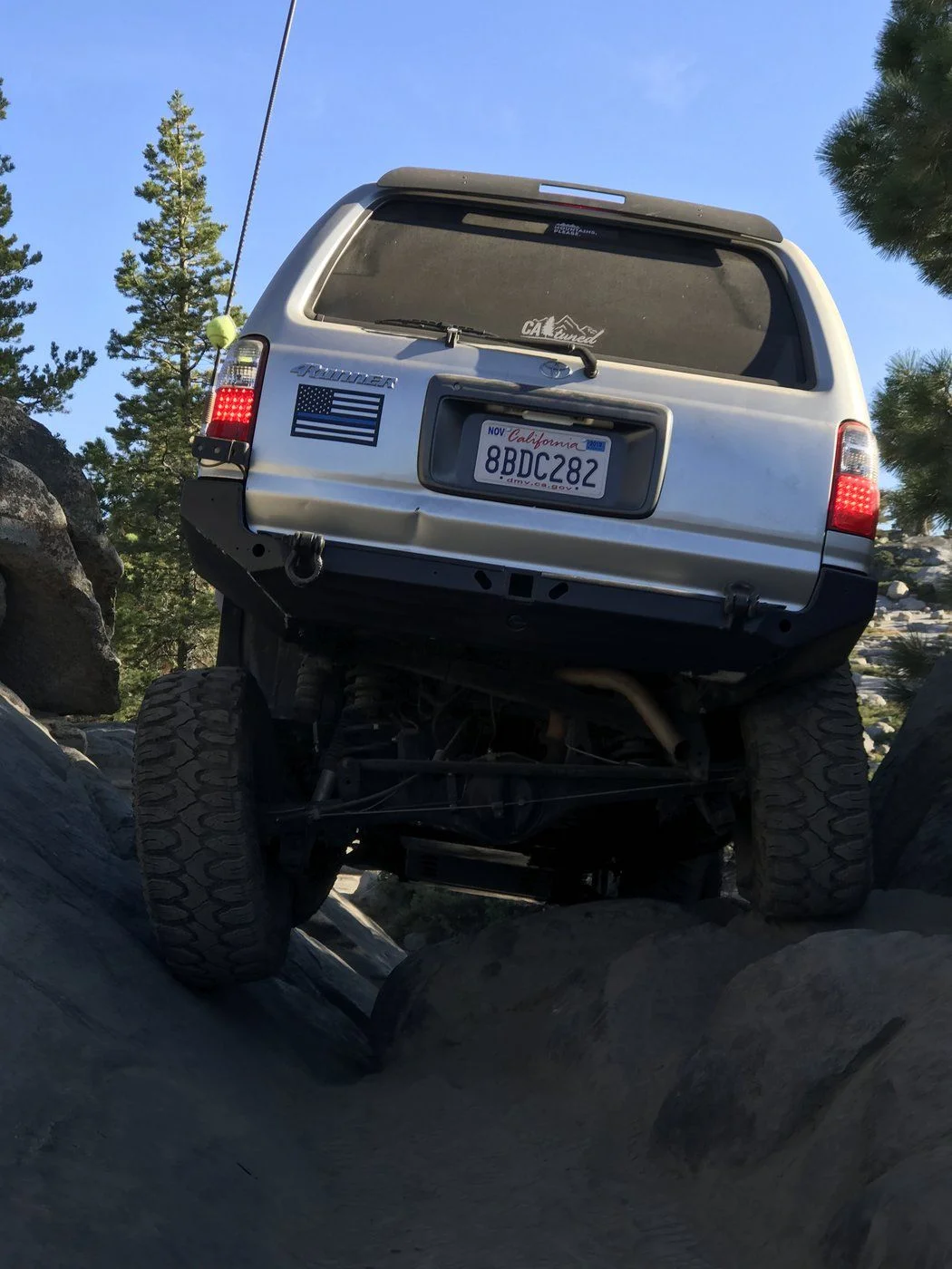

Here's a rear that I do for the 3rd gen 4Runner that you may appreciate, seeing as it's on the same wavelength, so to speak...:
- incidentally, you can see my panhard correction in both photos as well.
(great minds, eh?)
