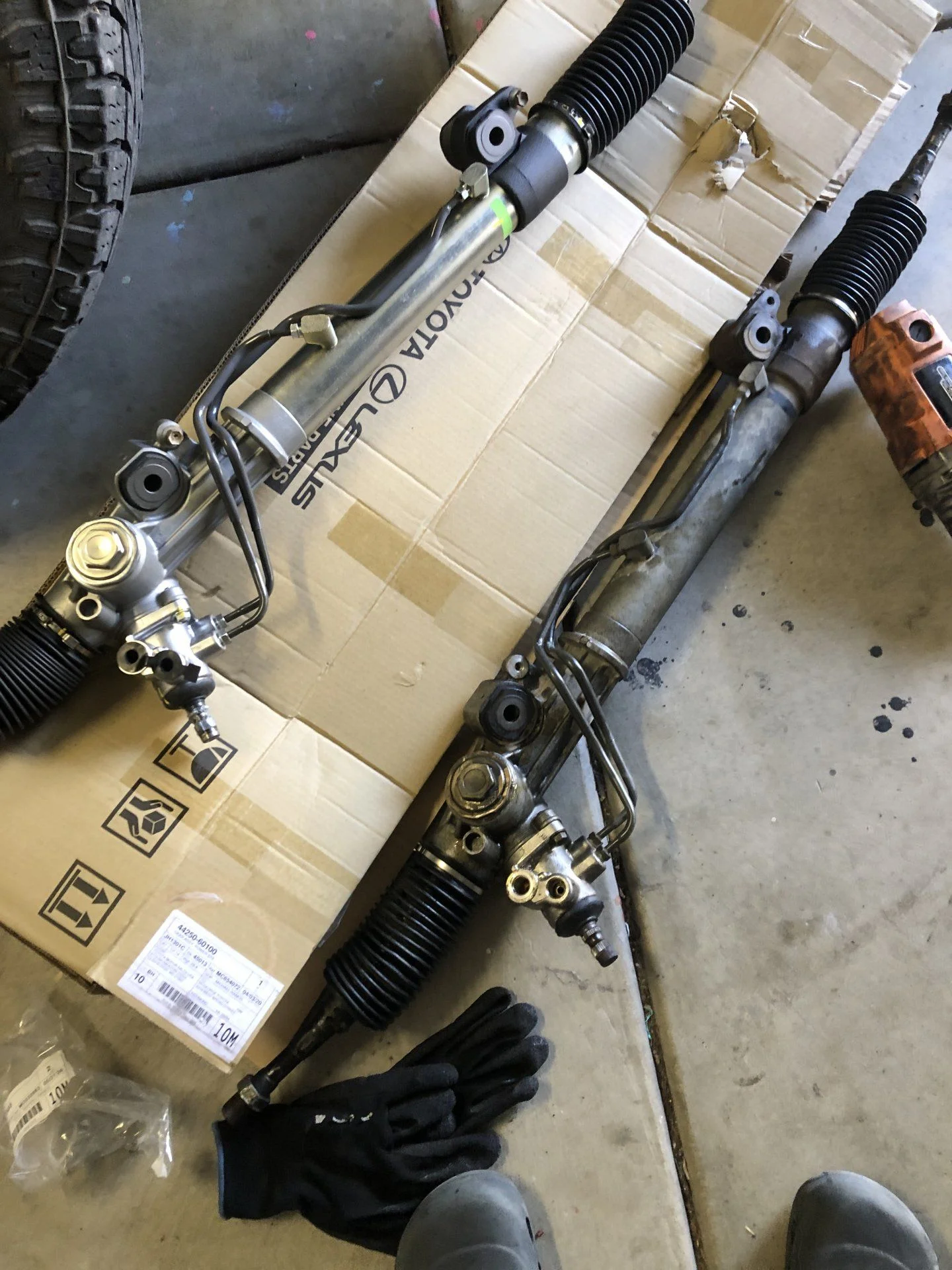

I have a 05 lx 470 133k miles and recently done my steering rack with a Toyota rack. It was leaking. I’ve read the turning ratio is different but I can’t even tell.

The rack was around 7 shipped. The Lexus rack was 11-1200 shipped.

I think @MongooseGA put a Toyota rack in his LX a few months ago - post #138
Can confirm. I used the Toyota part #, not Lexus. Since my original rack was pretty well toasted by the time of replacement, I can't really accout for any difference in steering feel between the two. Since my tires kind of prevent me from throwing the wheels all the way to lock all the time, I can't account for the ratio change. I can say the rack works perfectly and required no special parts vs what the Lexus part would have. The VGRS system isn't actually a part of the steering rack so as long as the unit you're looking at is correct for the model year, it will work in a Lexus and VGRS will still be functional.
Basically, there's literally NO reason I can think of to order the pricier Lexus part than the Toyota part.
