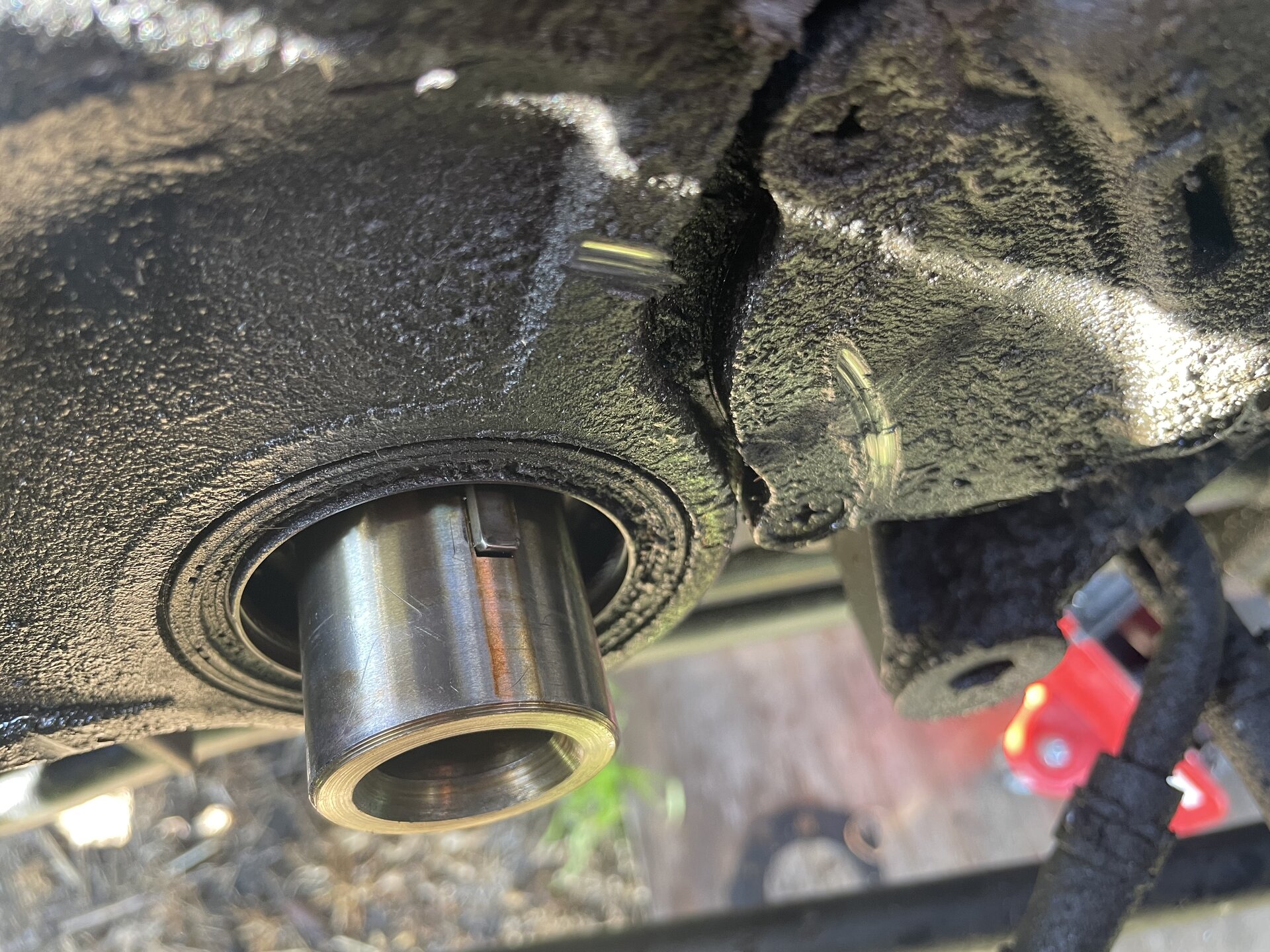

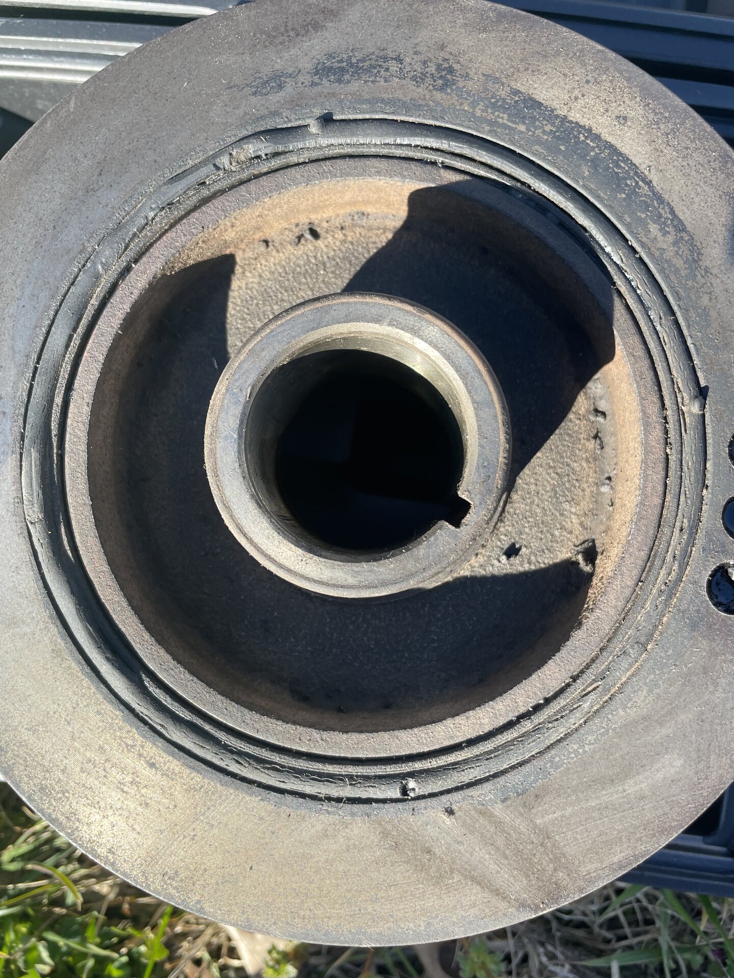

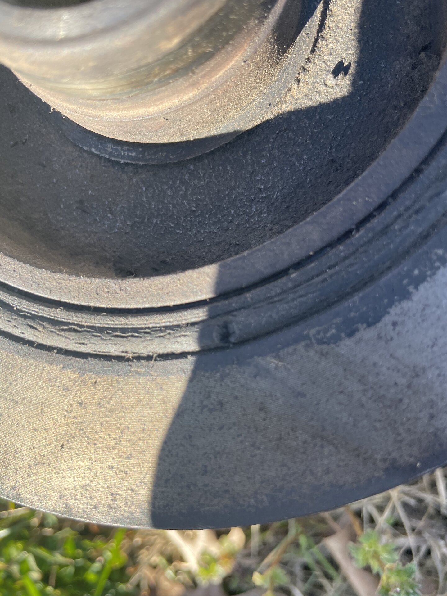

Pulled my crank pulley and noticed some issues on the back of the pulley and on the block where the pulley was maybe rubbing? What do you mechanically minded guys think?

Interesting. Before to change anything, I’d investigate why it is rubbing and find the source of the problem. Either the shaft is off (which is unlikely) or the harmonic balancer is.

OK so looks like there was a piece of hard dirt or a small rock that had embedded into the rubber on the back of the pulley causing the "rubbing". Any issues with that rubber piece looking cracked on the back?
I replaced mine because I don’t need to know exactly how long a harmonic balancer will last until one day catastrophe comes to town. I think of that rubber section as I do the suspension bushings. Is rock hard rubber really serving its intended purpose? How worn is the belt contact surface at this point? I bought mine through PartsOuq.
I'd replace it while you have it off, just because for any vulcanised rubber part to look like that, it's rock hard and breaking down.
They are a mission critical failure item with limited life span, yours is near is end.
A few 100$$ now, vs 7-10k engine rebuild when it lets go
I highly doubt it was rubbing metal unless it’s delaminated. Probable just oil grim and dirt. Partsouq has them for around $200. I would not trust a cheep oreilys brand. Dorman sells them and they are very close to OEM some have argued that they are made in the same plant but the dorman is more expensive than the OEM when you buy from overseas. Local Toyota dealer will want 3-500.
Also, while the pulley is off, open up the oil pump and check that rub mark hasn't caused the pump cover to deflect and rub on the inside.
I had similar damage ( different spot) on the timing case and it caused the oil pressure relief valve to jam open which equalled broken crank & dead engine
