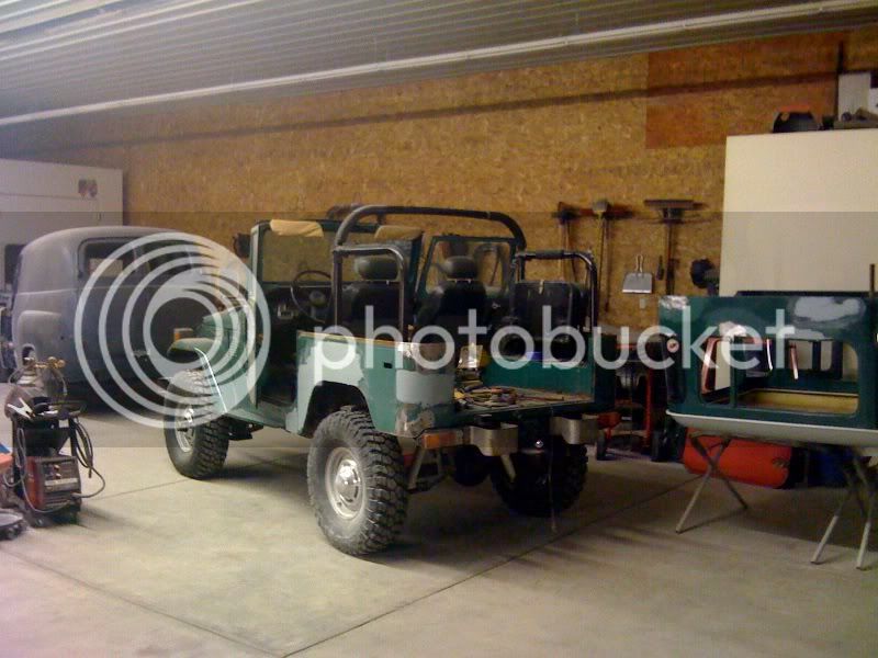

Here is more action on the cruiser.
What I have done:
1. Welded some cracks in the floor under the drivers seat.
2. Set timing (still need to lean out the carb a bit with the lean/drop method).
3. Starter is starting to poop out on me - so I purchased a new one (luckily they come WITH the solenoid).
4. Replaced radiator hoses (felt a tad spongy for me).
5. In getting the cruiser under the spot light - I decided at this point not to do a full disassemble and restore. I'd like to enjoy her a bit before that process starts.

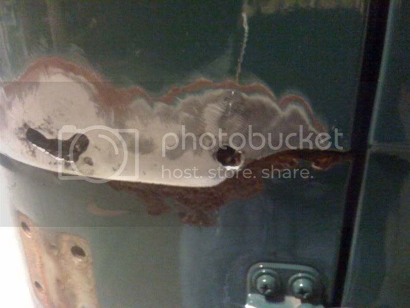

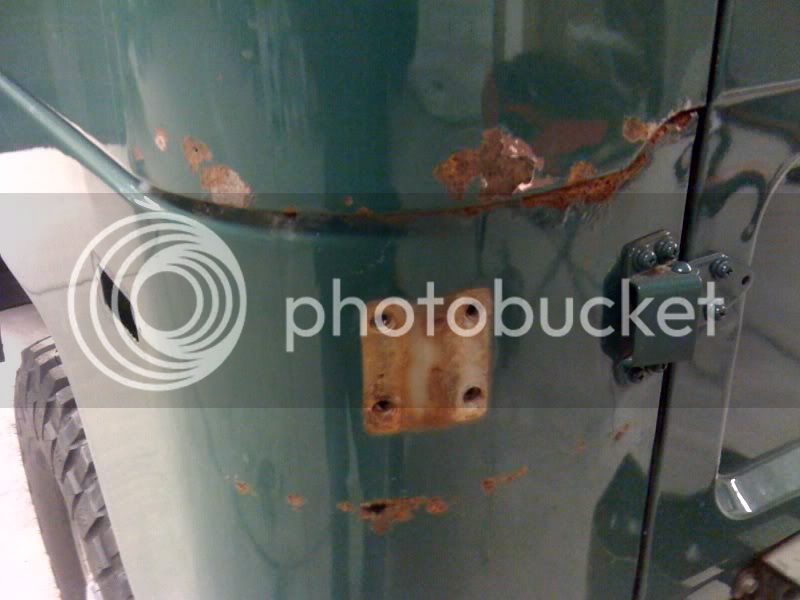

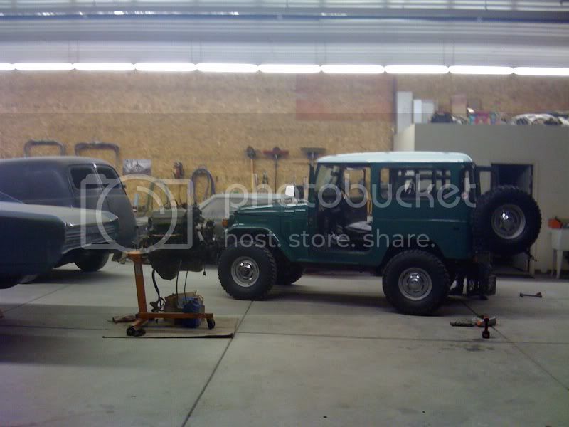

In doing so - here I pulled her into the shop to start investigation:

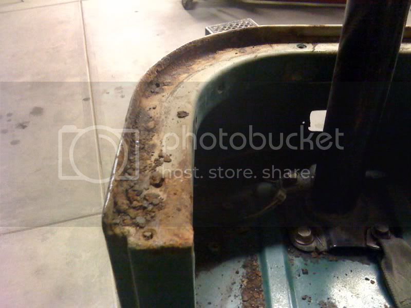

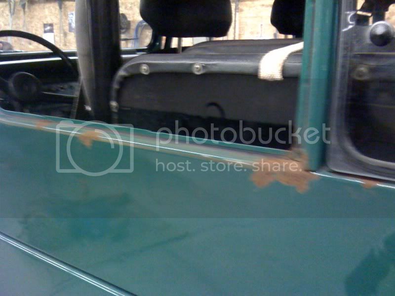

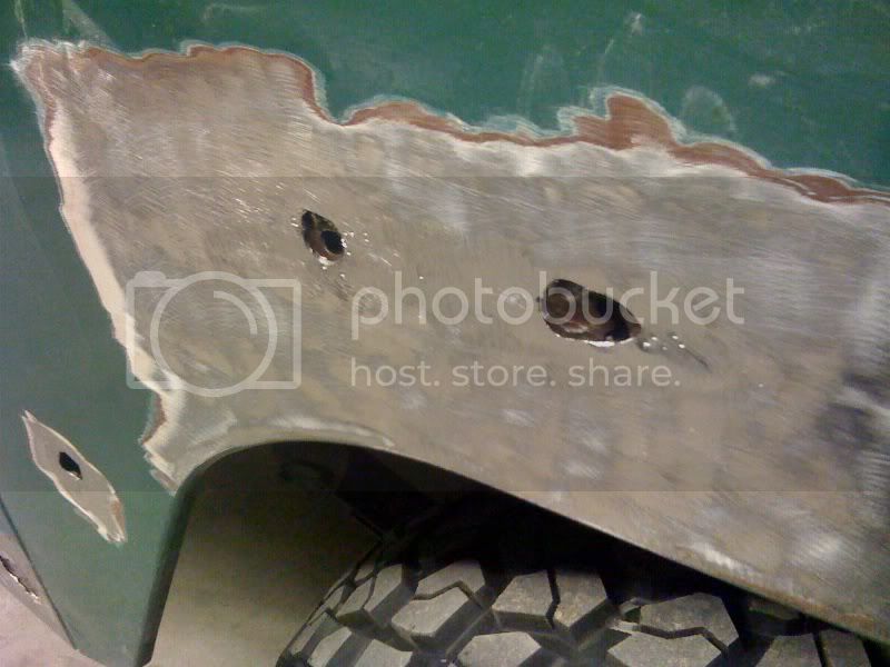

I noticed quite a bit of rust starting under the window rubber on the hard top - so I plucked out the window to have a look-see. Sure enough - it's a good thing I am catching it now:
I am just working my way around the cruiser - looking for all spots of cancer I can spot to fix and re-paint. It's not as bad as I anticipated - but you can never be too careful.

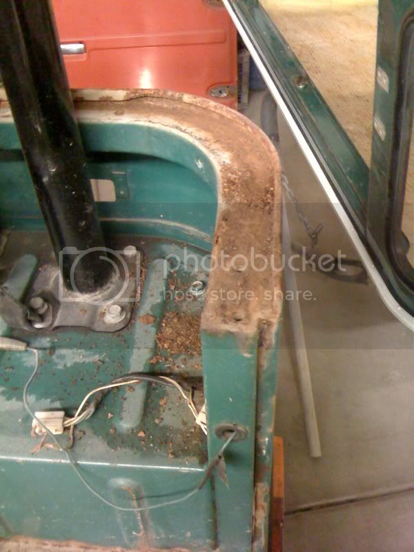

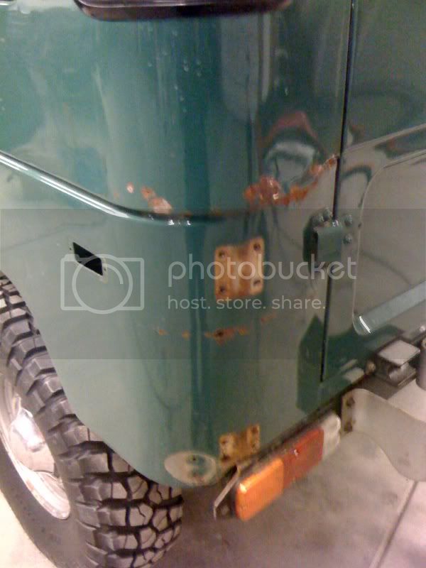

Removing the tire-carrier next:
Quite a bit under there - and it has even eaten through in a few areas:

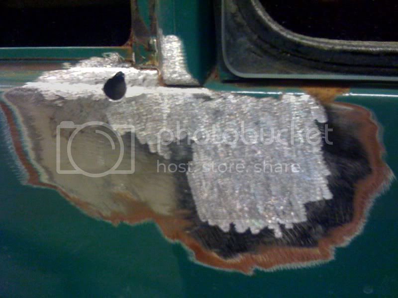

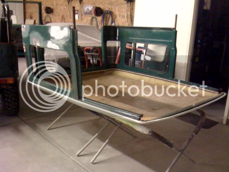

I gotta find it all! Cleaning and delving into more of the common areas - I decided to remove the top and dig into the channel....what a mess! Me VS. Rust
Who will win?

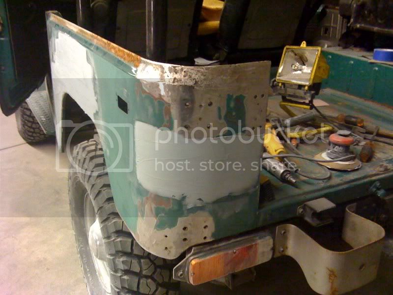

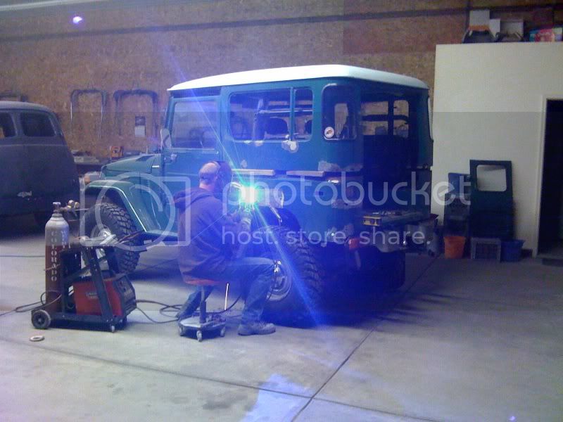

Welding patches! My buddy Clarence hard at it:
top off:

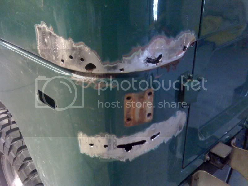

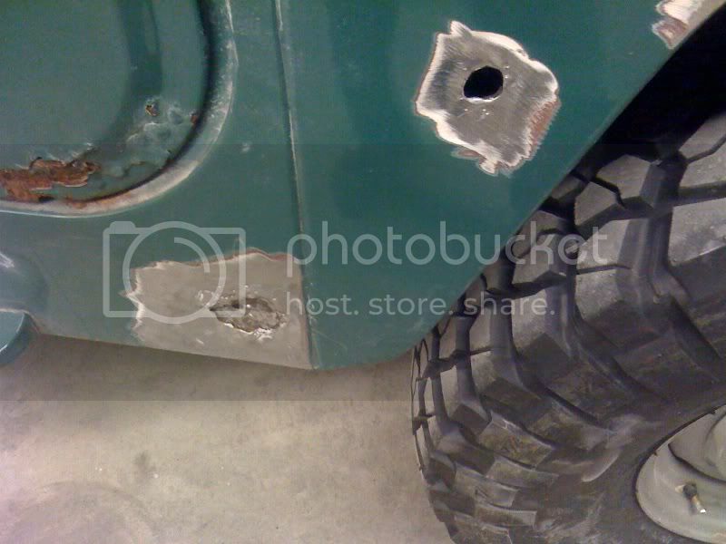

Look what was hiding underneath!
and left side:
Man...everytime I get back up - Rust nails me in the face again....
...the fight continues!
Also, this is not "bondo" I am using a product by EverCoat's "METALWORKS" called "Metal Glaze" it has a superior bond to "bondo" and lasts longer. It's also smoother and easier to mix and apply....I.e. you can't slop it on - it's too runny. It is pricey, but worth it.
