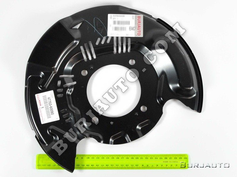

I haven't compared the 16+ splash shields, but intend to. If they have more venting I may replace these too.
Right: 47703-60100
Left: 47704-60100
Note that replacing these requires removing the front hub & bearing from the knuckle/CV.
16+ shields appear to have more venting.
Pre 16
Pre 16
Replacing the shields would be better from a fit and venting perspective.
That said, the existing shields work fine with a bit of massaging and will still support the majority of improved thermal and cooling capacity of the larger rotors.
The added labor is not insignificant, easily more than twice the effort. Perhaps if needing to R&R bearings or rusting shields, could make it worthwhile.
