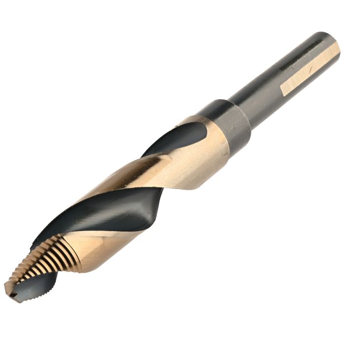

Another set of spindles drilled out. Using new brake lines and new calipers/pads/rotors. Took about 20 min per side to do the upgrade. I had the spindles on both sides ready for drilling and was able to drill out all 4 holes in less than 5 minutes. Once you get the feel for the speed and support needed to keep the drill from wanting to dive into the hole, it cuts smoothly and quickly. If anyone in central AR wants to drill out their spindles, let me know. Need to get more uses out of this $40 bit.
I used this bit. Not sure why i chose this one over any of the others listed here. But it worked great.
KnKut 9/16 Fractional Step Point 1/2" Reduced Shank Drill Bit - KK12SP-9/16
Nicely done. That bit looks like it wants to eat!

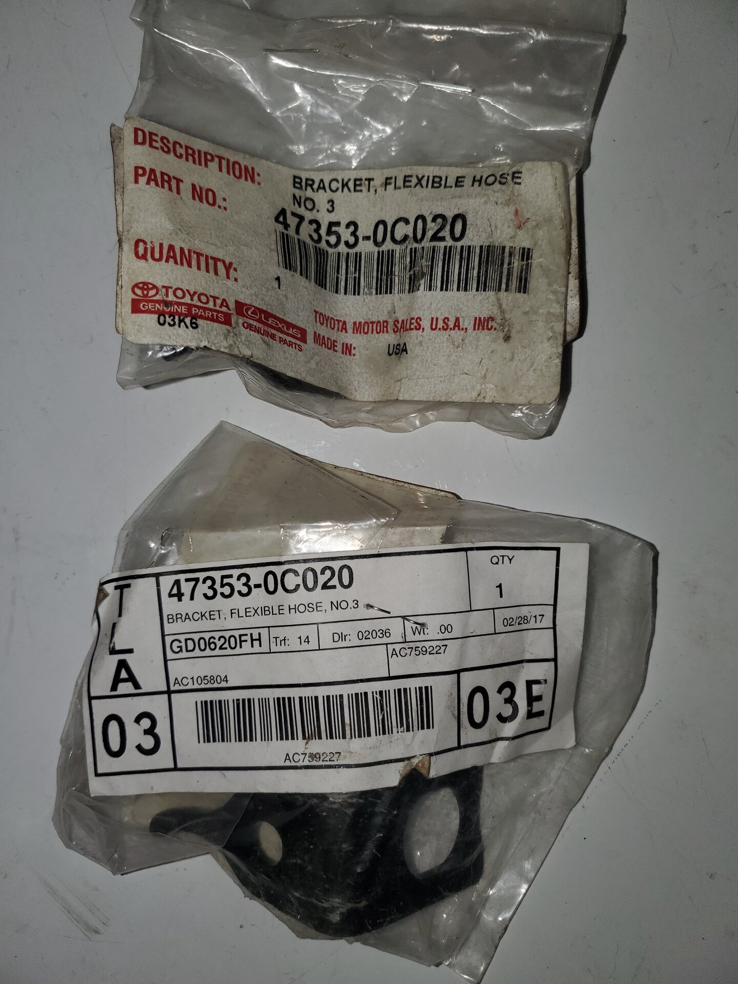

You use existing brackets from flex to the body hard line.
You do need the Tundra brackets for the caliper hardline to the flex lines.

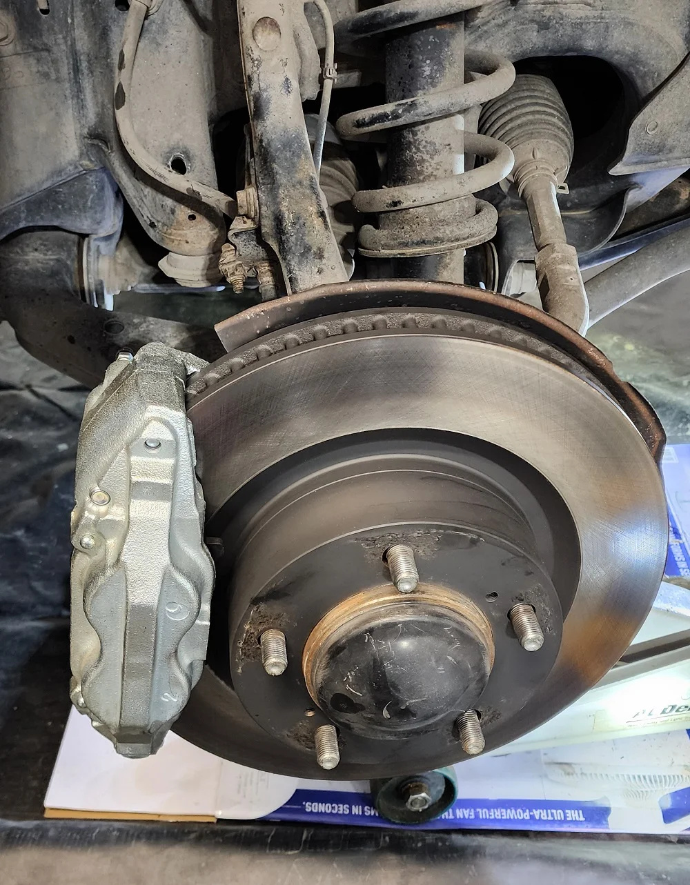

Completed this upgrade this weekend using a 2016+ Tundra kit from PowerStop I ordered on Amazon. My son wanted the "fast" red calipers and the cost difference between these and remans was negligible so who was I to argue. I've used this brand a number of times before so I trusted the quality.
Decide to go the larger hardware route and drilled out the mounting ears on my knuckle to accept the larger 14mm bolts for the 16+ models. Here's my parts list. All from the jungle website.

This is the bit I used to open up the hole in the mounting ear:
This vehicle is my wife's daily. The brakes needed to be done and she's complained about moments where the brakes just not feeling sufficient. I'll try and remember to report back after some time with a longer term verdict. So far, it seems like a worth while upgrade for sure given it's a pretty straightforward process.
