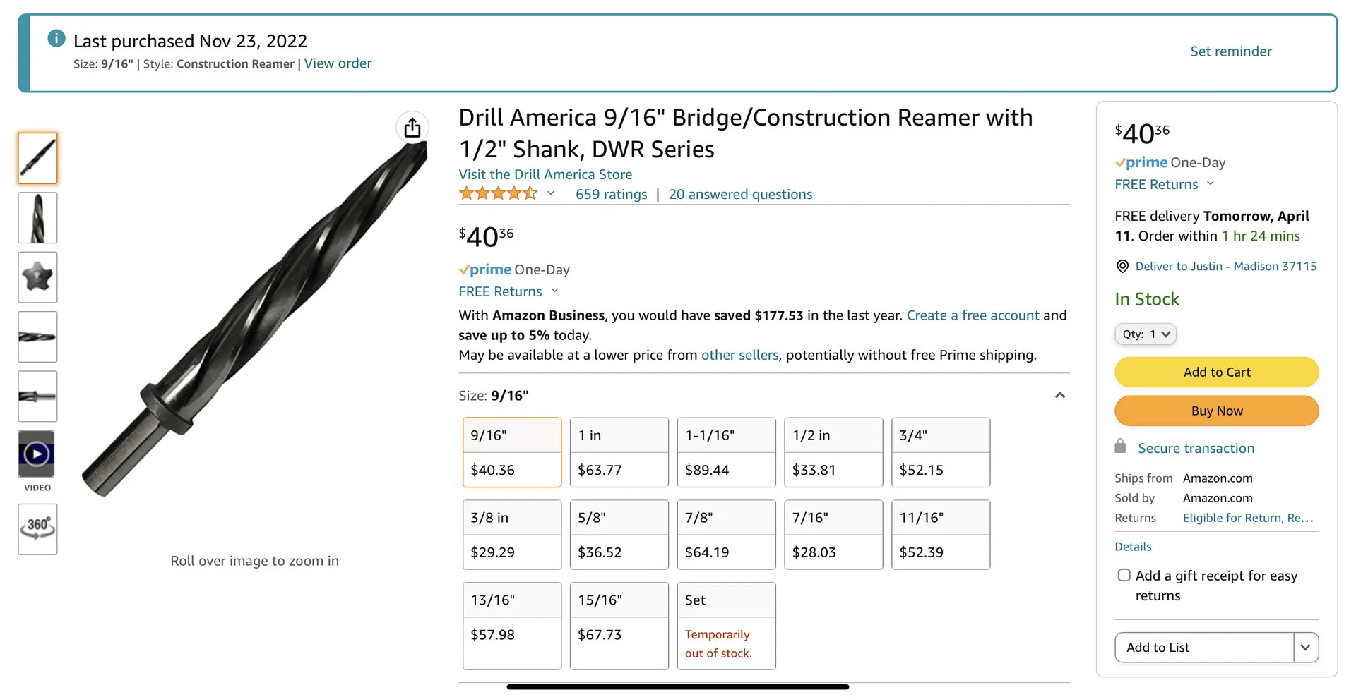

Yes, it has been discussed. Just get the 9/16” Drill America construction reamer bit off Amazon (easy to find). And some Tap Magic. Your calipers have larger mounting bolts, and you’re going to need this bit to ream the holes on the spindles out to the correct size. My ‘09 LX has 2017 Tundra calipers up front. It stops so much better.

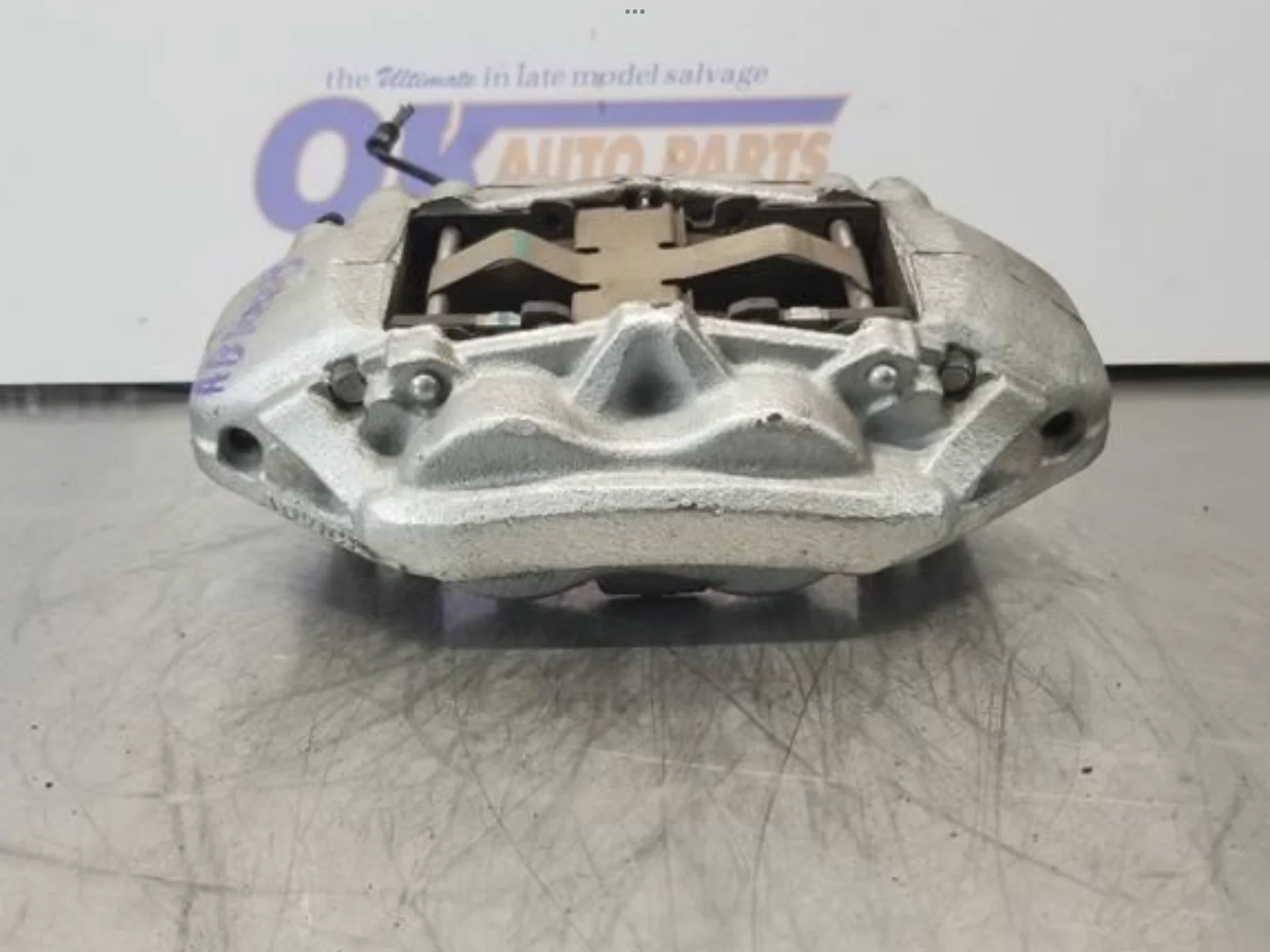

The 2022 Tundra, and possibly LX600, calipers have an improved design with heavier ribbing and pad retention. Hopefully they keep the same bolt spacing and ear offset.

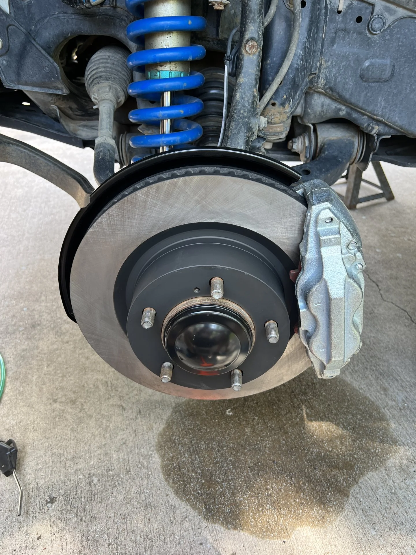

Got the other side done today, no issues. The brakes feel great, even with already used pads and not being bedded in yet. The initial grab/bite is better.. basically it's easy to tell they simply have more leverage over the wheel/tire to haul down the speed of the vehicle.

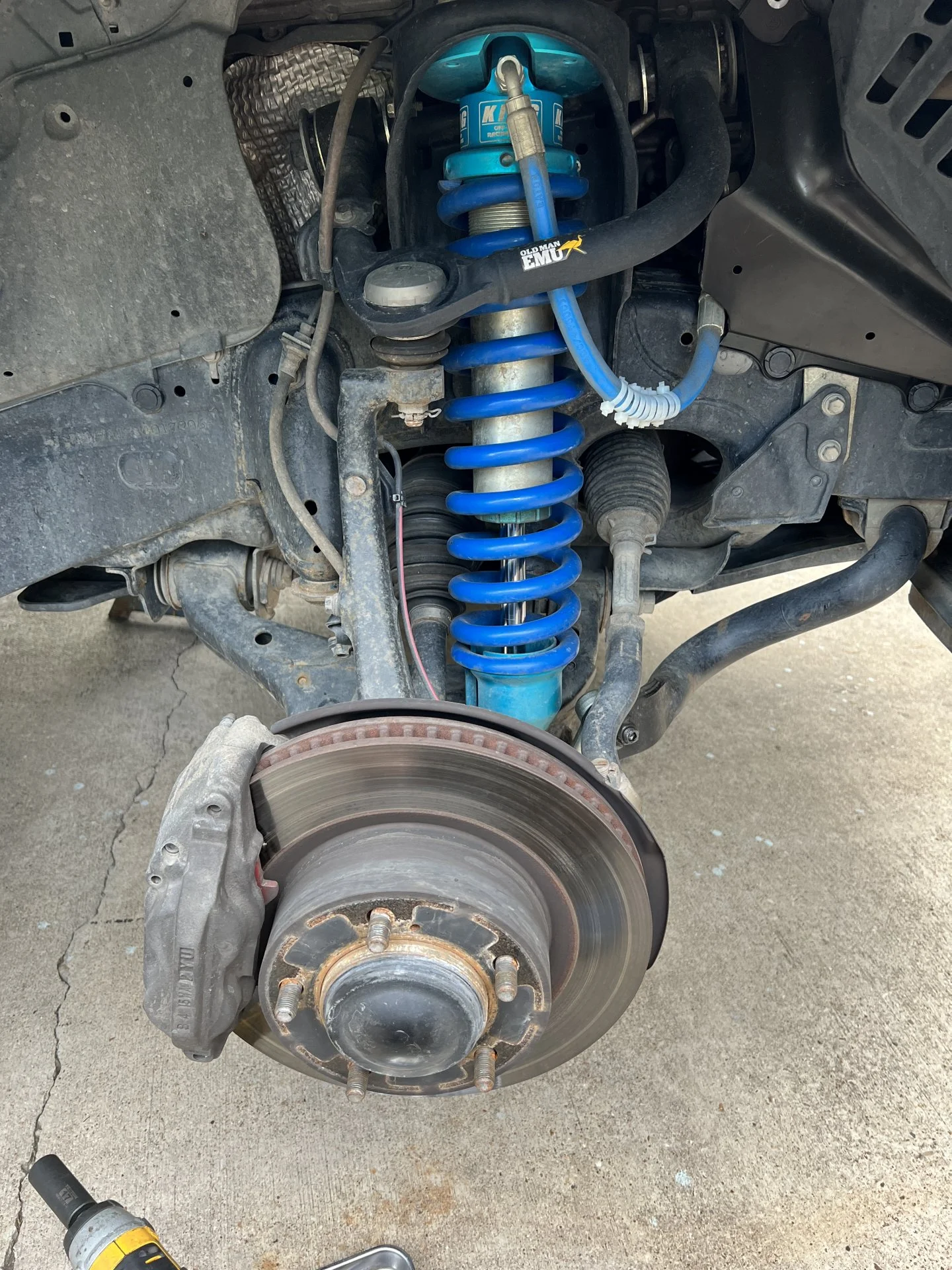

Before:
After:

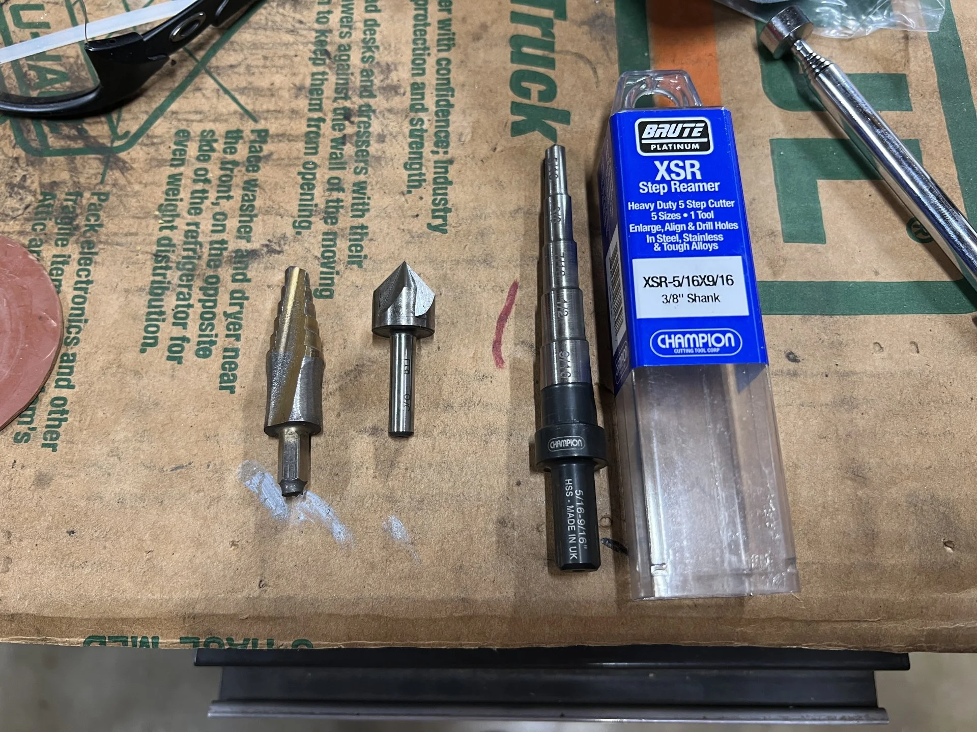

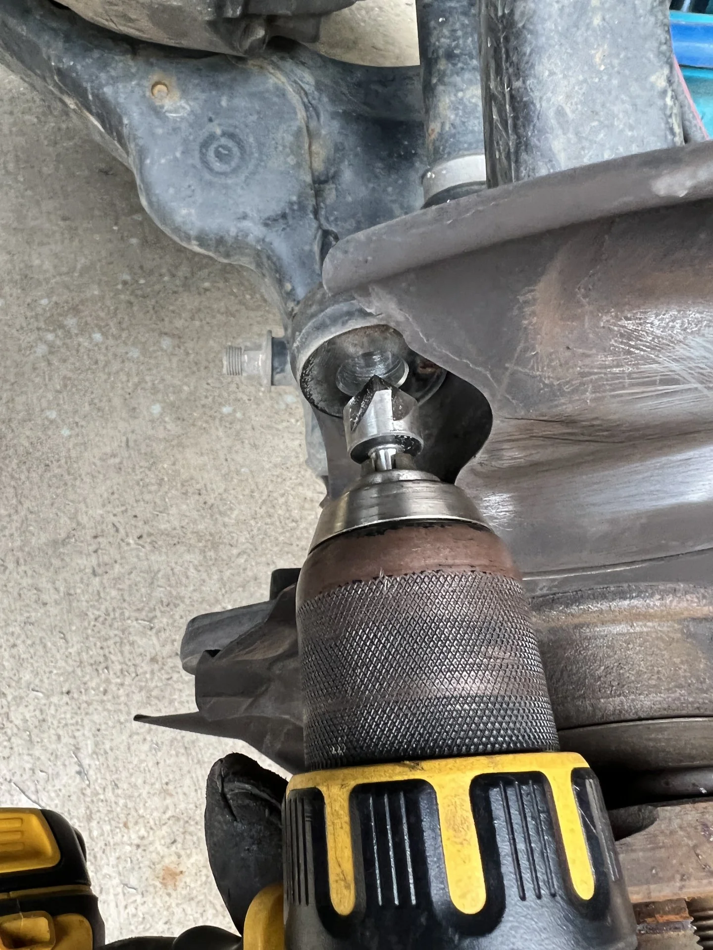

The various bits I used.
Teckis' modified step bit.
Bosch C2S2 5/8" countersink tool, about $11 on amazon.
Champion XSR "brute" step reamer. I paid about $60 for this online.
The reason the cheap bit must be modified is we need the largest diameter to be 9/16", and these aren't readily available. Teckis is really clever and he chucked it up in a drill then spun it over a bench grinder to take off the larger diameter, and you have a cheap 9/16" step bit. This would work fine for most people if they have the tools to grind one down.
The countersink tool is used to debur and chamfer the holes after enlarging. Factory has a small chamfer around the holes, and it is good practice in through-holes like this.
The Champion bit is arguably overkill, but basically a more robust tool for this job. The longer steps do a marginally better job of stabilizing the bit (assuming you can put both hands on the drill), and a tool like this will most likely be made of better steel. Thing is, the knuckle isn't particularly hard metal, and most of this stuff will be used for exactly 4 holes for most people, so I don't see the cheap bit wearing out. But, no modifications, just chuck it up and go.

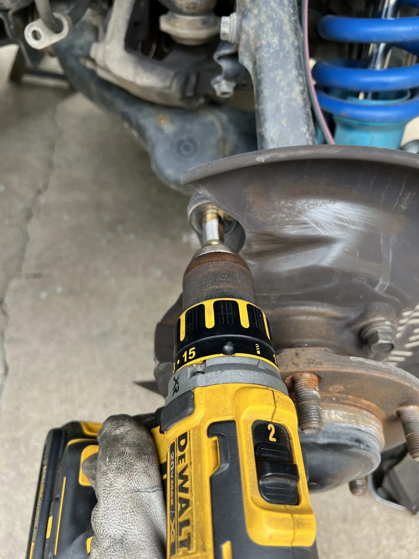

I used these in a standard dewalt 20v cordless drill. I often use the faster speed 2 for this type of job, and simply throttle the speed way down. I find that with less gear reduction if the bit grabs there is less inertia in the motor to dissipate into my wrists. These brushless drills are particularly good at stuff like this, and mine had zero issues.
Really.. each hole was less than a minute, if I could have both hands on the drill. You'll want to pay attention to keep the bit mostly straight, it is totally possible to get it crooked. I found looking around the back I was able to see the back of the hole that was larger than the protruding bit, and keep it straight by making the gap around the bit even.
For the two holes today I played with using a cutting lube, with no discernible benefit. I could see a situation where it could buy some buffer space for someone that isn't as experienced working metal and has more trouble walking the line of speed/pressure to keep the drill cutting correctly.. but for most it won't be important.

Chamfering the holes after drilling. To get access to the back you'll need to turn the steering, or if you have one (I did) use a right-angle drill adapter.
The following clip is using teckis bit. Drilling one-handed made the tool much more shaky.. when I got rid of the phone things were nice and stable with good healthy chip production. Excuse the fan noises.. it has to be within 3 feet of me to keep the clouds of mosquitoes away.
This clip is drilling with the specialty bit. Less stable with one hand, but more stable with two. I actually ended up with this hole a bit crooked at half-way due to being distracted with the camera, but was able to rescue it before finishing.

*$40 + free 1-day prime delivery for the 9/16” reamer bit I used.
I tried the step bit method, and two of them wore out on me. I ruined those and three carbide-tipped 9/16” bits from HD getting one hole reamed out. This reamer bit literally reamed each of the three remaining mounting holes in >1 minute with Tap magic cutting oil.

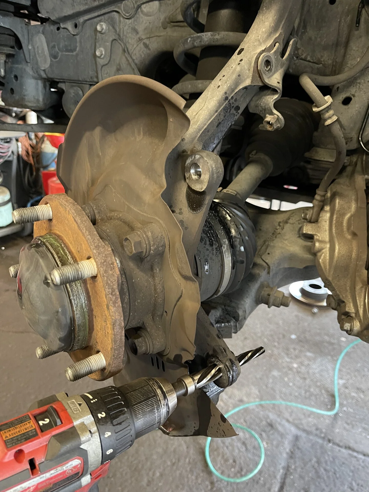

I did the tundra brakes today, I had a set of oem 2018 Tundra parts so I had to drill out the ears. I used. 9/16 reamer. I can see why some of you have trouble using that bit if you’re not familiar with drilling. It’s a combination of force and finesse as well as having a powerful drill to not get jammed up. I didn’t have cutting oil so I used power steering fluid and it worked lol. Each hole took maybe 45 seconds using constant pressure and drill speed.
This is the only pic I took because it was late in the day and my wife is hungry at home and wants to go get hot pot. Check out that rust free front end hehe
Now for the review, it feels good! Bites hard and gives me more confidence doing hard stops. I have 33” E tires and had no issue stopping them now. Definitely worth the time and money, thanks to all who provided information and parts number to make this an easy job.
The original dust shield will work, just bend it away from the rotor where it’s scraping and it’ll be okay. Also make sure you ream those holes straight, if it’s crooked you might cross thread your caliper esp if you use an impact gun. Total I have in this is $350 and about an hour of labor. I’m a mechanic with a lift so it’s quicker

What brand reamer did you use? The one I had was not effective at all.
i used the Champion reamer, along with a milwaukee fuel drill. Steady hands and firm pressure i was able to cut through the hole pretty easily. Trick is to find the correct pressure and speed as not to warp the drill but enough to cut into the metal. Whatever toyota used on those knuckle, the metal is hard as hell.
