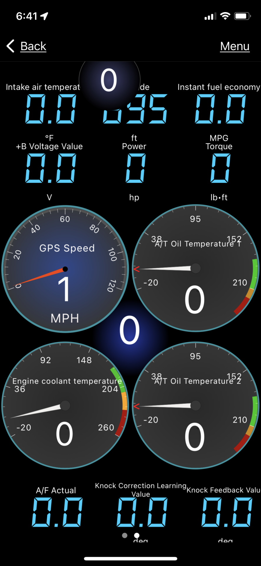

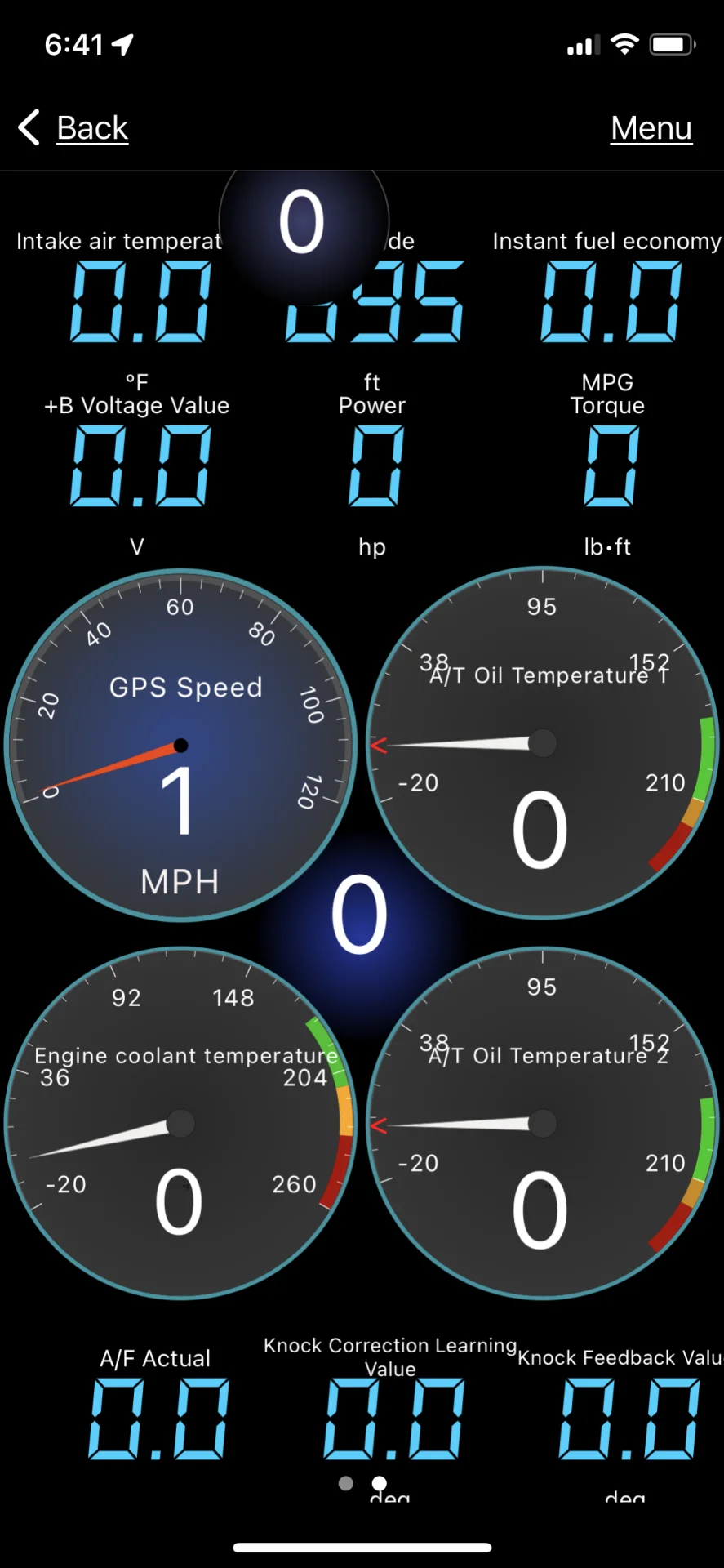

Your V2 did have a random gauge floating up top on my iphone 11 pro , standard display (not zoomed) that i screenshotted.
Anyone else on iOS seen this?

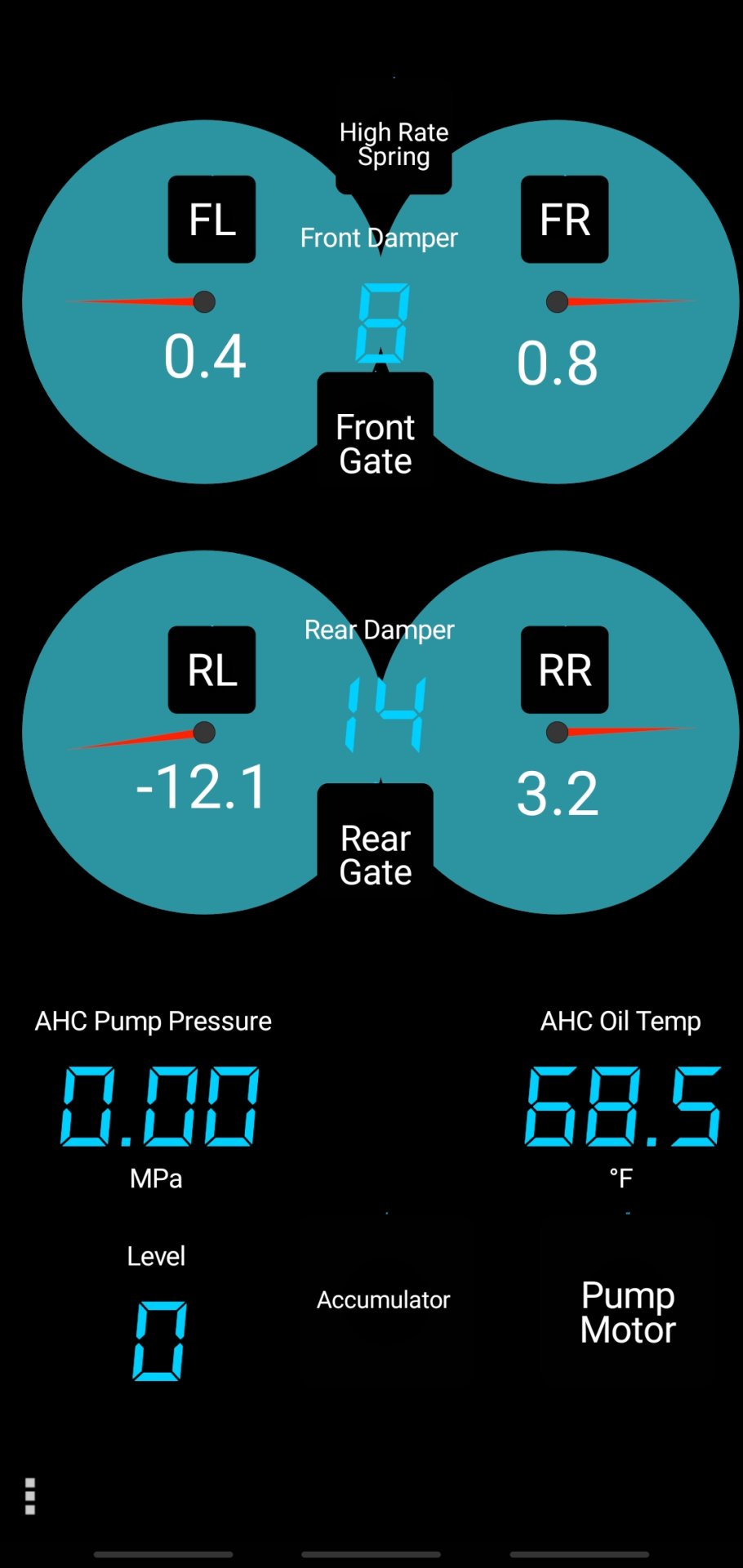

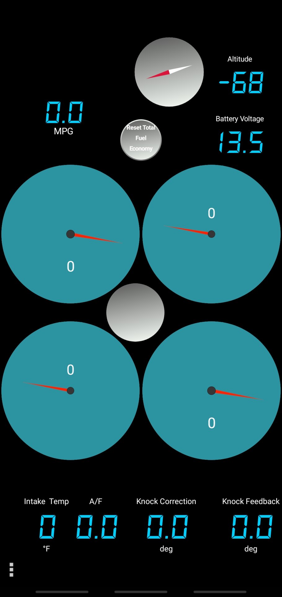

So my first link in currently post 48 has the OBD module dashboard (in my files I now call that "trip") and that one has my new edited "Trip" dashboard and probably a messed up version of Teck's dashboard, the one you pictured.
I now have them separated on my google drive so ill provide two cleaner links here.
Trip Dashboard
AHC Dashboard
If you downloaded both my previous two files, you should have ended up with 3 dashboards total. A borked up Teck dashboard, and then my Trip and AHC dashboards.

Nothing earthshaking here. The unlabeled gauge in the bottom right is run time since start.

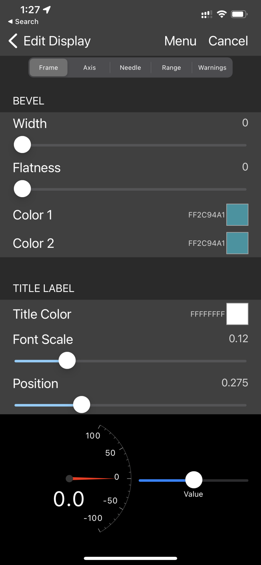

It would be nice if OBD Fusion had a little more flexibility, things like:
Building displays (and warnings) based on multiple PIDs.
Allowing custom icons and dashboard backgrounds. (it would be cool if you could overlay a small jpg with 4 displays, or one display with 4 PIDs).
Buttons/Indicators built in rather than having to be faked out of other displays
