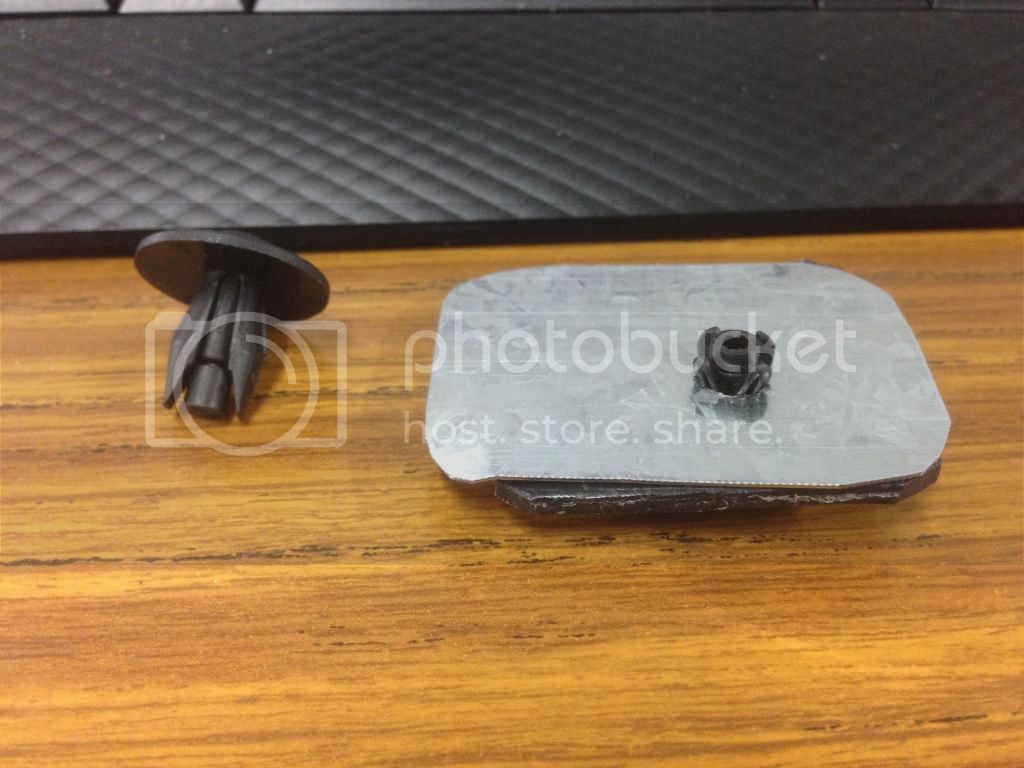

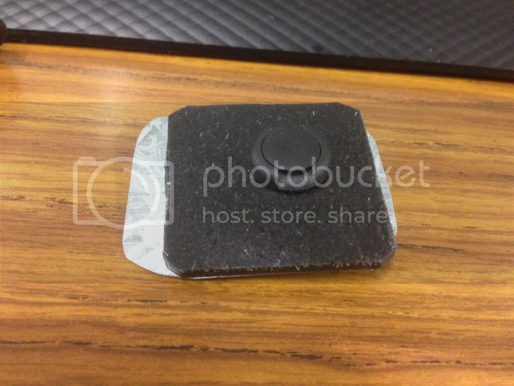

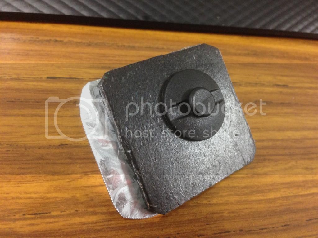

I prefer to reuse the existing mounting holes and use these plastic clips. They hold very secure and don't snap or pull out like the stock ones.
