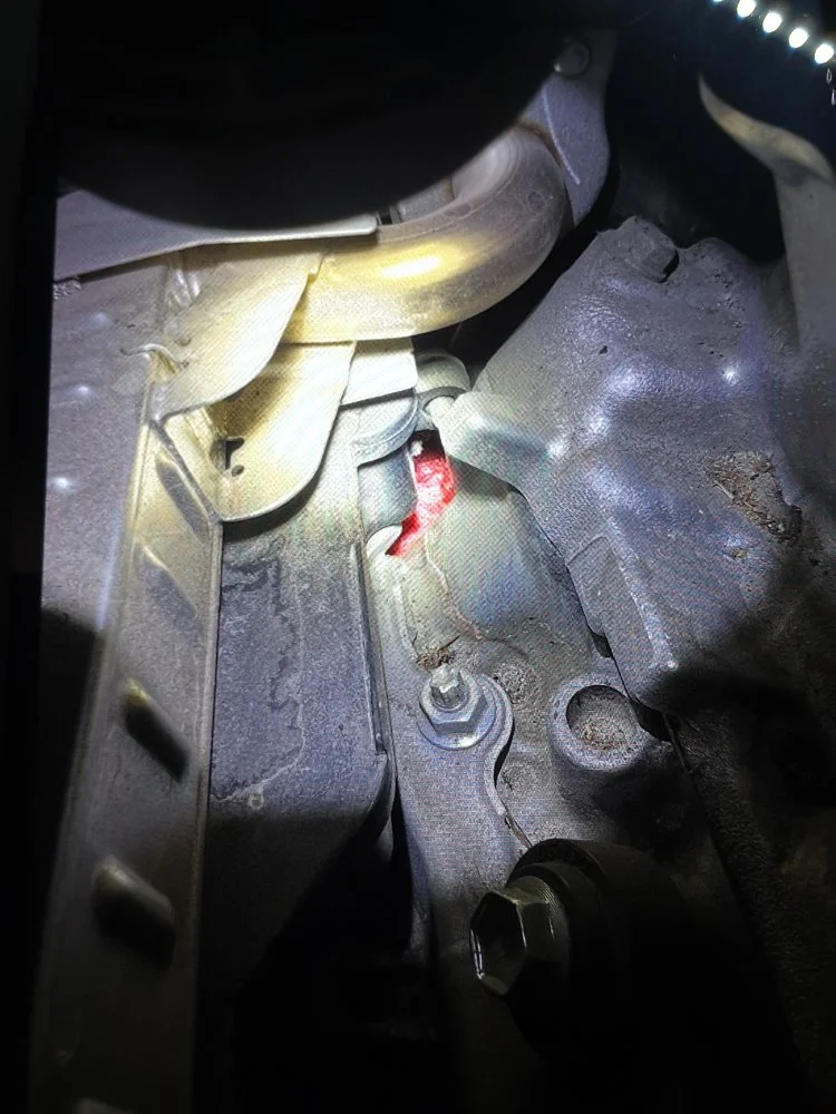

Yay, my turn. 2013 GX with ~147K. Just noticed a slight pink droplet on the transmission bell housing then followed it up with a flashlight and can see pink drippings....I started to read about it before I saw it wondering when my time is coming. Like I wished it upon myself :(. no noticable drop in coolant from the resevoir yet, so it's small/early from what I can tell.
I am not brave or talented enough to do this myself. Called the local Lexus dealership (Sheehy Richmond) and they want $2275 which seems high based on just about everyone else on the forum's input. I've got a call in to two of the local Toyota dealerships, but no response yet (Haley and Ourisman).
Anyone in the area (just west of Richmond) have this done by anyone they'd recommend? And...
while they are doing it, with 147K, what else should I have done/replaced? Bought at 70K and it had all the recommended service done on it prior and I've done the other stuff outside of oil changes (coolant flush/fill, trans/diff chnage, plugs, etc).

I'd have them check the timing cover, cam towers, and valve covers for oil leaks. It's most likely seeping somewhere. If you haven't replaced the radiator and water pump, I'd do those too. At 147k, she's overdue for these things.
Thanks! I've gotten quotes from Toyota and Lexus, both are ~$2200 for just the valley plate (no water pump, etc).

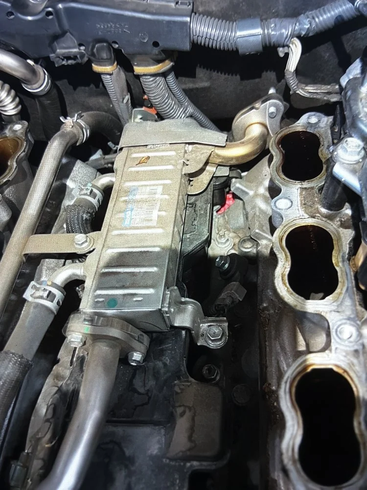

Just finished doing the valley plate leak repair myself over the weekend. It was a bit intimidating at times, but overall not too bad. Now that I’ve done it once, I could probably do it again in about two-thirds the time.
I used a ton of O-ring lubricant, and the tube popped right in. It was so well-lubricated that it would spin freely, which made me pretty confident the O-ring didn’t get pinched. I'm not sure if you can actually use too much lube but it seems good so far. I ended up using some lube to get a few coolant hoses together too.
That said, I did notice something odd after reassembly—my idle now jumps around a bit. I think with the A/C running, the idle jumps to around 700 RPM, but then it will drop down to 400–500 RPM. Is that normal? I honestly don’t know if it always behaved that way or if I’m just more aware now, looking for anything unusual after the repair.

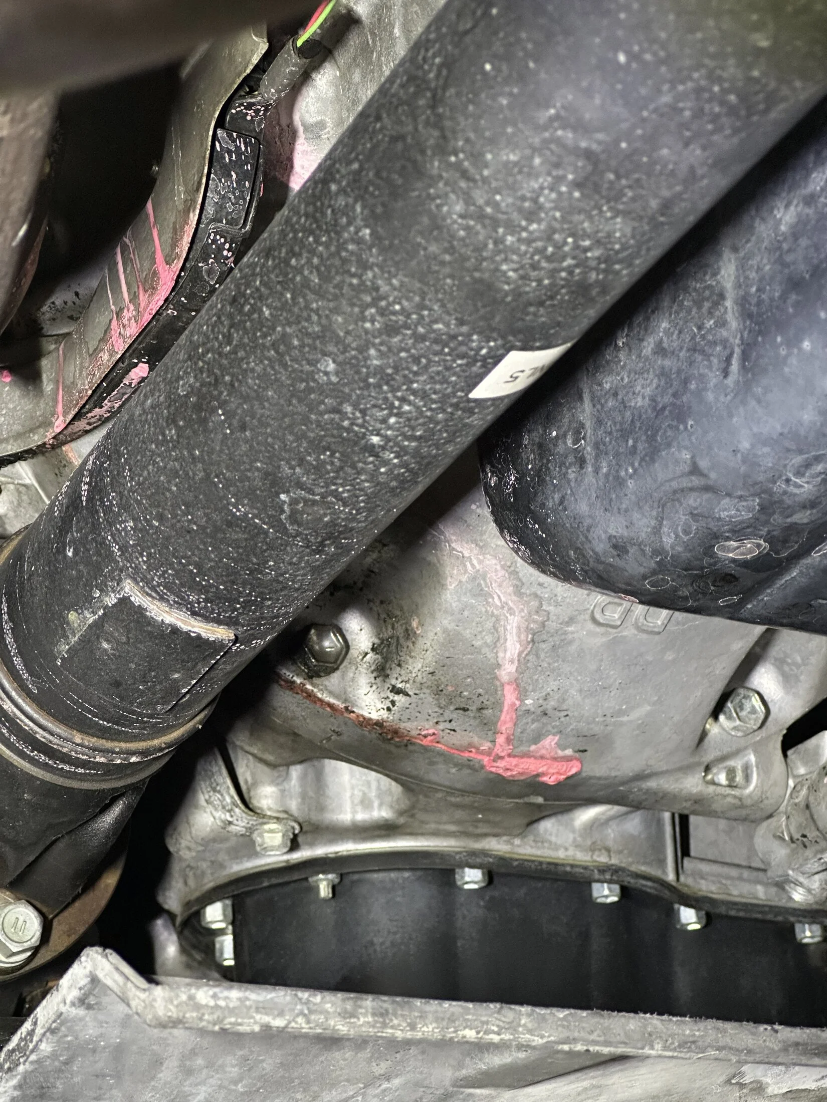

If I had one more tip for anyone tackling this, it’d be to thoroughly clean off any old coolant stains from the bell housing and around the transmission area. I was changing my oil recently and noticed a bunch of staining down there—still not sure if it was leftover from before or if I might have a new leak starting.
I also noticed my coolant was a bit low, but I’m not sure if that’s just the system finishing the bleed process. I've since cleaned everything up and plan to check under the vehicle again after a few days of driving. Definitely not a great feeling when you first spot those stains.

Just read through this entire thread including the lessons learned. Print it and keep with you. When you get the CVP off, before you put the gasket on lube the oring and practice. See what motions start to roll that ring. Then once you get good at it, do a thin gasket and go with it. It’s not terrible honestly. Just bolts and everything trains back pretty well to the spot. BUT take pictures in case something gets confusing on the put-back. It’s a good opportunity to clean out your EGR tubes and valve. Also PCV. Be VERY careful with the Knock sensors and go back in the same order (just to be safe)
