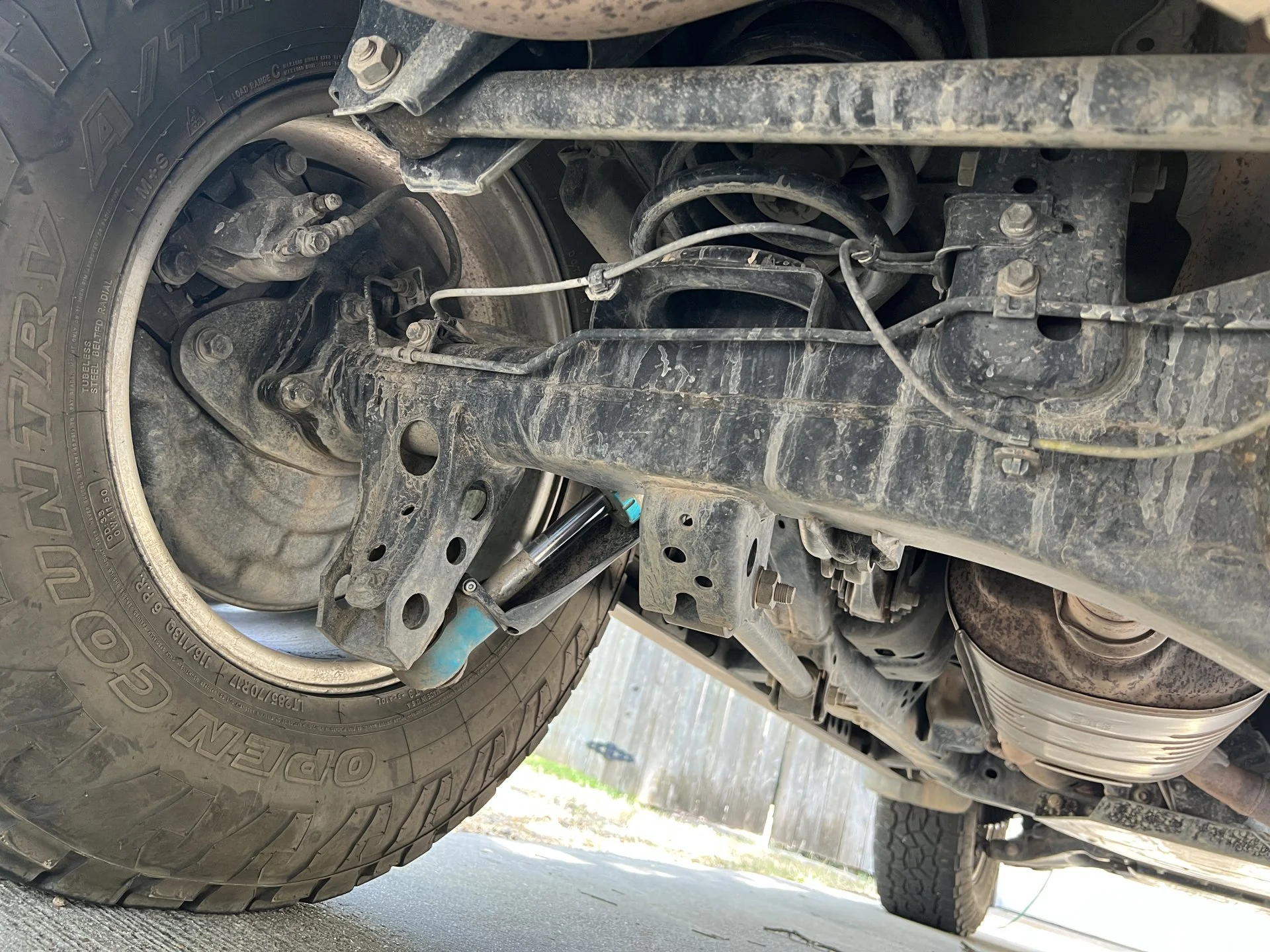

US KDSS cruiser axle. Has the passenger side mounting holes, though if the rig has rust there may not be solid threads left in there.

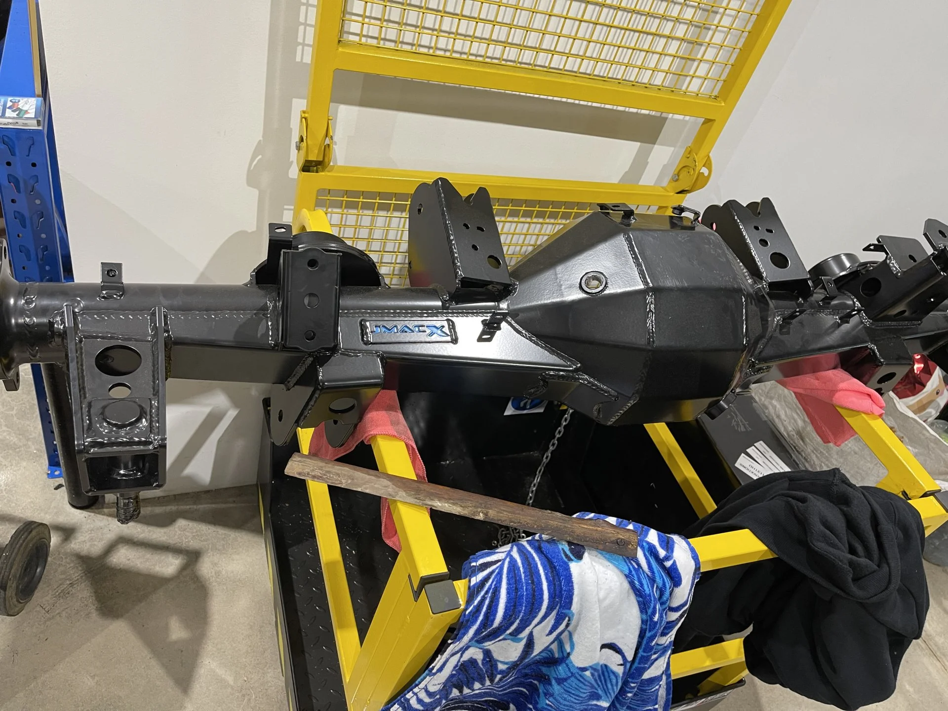

If you wanna pay the freight i can sent a whole non KDSS housing (we upgrade them a lot down under)
These Jmacx diff housing are rated to 3000kg and come with both KDSS and non KDSS brackets.
I mean, if your offering it just for the price of the freight that seems like a deal! :rofl:

I soooo want one of these. I’m about 1200# over rear axle weight…
