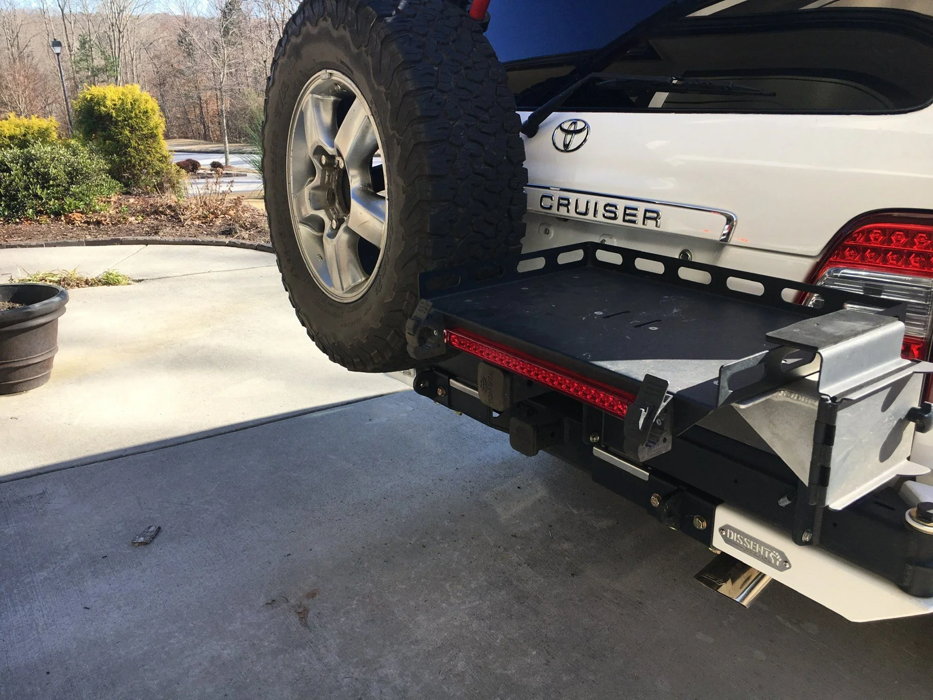

For the exhaust, I had the rear resonator (looks like the muffler) removed and replaced it with a straight pipe. The end of the pipe is cut on an angle to be flush with the bumper for maximum clearance. I can't really tell much of a difference in sound with the resonator removed. I still have exhaust flow from the stock location, but now without a dented tailpipe (didn't take long to do that after putting the spare on the rear bumper). It cost $80 total at a local muffler shop. Here's a pic of the finished product.

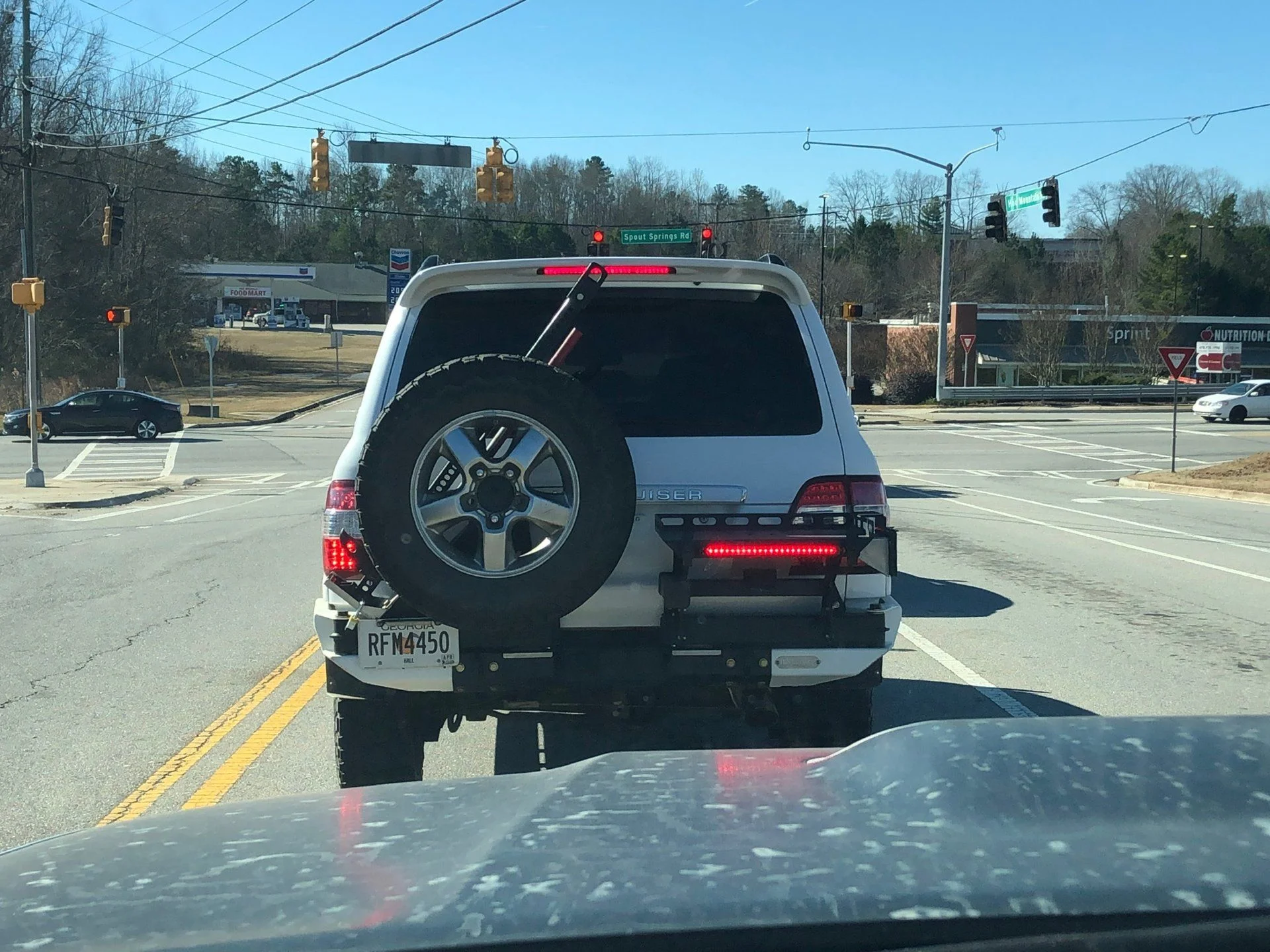

How are owners of this bumper feeling about the reverse lights and most of the taillights appearing to be blocked. I can't tell if that's a safety/legal issue. Really want this bumper, for now I'll just wait for my front.

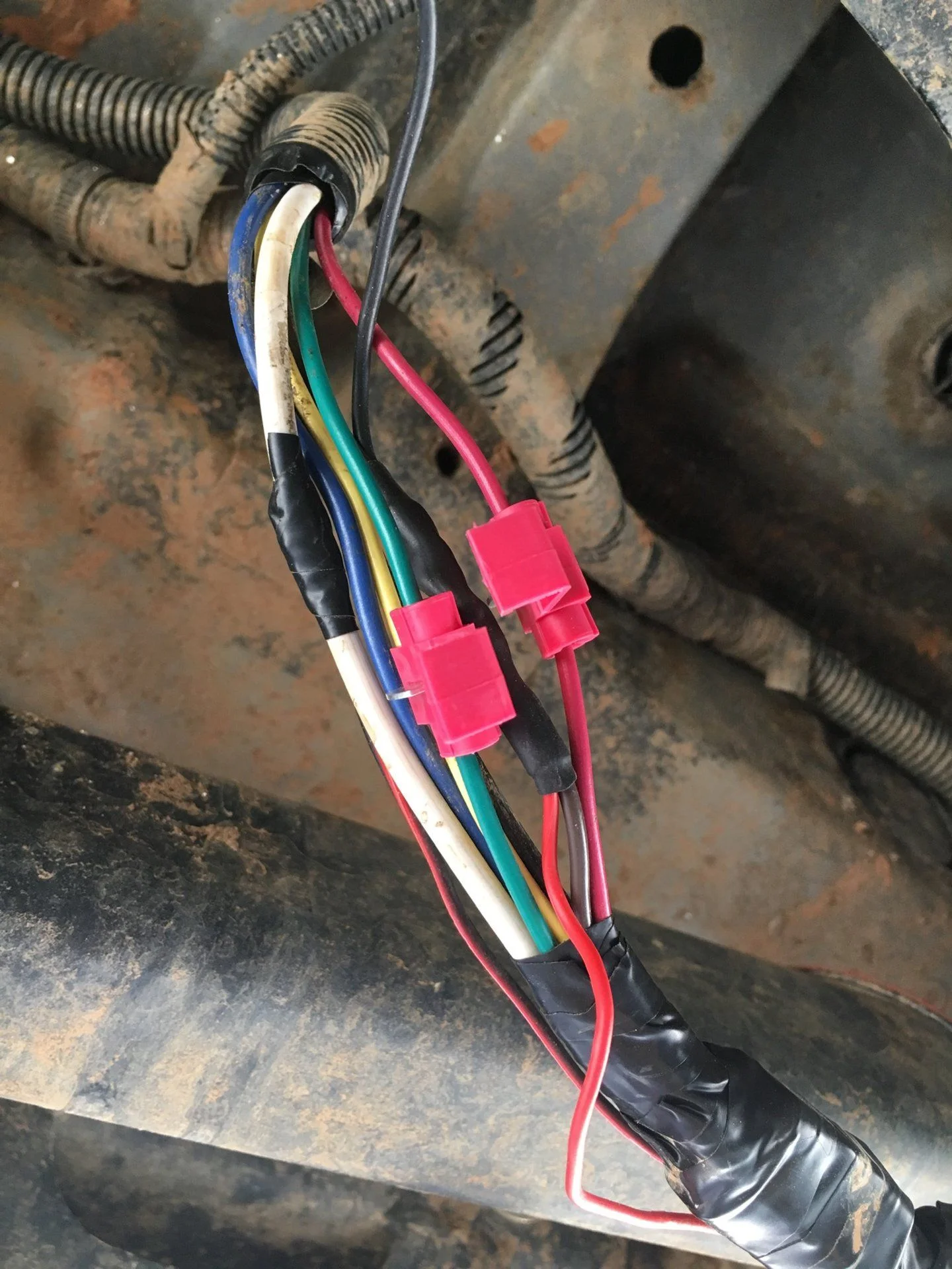

I became concerned when I saw the view from behind so I added a third brake light that's wired to blink on turn signals and brighten on braking. Ben actually recommended last April after installing my bumper since I have a chainsaw holder covering the side marker. If you don't have the additional tray I'd say it's fine, but you need to decide since you own safety of your vehicle.
I like the third brake light idea. Curious if someone did something similar for more visible reverse lights.
Nice idea with putting a strip light in that spot. I thought the same thing and put one of these in the hitch.

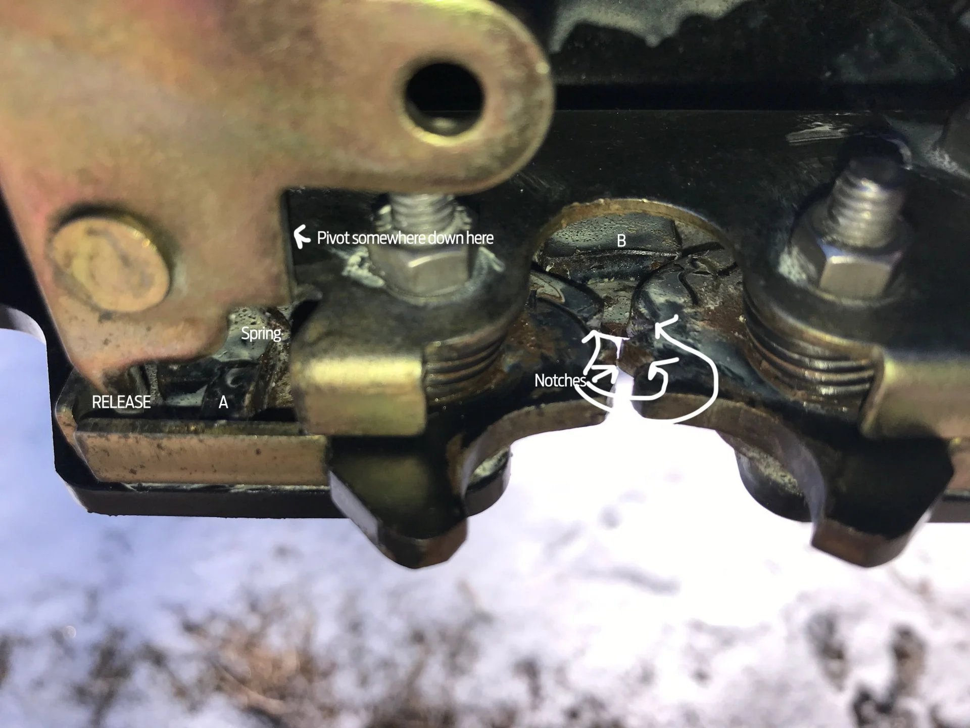

I've had my bumper for almost two years now, A couple months ago I started to have a little difficulty getting the swing out latch to catch reliably and today it refuses to latch at all. Anyone having/have a similar issue? As best I can tell, examining the catch, is that the lock has a spring on it that should drive it into the "claws" when they are wraped around the pin. Each claw has two notches, resulting in the two stage click. I can manually pressure the catch into the notches, but it doesn't go on its own. I can take pics later today to illustrate what is happening but just wanted to see if there was a known solution.

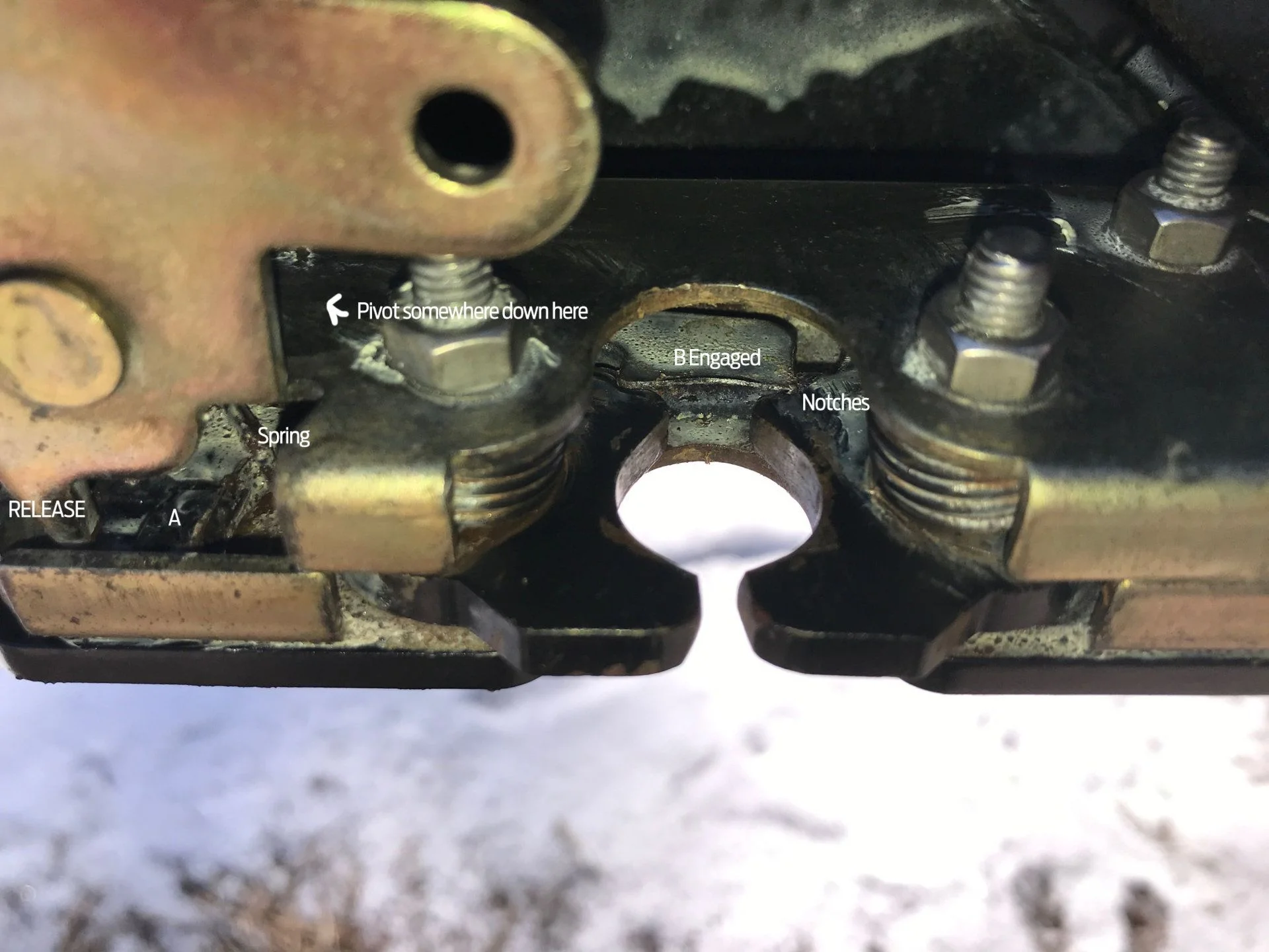

I went home for lunch and really took a look at it. Here are two pictures showing it in open and closed. This is my first time really analyzing a latch like this so it may be "no duh" for some of you.
This is before I cleaned the crap out of it. You can see how the mechanism works, there is an "L" shaped lever on a pivot with a spring that tensions it into "Locked" mode. When the claws close the B portion of the lever should be pushed into the notches by a spring. When you open the release, it presses against the "A" portion of the lever and the spring on the claw pop them open. Easy peasy. As part of my standard routine I've been spraying the mechanism with lithium lube. That's all the white gunk you see.

At first, if I pinched the claws closed the latch "B" would just sit there, no pressure into the notches. So, I tried to work the mechanism by hand and it wasn't frozen in place (ice/rust/corrosion, etc.) I could use a drift and with just my hand push on "A" to manually engage "B" while I pinched the claws closed. So it wasn't stuck. I started to clean it up to get a better look at what was going on and between that and the repeated lock/unlock cycles it seems to have started working again.
What's my takeaway? I keep my truck pretty clean, but other than spraying this lock with the lube every 5k miles or so I haven't given it any other attention. So I guess I need to keep an eye on those springs and levers to make sure they don't get gunked up with dirt. Also, no more lithium lube, I need to find something that collects less dirt and dust I think. Any suggestions on a dry lube?
