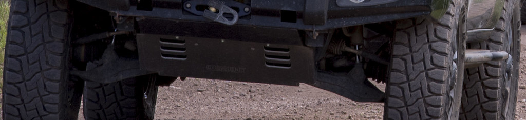

Dissent aluminum skid plate with ARB Deluxe Bumper. No gap.... I promise.

Trying to install these skids on a 2006 LX with ARB deluxe bumper and am running in to clearance issues on the front skid:
I'm able to fasten the rear-most bolts and the recessed middle bolt, but the gap gets progressively larger towards the front of the vehicle. Tried shifting the plate front to back, but it didn't have much of any effect. The front-most, side mounting point on the skid looks to be contacting the rear portion of the ARB bumper "box" where the front recovery points would be mounted.
Were the skids re-designed at some point?
Seems the only options now are to notch the skid and/or bumper bracket (neither option is super appealing) or pony up for a proper, Dissent front bumper.
Thanks for any tips/suggestions on how to proceed.

Dissent support got back confirming I'd need to notch the skid in order to clear the ARB bumper.
Decided to add some spacers up front as a stop-gap solution, until I commit to either retrofit the skid or replace the bumper.
