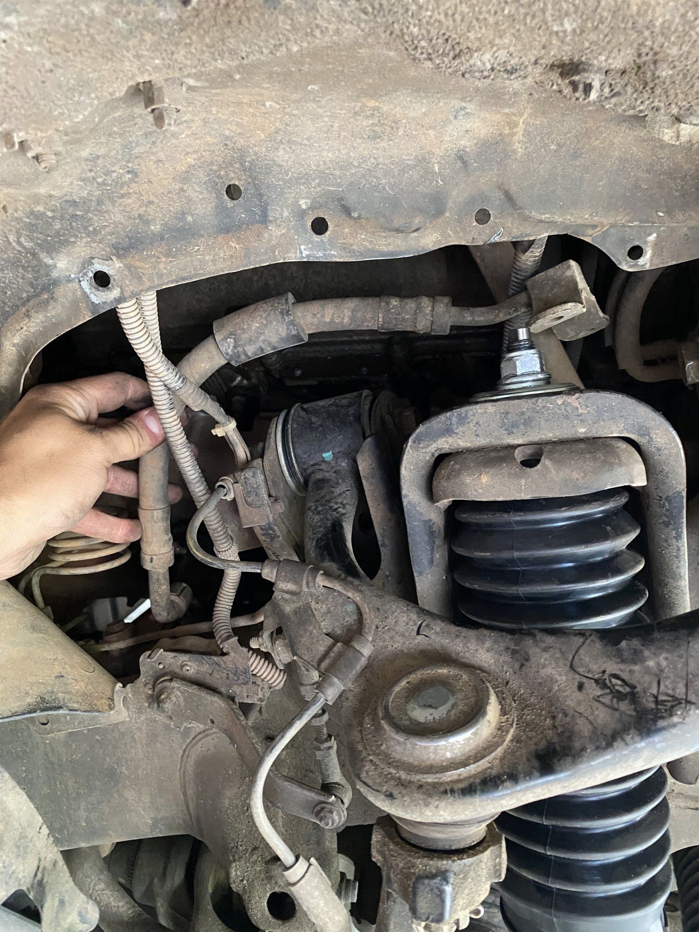

Disconnected part found while swapping shocks. Help me identify it?
Aug 1, 2019
14
56
91311
Hey there,
As my title says, I was swapping/upgrading my front shocks when I found what looks like some sort of disconnected tubing. Just looking to identify what exactly it is and if I need to fix it. I'll attach photos of how I found it and a slightly clearer view.
Cheers,
Logan
Looks to be the AHC line, must have been converted to conventional suspension at some point...
^^^^^ This
AHC line. Height sensors are still in place as well. I would imagine your globes are still on the frame rails.
Spend an afternoon removing all this AHC stuff ... and, have fun 😏
