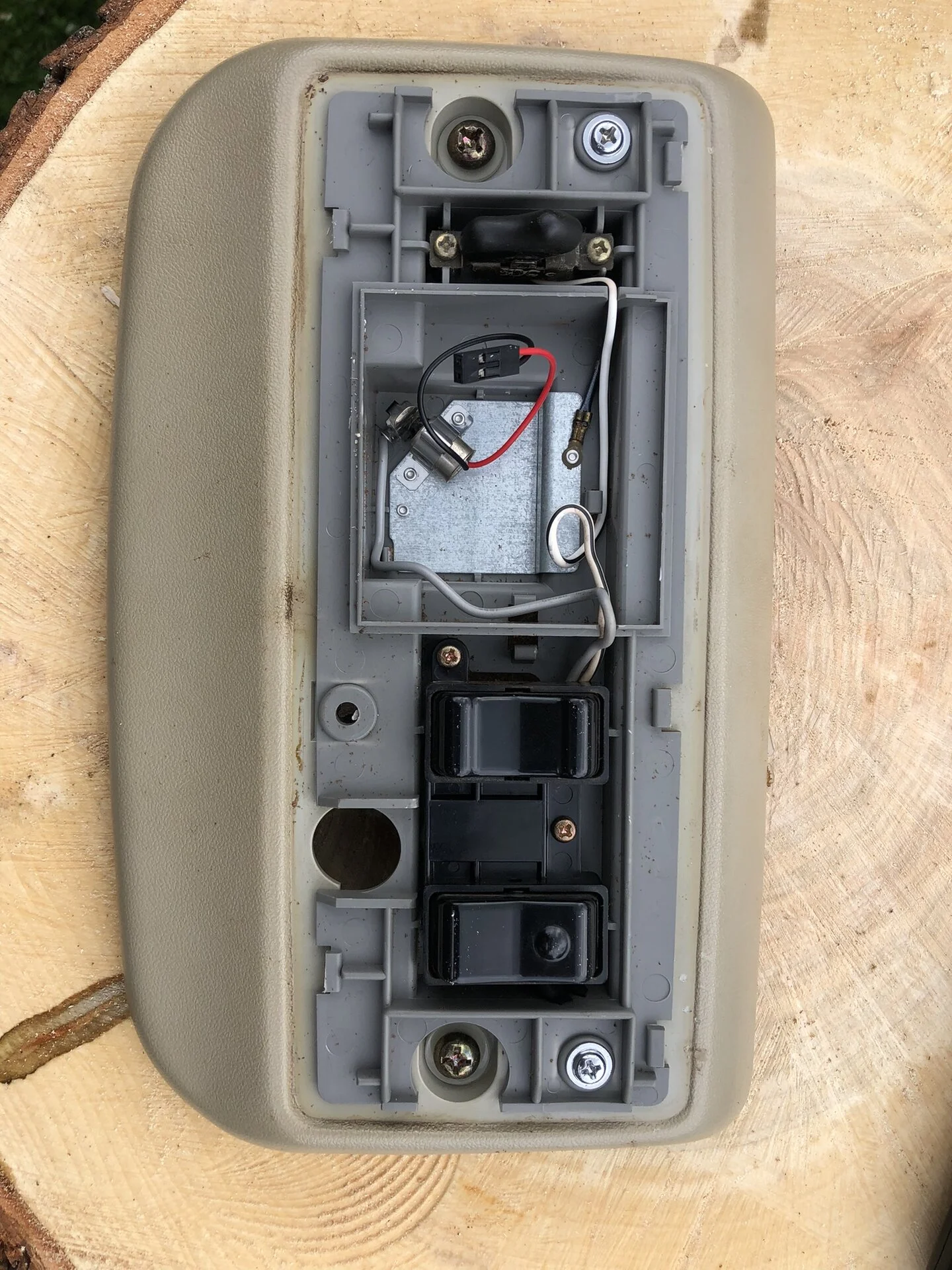

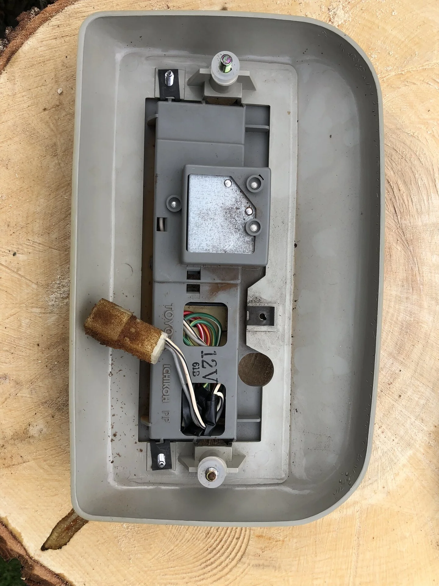

  1. Remove the single Screw in the Light/Switch Panel and Gently Pry off the Panel - Pic 5

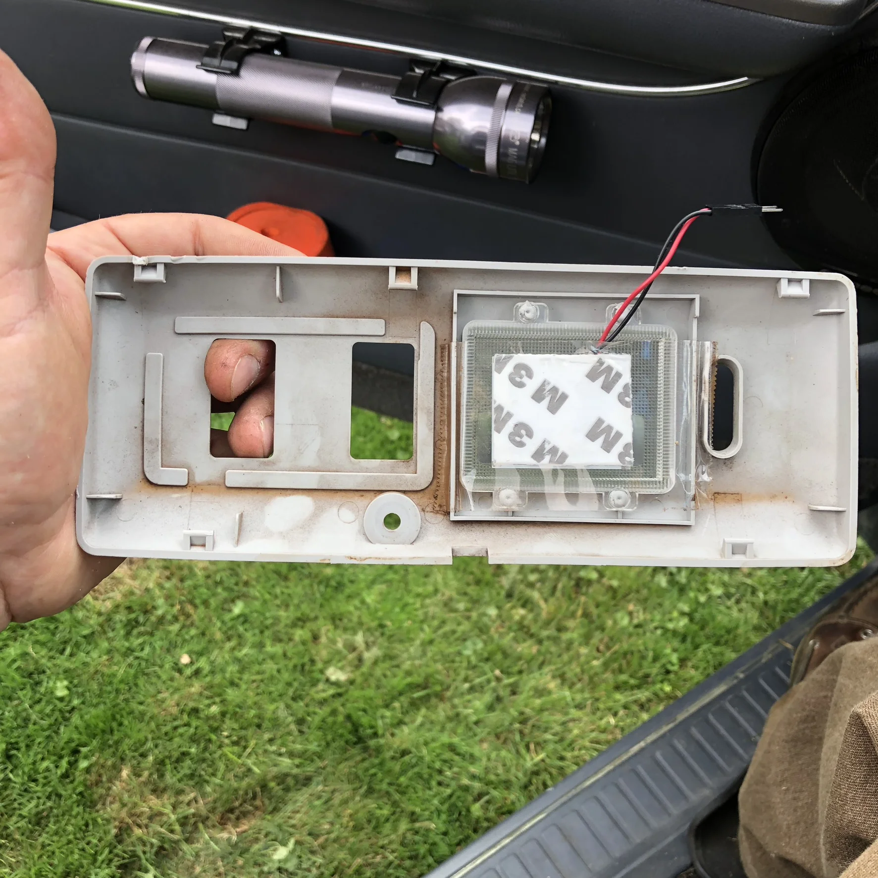

  2. Remove the 2 Screws on the Roof Switches to Let it down - Pic 4
  3. Remove the 2 Philips Screws on Left and Right - Brass Colored in Image - Pic1
  4. Drop the Panel and cut the Zip Tie holding Connector.
  5. Unhook the Connector by Putting a Pick between the 2 Connector Parts
  6. Using a Pick Remove the 4 Wires for the SUnroof Control from the Front of the Connector (Not the wire Side)
  7. Wrap those Wires in Electrical Tape.

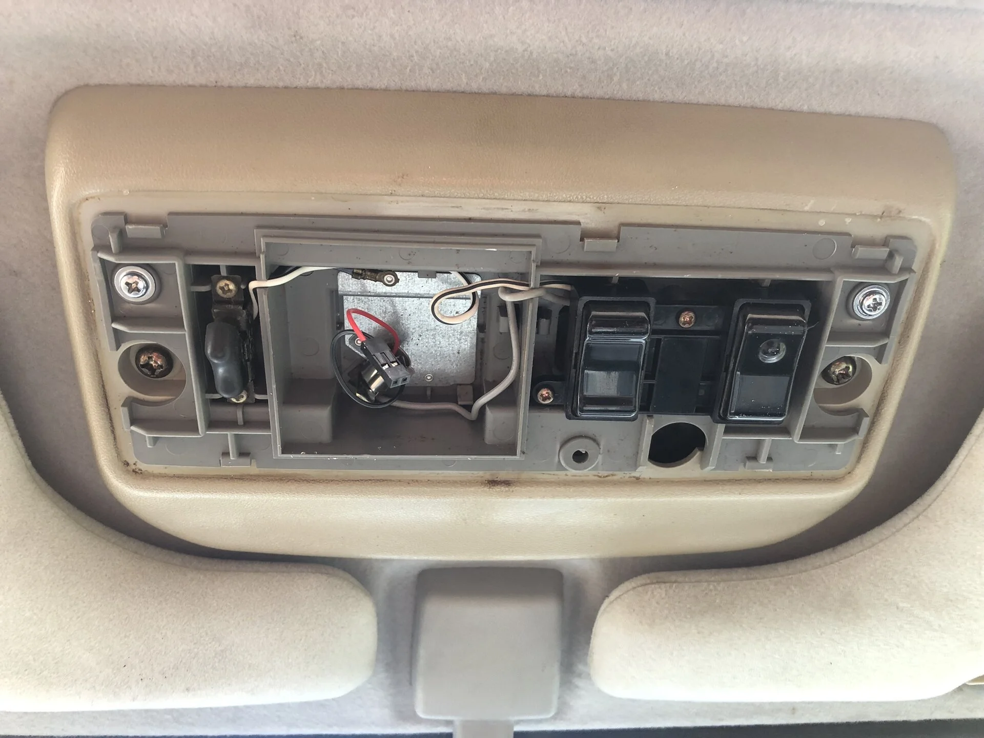

  8. Neatly Tuck the wires in behind the Roof Switches and replace the 2 Switch Screws - pic 3
  9. Plug in Connector and put both Pieces back up.
  10. Check Map Light Function - I had to reverse the Polarity
  11. Install 2 Brass Colored Screws and Pop Cover Back on - Replace Single Philips Screw
If you ever want the Roof to work again Write down the Plug Wire Locations and Put in Glovebox or Hide a piece of tape with info on Roof Motor.

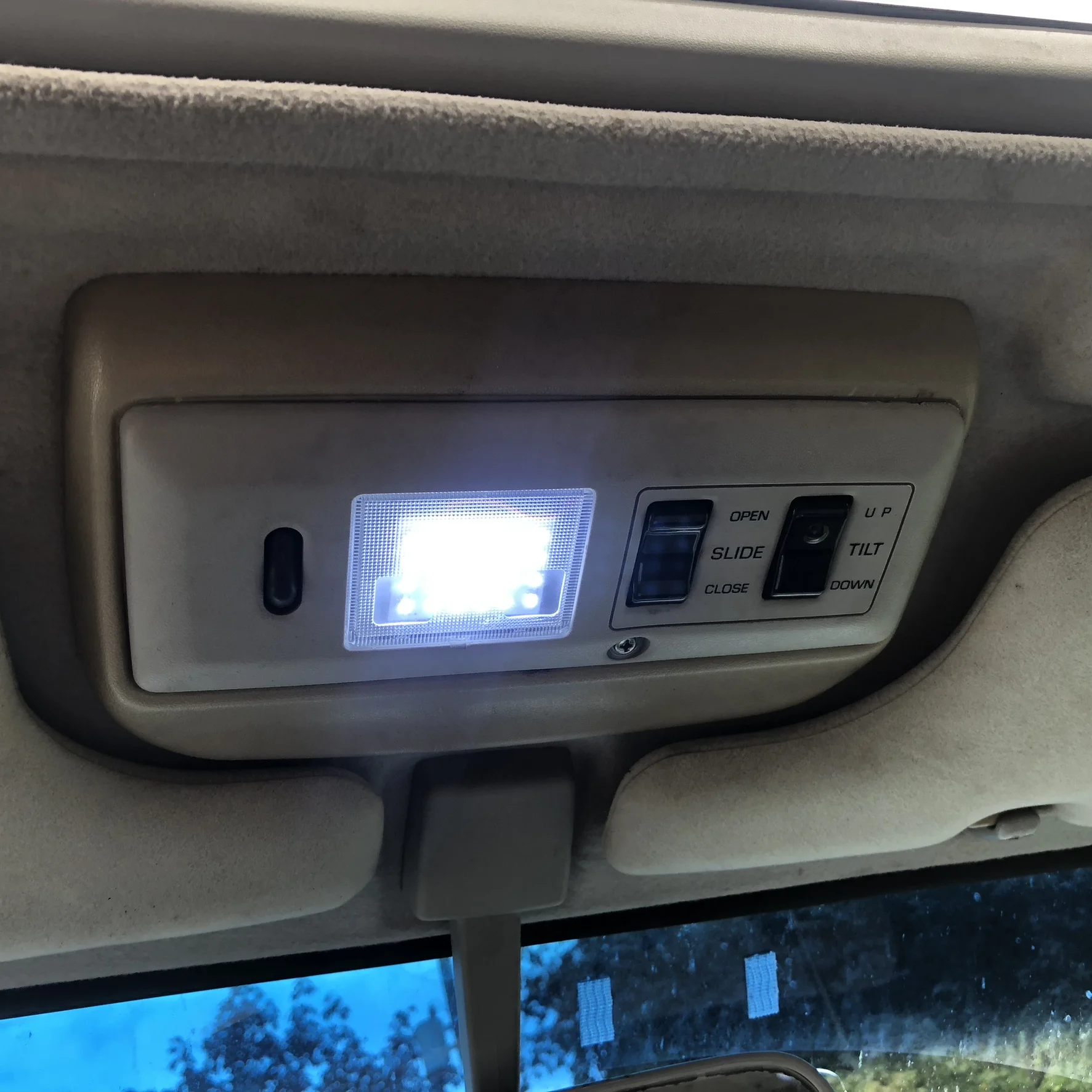

*The LED Panels are from Ebay and will not Kill Battery if Left on Overnight. They are Far Superior in Output and Consumption.
**I also love the Mag Lite Led Flashlight Mounted to Door. - Pic 4
