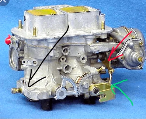

The carb looks just like this. Is the screw I need to turn in this image or is it a matter of changing the size of the idle jet?

Black Arrow is your idle mix screw, you’ll have another on the opposing side. I’d CAREFULLY screw both of them in all the way until they barely bottom out. Then back them out 1 turn each(360 degrees).
Your red arrow is pointing to your idle speed screw. Back it out until the screw no longer cracks open your throttle plates. Now screw it in until it barely causes your throttle plate lever to open.
Make sure your dang choke linkage (green arrow) isn’t keeping your throttle plate open while you’re tuning. You could just pull the pin and unhook it while you are trying to get your idle down to 650ish.

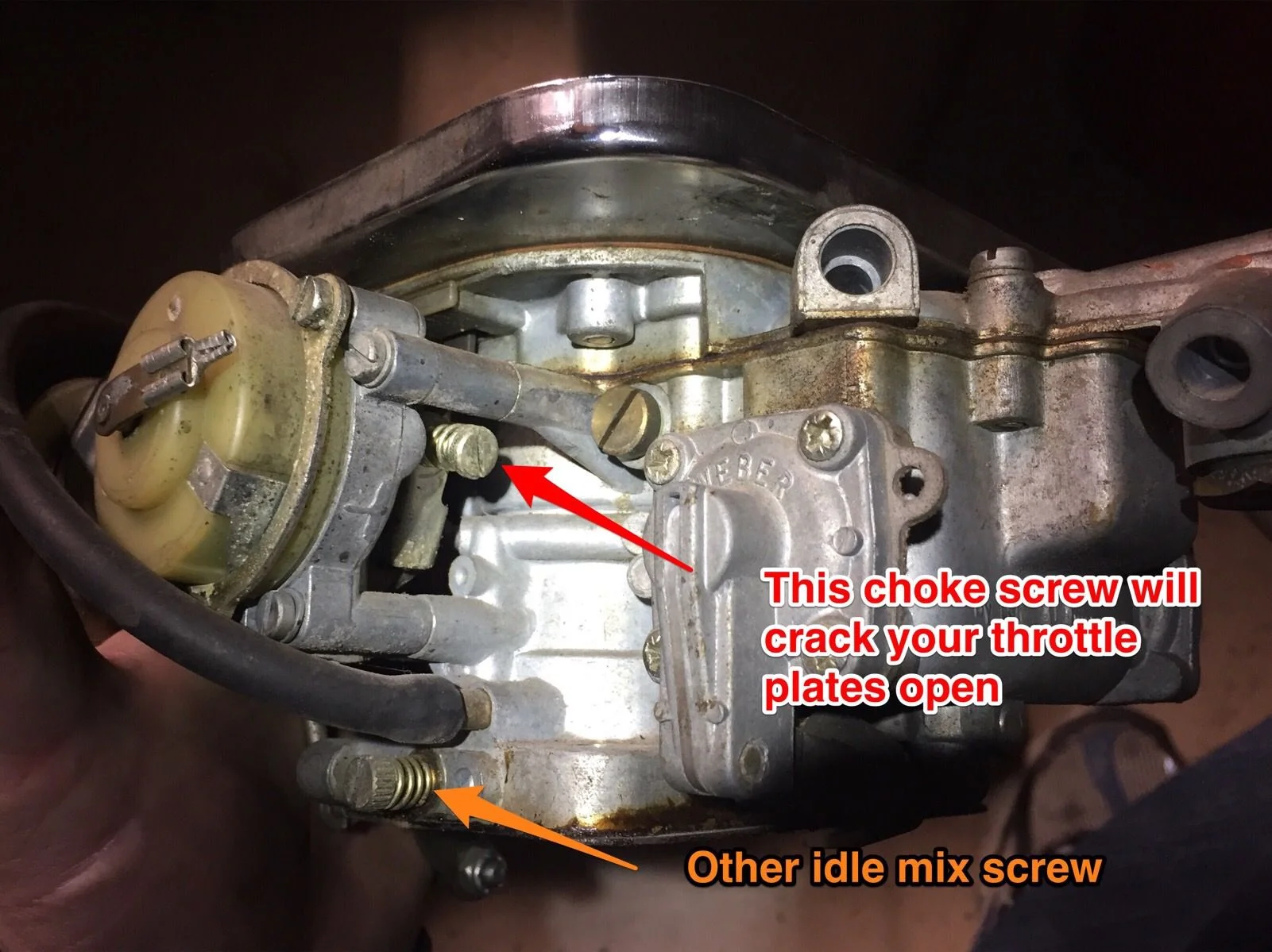

Doesn't the red arrow on my picture control the fast idle speed? Seems adjusting this hasn't impacted my idle once I'm up to temperature but it has gotten my fast idle speed down to ~1100.
I believe you should be able to back that idle speed screw out and screw in both idle mix screws until your idle gets so low your engine will stumble and die. If it won’t, then you may have an issue where your choke mechanism is holding your butterflies open.
