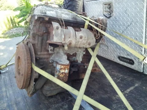

I bought the other 2L I found on CL... :bang: Got it for $450, and I get to chose which one of the 2 I want. :bang:
I just can't catch a break on this stupid swap. So now I am looking at a head gasket (because the heads need swapping since they are different and mine was rebuilt), at least I get to clean those damn valves now and polish the ports.
I spent most of the day swearing.
Now I get to find out which pistons are better, which rings, new rings, new bearings, if needed, etc, etc.
If I walk away now, I might break even by selling the parts but I am still left with a 22R that's giving me nothing but problems. So, might as well shovel deeper in the s*** :beer:

Is the 2L the same block and crank as the 2LT? If it is I would hope the pistons are the same too? If so just lightly hone the good 2L block, put in new rings and bearing and be done, slap you rebuilt head on and off to the races (not literally).
Judging by the rest of the quality of the rebuild do you want to trust that head though
Without having it tested
Oh I'm not trusting the head, I'm pulling it off and checking it myself. If it isn't cracked anywhere, then it's going on. If it is, guess I have a 2L engine that is getting a bunch of 2LT parts, including a turbo, put on it. In either case, I'm building one engine out of 2.

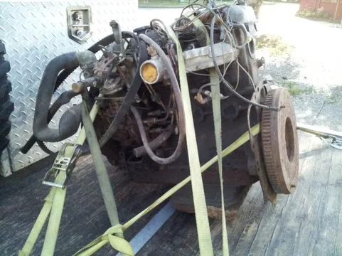

And the build continues. I hope I get a break with this soon. Got the other engine, rotates freely, the crank looks good on the front, the keyway and oil pump gears look great. I'm hoping to have time in a week or two to strip it down and compare blocks.
I liked the clean blue one, hopefully you have better luck with this one... If you need help I wont wear white this time ;)
I'd just drop that new one right in with a turbo........no worries........ :eek:
Looks like its been sitting for a long time, glad to hear it turns freely. I would offer to help some time but I'm having enough issues getting free time to work on my engine rebuild as it is.
