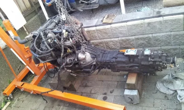

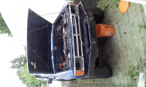

So today was the day where the donor got stripped. Big thanks to Sopel, Robert C. and Kris W. (she drives a Jeep but is very nice).
Everything went fairly well, took about 3.5 hours to rip it out and strip all the goodies off the truck.
Biggest and dumbest problem was the front cowl, which is not held in place with bolts, the way a logical person would have done it, no, it was spot welded to the wheel wells, which are spot welded to the inner fender frames and other things. This stupid design resulted on having to cut the cowl off in a spot to facilitate removing the transmission/engine combo.

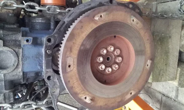

At last, it came out. So I figured this is a good time to do the following:
Timing belt, water pump, thermostat, oil pan gasket, front crank seal, clutch, maybe rear seal, other belts and any obvious things like that.
The clutch was surprisingly good, over 80%, the transmission, as it turns out, is a W56 A, from a 4 cylinder, and appeared to be good but I'll keep my existing one in the truck.

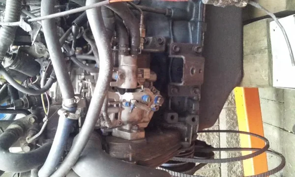

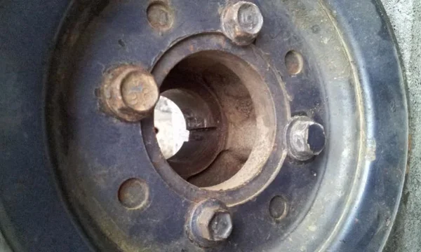

Then I went and looked at timing belt and this is where I noticed the big problem.
Crank pulley....

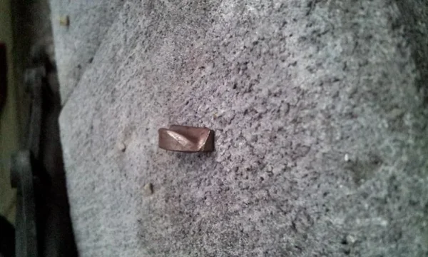

Keyway....

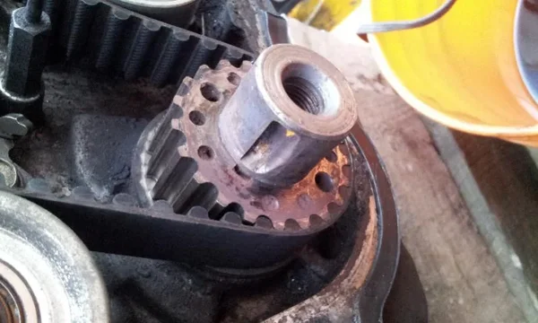

And the crank.....crap! At some point it must have come loose and ate the metal bits.
Now this is where I could look for another crank....yea, that'll be easy...and then have to basically rebuild the bottom end, because if I do that I have to replace bearings, etc, etc. everything is tight so I'm not in the mood for that.
I think I will weld it and machine it down to the right shape.
Otherwise, everything else is good.

Sucks about that crank, look forward to seeing the fix! Im surprised the key on the Toyota Diesels are not larger. The one on my Isuzu was damn near 5/8th wide. Really hope you can get it fixed up and reliable.

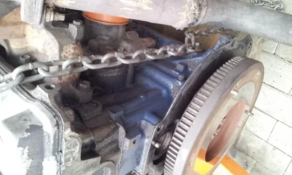

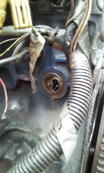

I was not impressed when I saw that, considering that the rest of the engine looks great. Someone must have done something big to this, the entire block is painted blue, but all the additional parts that are bolted to it have no overspray, so it means it was down to the block at one point. There is a small block heater on the side of it that has some blue pain overspray so I know it wasn't factory blu paint.
Weird, once again, another mystery origins truck.
I'll be pulling off the oil pan this week to see what's going on in there.

As for the repair, the ideal patch for this would be to TIG weld it, slowly build up on the material, with the correct filler rod, then grind it down to the shape needed. Since I don't have a TIG I will MIG weld it (just going to confirm with my buddy as to wire type recommendations) and then grind it down.
I've done that type of patch before and it works perfectly fine, the weld is actually very strong. This was caused by a bolt coming loose, not an additional load on the motor, because the only load that area sees is the alternator, power steering, and water pump. So once it is fixed and tight it should never be an issue again. The hardest part is going to be matching the welded area to the original in size.
Yeah not a typical toyota industrial blue.
Sounds like you got the fix sorted out, should work. I have seen it done in the past, i have also seen engine where people have welded the damper to the crank :S. Glad to see you are doing it right.
Please replace the rear main seal, made that mistake in the past.
