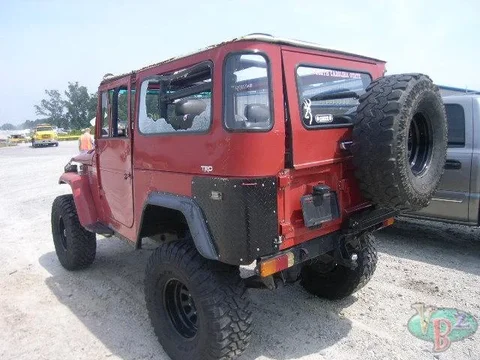

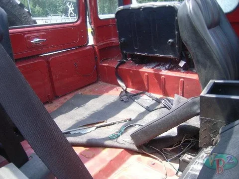

If you dont know, i just settled with the insurance company after 3 months of negotiating! haven't seen the cruiser since the wreck. We were able to work a deal out with the insurance company for them to bring me the cruiser. after talking to the guy who is driving it here, he informed me it didnt have the top, so the salvage yard lost the white fiberglass cap during transit at some point. Seems like when i called them time after time to tell them this would happen, it never sunk in.....:crybaby:

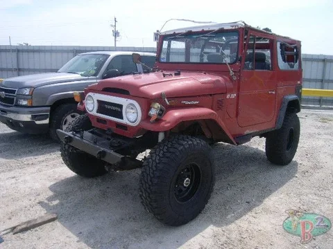

Heres what ive got torn down, this thing is a wreck!(literally)
Pretty obvious the motor mounts are broken!
you can see that the tranny and t-case are hanging down real low too...
