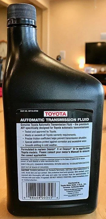

Some reading says Toyota called for Dex II/III. But, that's no longer sold and has been replaced by Dex VI at this point. Based on what you're running(gnob and GRM), I guess it's safe to say that really the steering system just needs a fluid that is capable of handling heat and acting as a hydraulic fluid? SO, that would mean just about any fluid that meets the temperature/hydraulic demand and is seal safe should do the trick in a power steering application.
Am I on the right train of thought?
What fluid is to be avoided? I.E which ones are going to cause the seals to fail? I've seen some mention to avoid using "power steering" fluid because it will create a leaker... but if it's designed for heat and the hydraulic action of a PS system and common seals, why shouldn't it be used? Red herring?
What KLF said!
If you research Dex IV I think that you'll find that it is considered safe to use in Dex II/III applications. The stuff sold as "Power steering fluid" in the US is different in composition from Dexron ATF. A fair number of domestic truck drivers use either interchangeably, but do not do this in a Toyota system.
Do NOT use off the shelf Power Steering Fluid. It will ruin the bearing and the vanes in the pump.
What KLF said!
From what I've read dex vi is pretty well the same in property as dex iii except for its a thinner oil. From a pressure stand point it would produce less steering assist due to being able to flow better. Not sure if it'd still be thick enough for proper pump lube/protection in the long run.
At shear value, their viscositys are pretty well the same. Not sure how often the PS system puts an oil in shear but if it is quite often then Id bet thered be no appreciable steering loss or additional wear in the pump.
I picked up a bottle of AC delco Dex vi for top ups in the meantime until I can get around to swapping in the new box. On the back of the bottle it says it is also a suitable oil for dex ii/iii application.
At this point might just run the ac delco dex vi when I swap the new box in or if I convince myself that the thinner viscosity is an issue I'll try and source some of the stalube or OE toyota oil.
