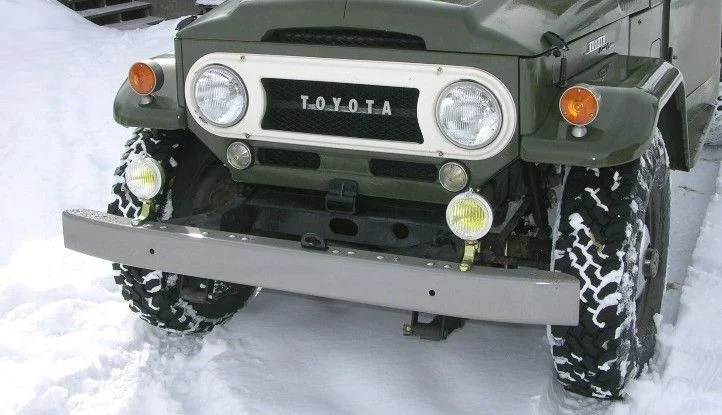

Wes has some on his '64, have you tried contacting mot?
no. mounting bracket must come from japan, central- south america, mid east, etc. mot might have some, owens export might, spector might..
i wonder if you can get the fogs from a dealer.. i might have to stock up.
Cool man i will look into it.
How do you have yours wired?

61 thru 67 had two wipers motors. 68 thru 74 had a single wiper motor at the top. After that single motor mounted to the bottom. FJ25 had two vavuum operated wipers. This was for the US market. I do know of one electric wipered FJ25 but that was imported from hawaii. To adjust the wipers just tighted the wiper arms. The same as later styles.
Mot is no longer in Japan, so he isn't a source for JDM parts anymore. OEM did have the fog light but not brackets. Steve at Owen's Export did have some of those. I do believe someone was selling perfect copy fog light and brackets that looked close on Ebay. Somewhere in the $65. Can't remember if that was apiece or each. Smoking deal a pair. I bought some from Steve thru Ebay for $75 set with brackets and was happy to get them.
