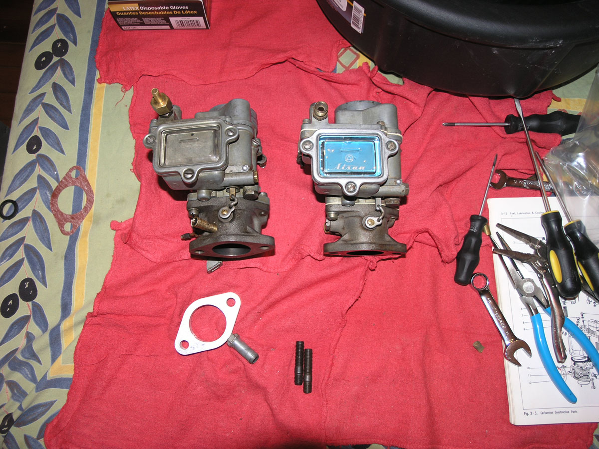

ok the old carb is on the left, and the one i rebuilt on the right.
Did not have any carb cleaner but used forces are and blew out any gunk etc in the jets, and put together with the carb kit. Lets hope this does the trick

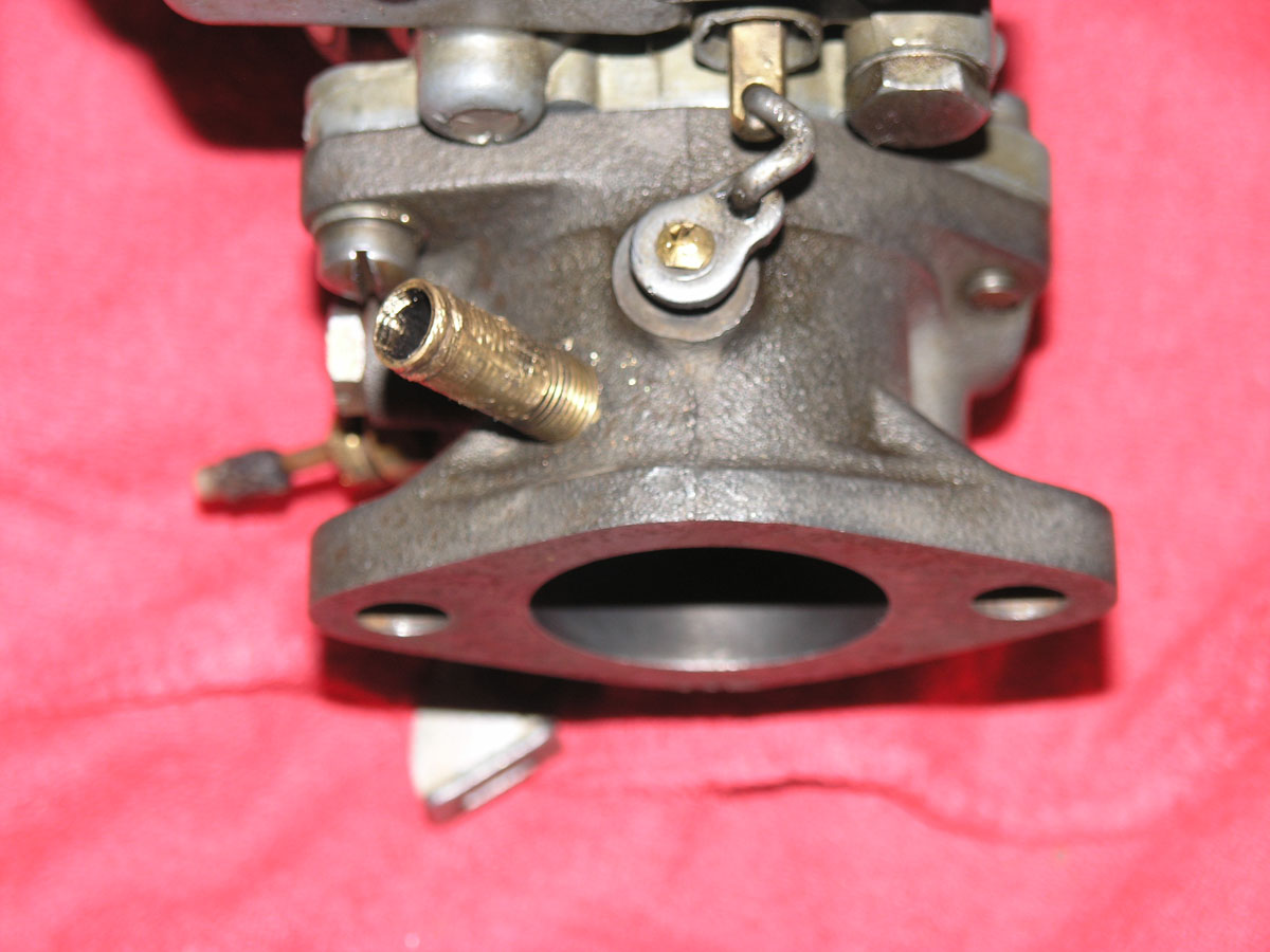

Notice the crappy PCV tap the PO put in the throttle body of the carb mark rebuilt hehe, weird s***, If the new carb i rebuilt does not work i have to block this bit off and try the old carb...
ok headed down and wish me luck :D
Alright!
Put the new stud in, riser insulator, ( the carb i rebuilt was horrible, so put on the slightly funky one that was rebuilt, )
Got the air out of the lines and it seems to run pretty ok :D
Stutters a little from first at low rpms, but if ya raise the rpms a bit in first as you roll into it is fine :)
