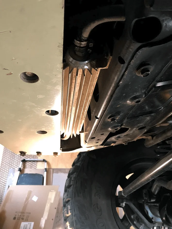

Who's running what now, and how is it holding up? Most of the threads I've found are pretty old. I'm gonna say the PS cooler @NLXTACY runs is beyond reproach because, well, because @NLXTACY runs it and puts it in his kits. What about fans, tranny coolers, condensers--what fits, what lasts?

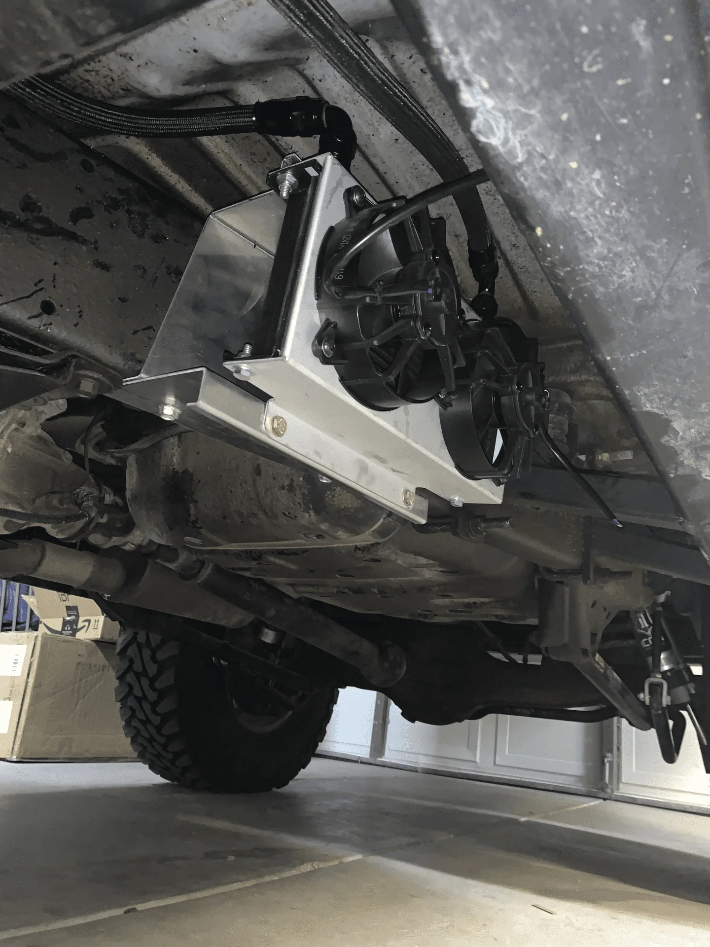

I have a Derale 15845 fluid cooler with dual fans on a custom bracket mouted to the driverside frame rail. I am running my engine oil through this and the fans are controlled via my switchpro, the setup works great.
Have you measured temps before and after install, are you running giant tires or hydraulic winch? I ask because I've seen some concerns about non-paperclip coolers lowering temps TOO much in cooler climates. Not a concern in SoCal, but you're PNW...
I haven’t put my temp gun on it in colder months because temps are less of a concern then but during summer, rock crawling on 37’s, hydroboosted brakes, and no hydro assist steering (yet) the steering box temp runs a solid 30-35 degrees cooler. Say 140 instead of 175. I’m glad you mentioned winter time temps, I’ll pay attention to that this winter. I wonder what temp would be considered too low?

I also ran this same cooler on a trailer queen crawler I built before getting into an 80 series dating back to 2011. That rig had hydro assist as well hydro booster brakes so the system was even more circuitous than my current set up and between the two I’ve never experienced one problem.
Those living where winter is bitter cold can install an in-line oil thermostat to assure that over cooling is not an issue.
Cool. :) Have you tracked temp diffs?
Both Oil and Coolant temps stay cooler. I noticed about a 5-7 degree drop in coolant temps after adding the oil cooler. The oil temp gauge I have has a programmable color wheel, which I haven’t changed the factory start and end points for yet, but I can tell you that the gauge was typically in the middle of the Orange range before and now with the cooler is always in the green or low side of the orange...so definitely keeping the oil cooler.
