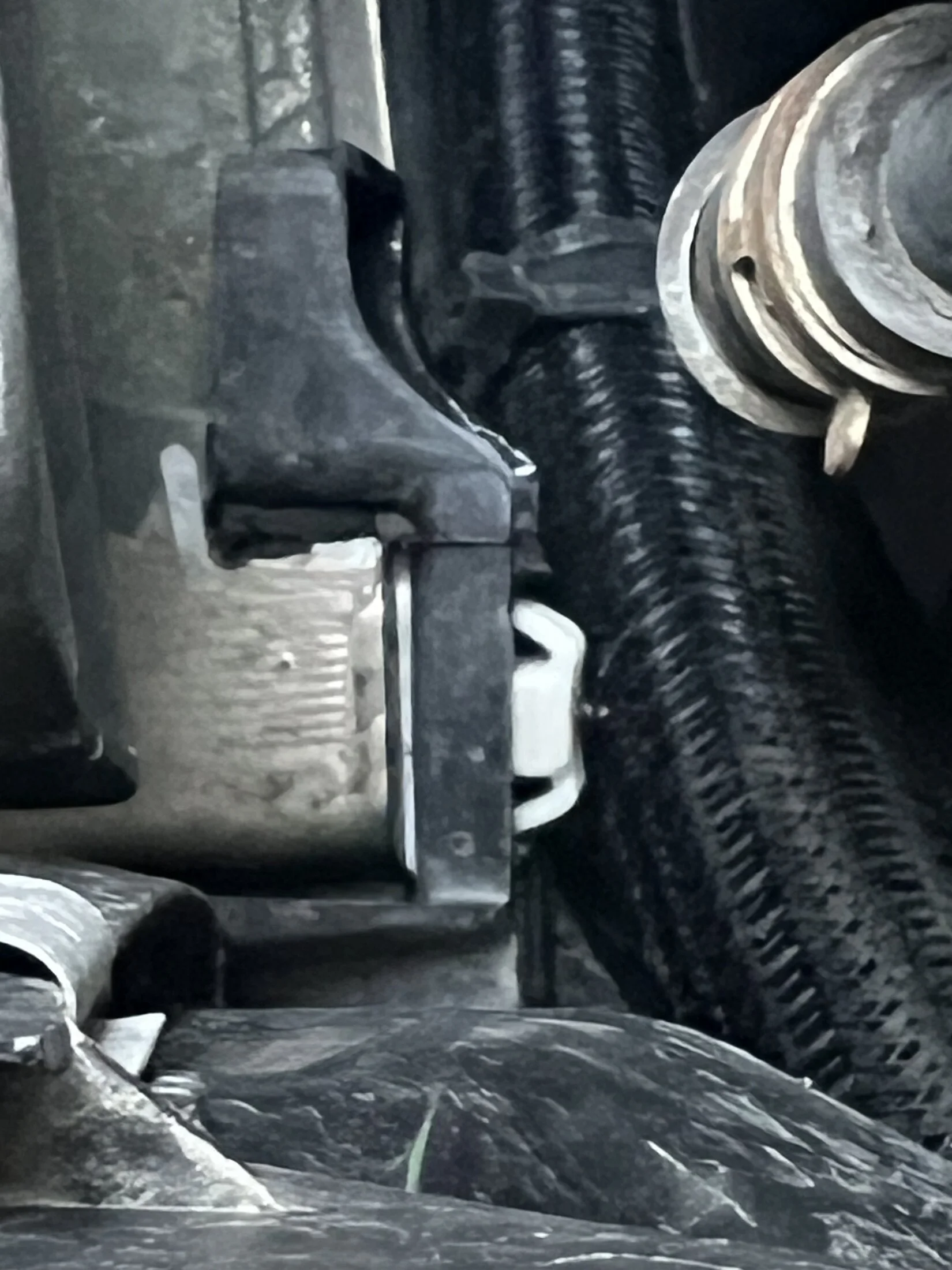

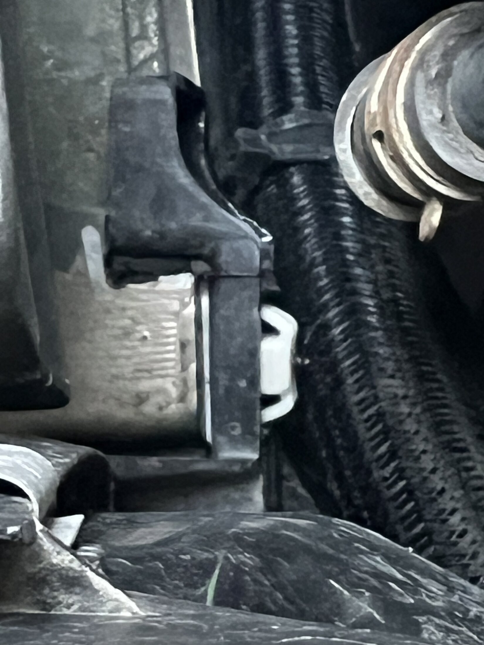

I don't think I stopped to take pictures. If you hold the grille in position, you will see where you need to do minor trimming. You can either trim the grille or the light mounts, I opted to trim the grille. It is only a small amount that needs to be trimmed.

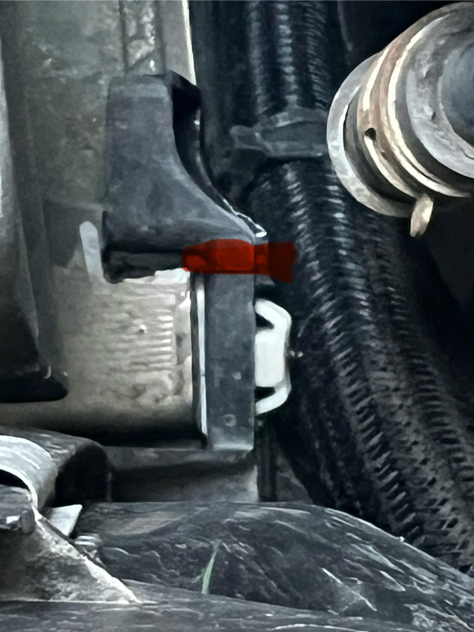

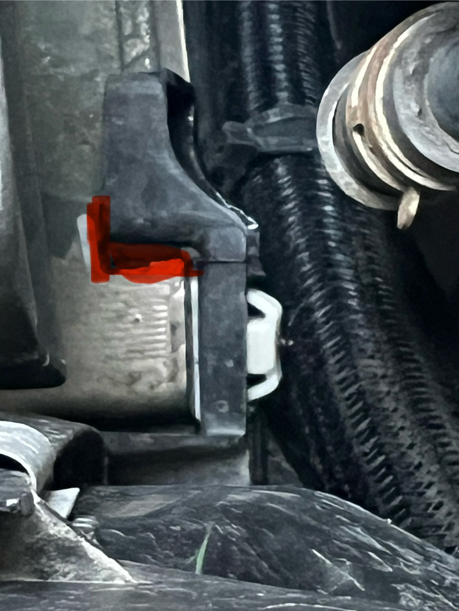

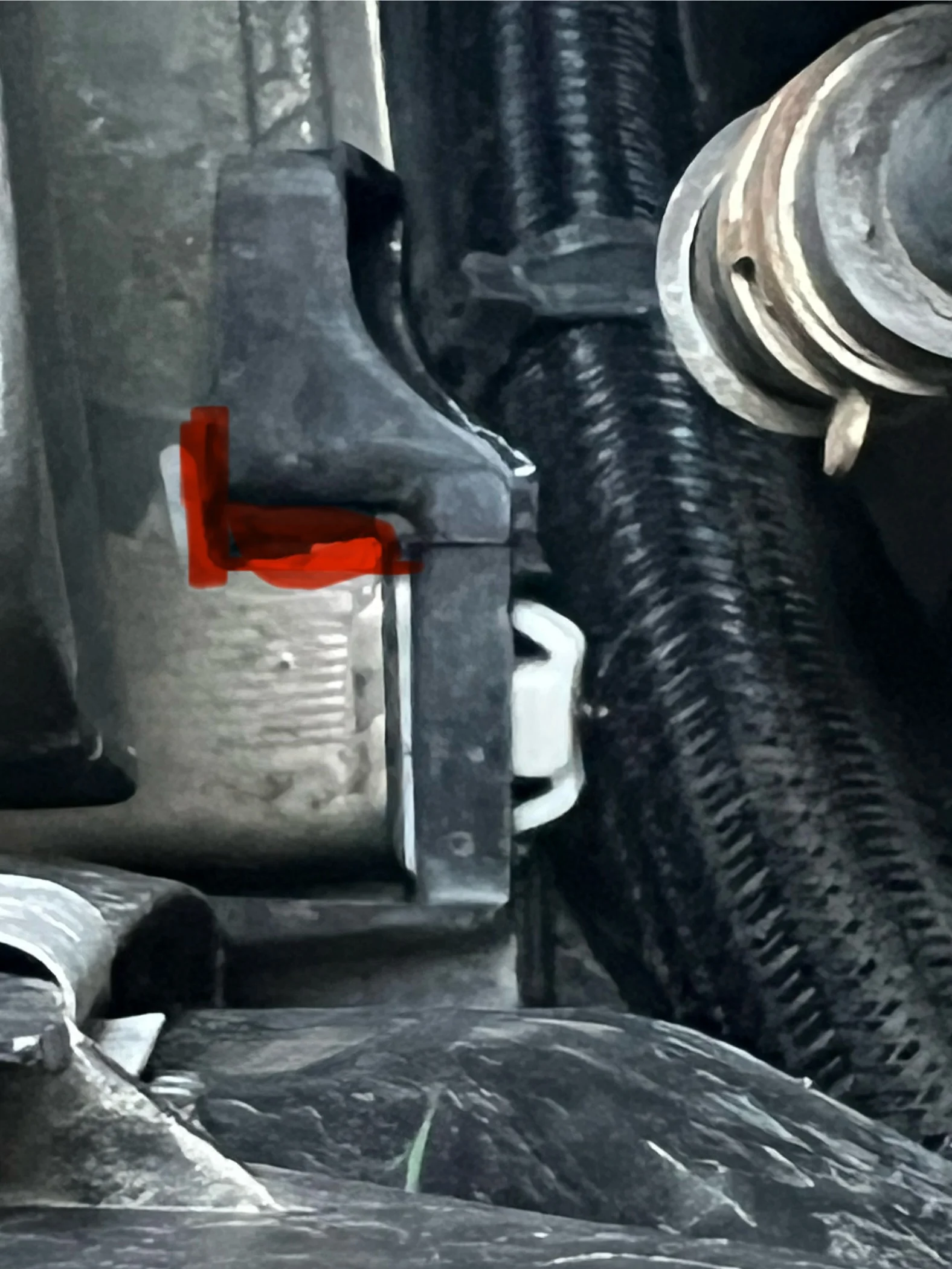

It is the side mount in the middle of each side. These pictures are looking down from the top
I trimmed the grill side, cutting here:
I could have cut the depo side instead, by cutting here:
