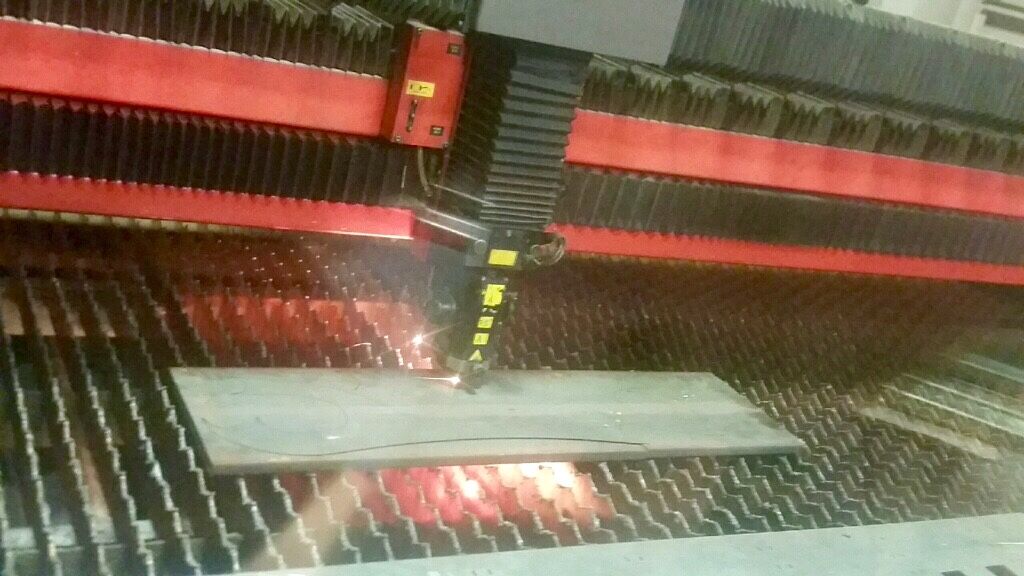

When my buddy and I built radius arms, we laser cut them out of some 3/4” plate, then welded bushing cups to them which we turned on a lathe. Seemed easier than this and it was very easy to make room for tie rod clearance.
Not as flashy as these, but it continues to do its job on the truck we put it on.

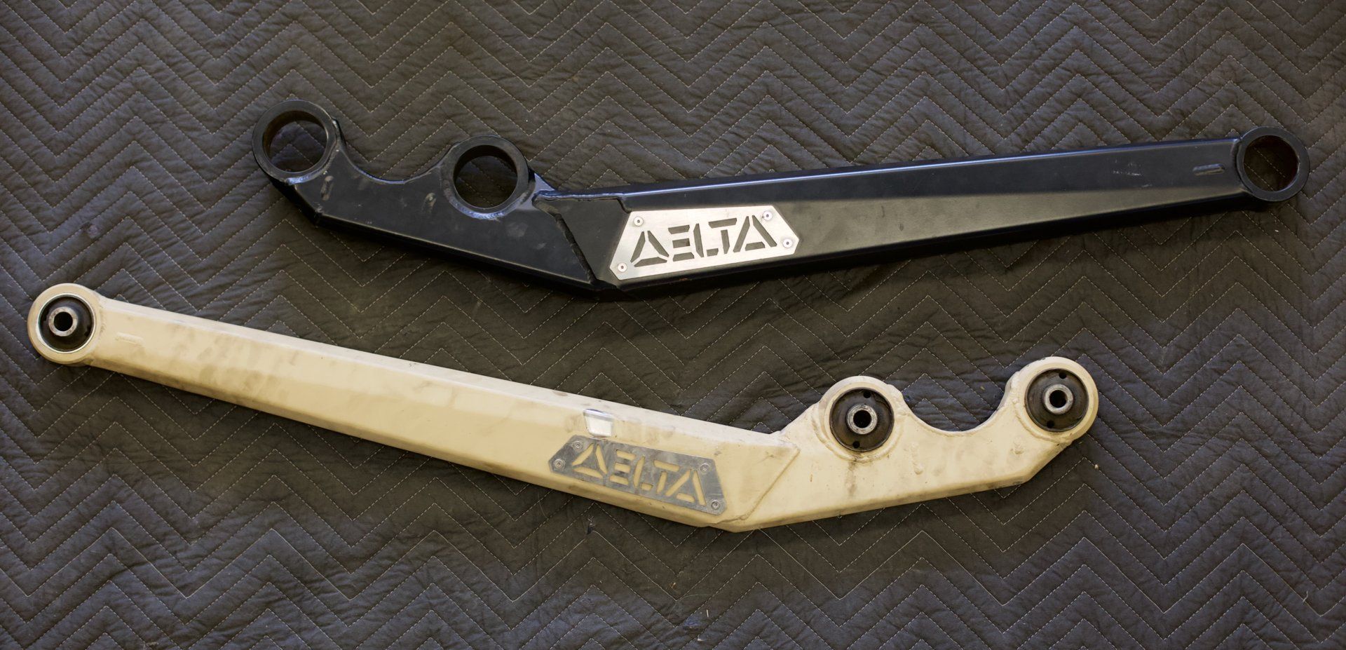

Howdy folks. Getting rid of two one sets of prototype radius arms if anybody is interested. These will never be made again, therefore there will be no service/support after the sale. The black set (powder coated, never driven) will require steering to be in front of the axle, and potentially interfere with anti-sway bar (will depend on your setup). The FDE (painted, driven many miles on/off-road) set will work with fully stock setup, was installed for many miles on 2.5 OME lift, no drop on anti-sway. You can see some tire rub, the tire/wheel combo this rig runs are the FJCruiser steel wheels (17x7.5, set in a little) and 315/70/17 tires. If you run more of a stock offset, good chance there will be no rub. SOLD
Neither set will come with bushings (unless you want to add that in for additional cost).
These have the same correction geometry (adding 5.7*) our production arms (about to be announced) have. This works great with the above mentioned 2.5 OME lift.
Price: $600/set
Howdy folks. Getting rid of two sets of prototype radius arms if anybody is interested. These will never be made again, therefore there will be no service/support after the sale. The black set (powder coated, never driven) will require steering to be in front of the axle, and potentially interfere with anti-sway bar (will depend on your setup). The FDE (painted, driven many miles on/off-road) set will work with fully stock setup, was installed for many miles on 2.5 OME lift, no drop on anti-sway. You can see some tire rub, the tire/wheel combo this rig runs are the FJCruiser steel wheels (17x7.5, set in a little) and 315/70/17 tires. If you run more of a stock offset, good chance there will be no rub.

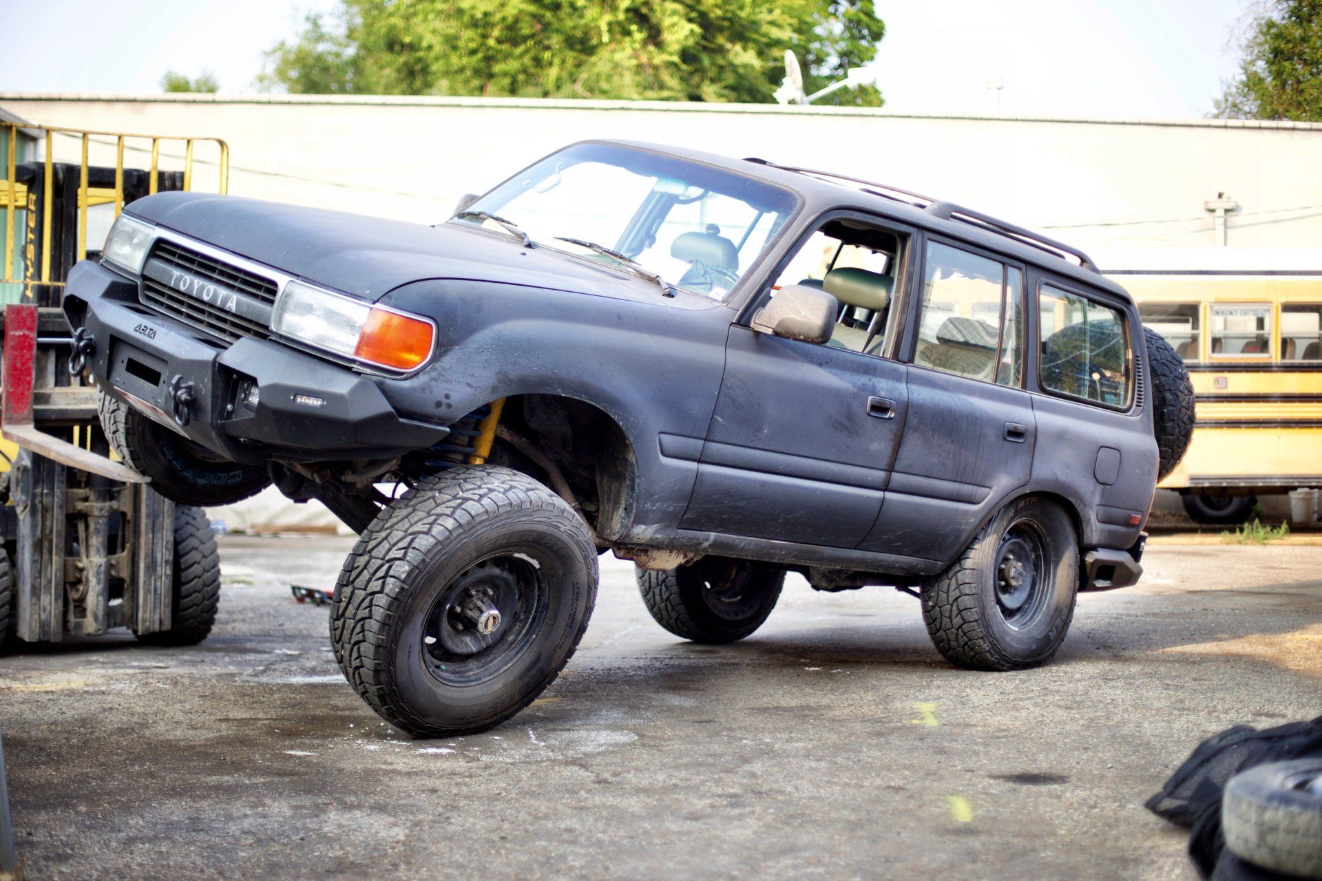

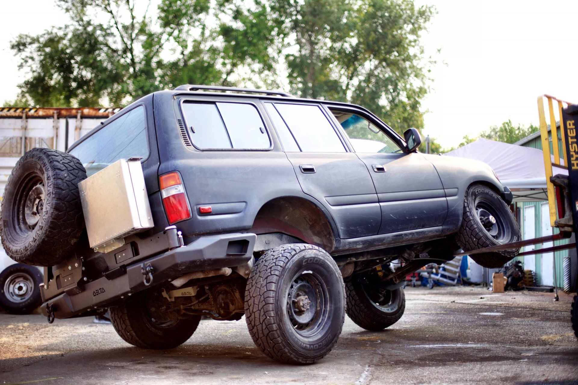

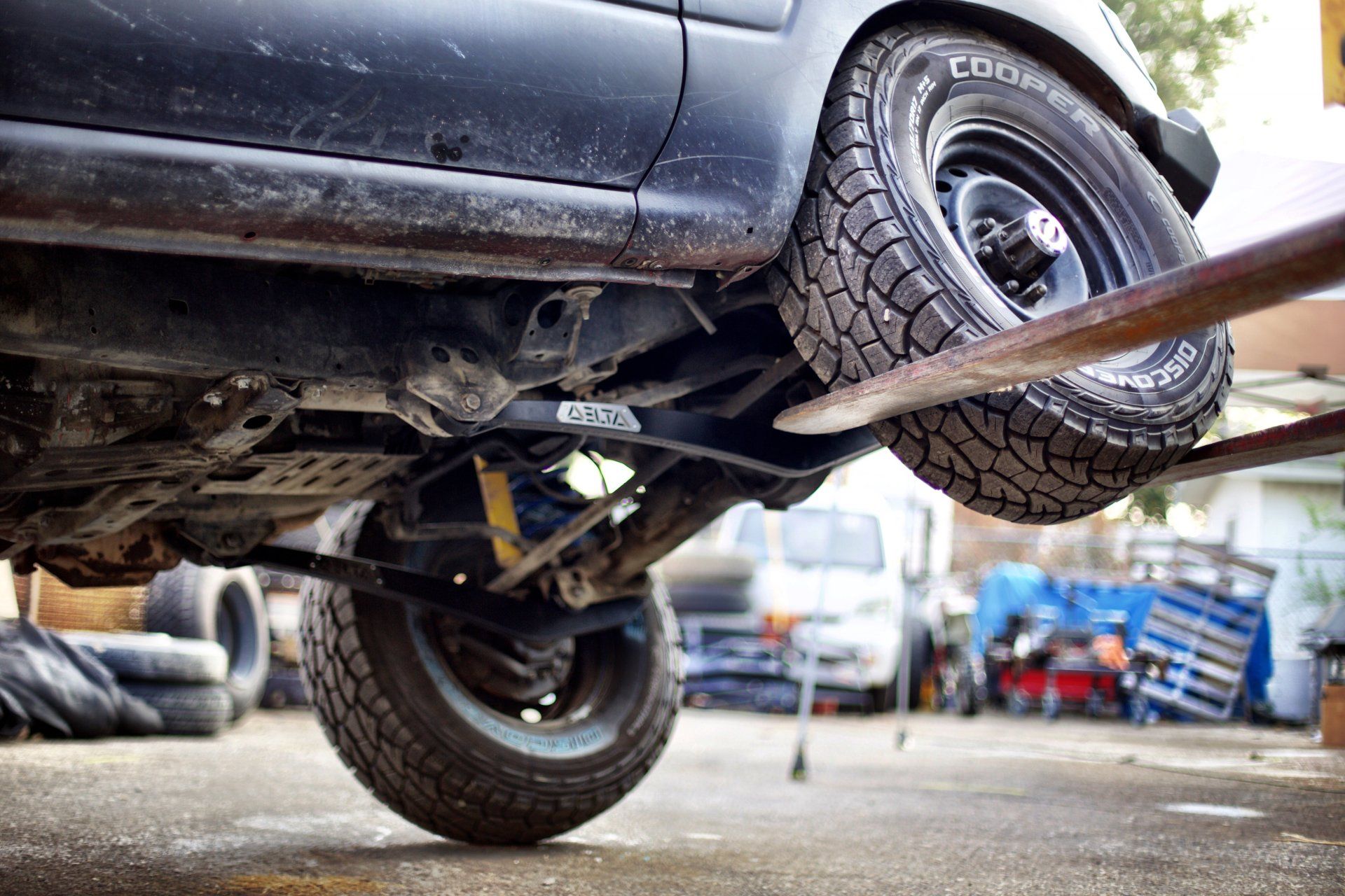

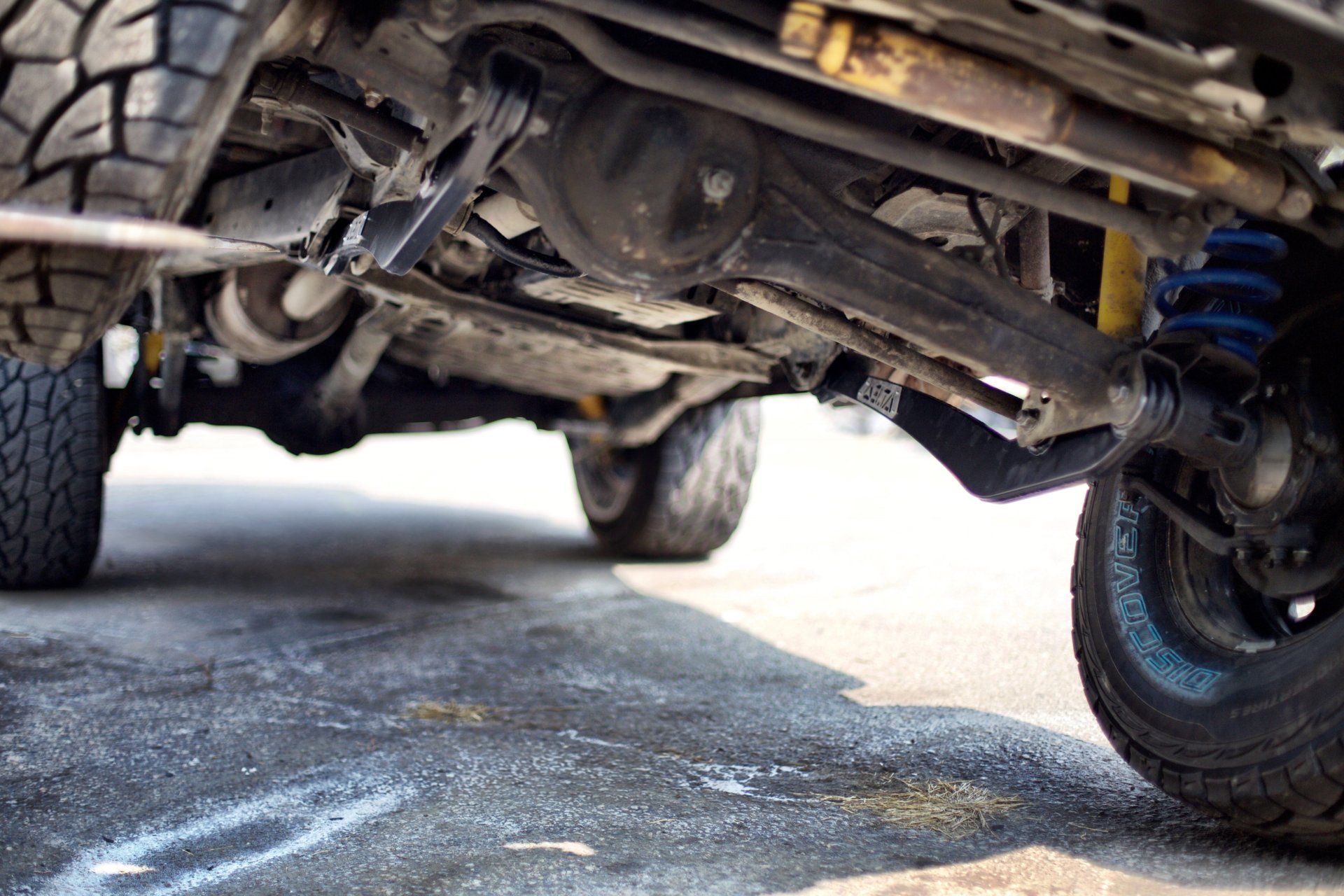

I saw your production arms are now on the website. They look very nice and I like that they are much narrower than stock. I see that you have both a 2" and 4" castor correction option. You mind sharing how many degrees of castor correction in built into each version? For guys sitting at 3" of lift, it might be handy in deciding on which one to go with.
Also, do you have any pictures of articulation with the arms? I'm sure people would be interested in drag link clearance.

You bet! They are designed to be at the high end of stock caster range (2*-4*) at stated lift. As in, the 2” lift arms put you at 4* at 2” of lift. This means at 1” of lift you are slightly more than 4*, a decision we made based on a lot of drive testing. Having slightly more caster, but not excessive, makes driving way nicer when it comes to handling. It also makes it so if you have 3” of lift, you can choose the 2” arms OR the 4” arms, depending on your desired caster. For example, if you have 3” of lift you could choose the 2” arms and have something close to the minimum Toyota spec for caster OR you could choose the 4” arms and have slightly more than the Toyota spec caster. Working on a chart that shows actual caster at different heights for each arm.

Some pics (if these don’t cover why you’re looking for will have to borrow forklift again so it’d be a bit):
