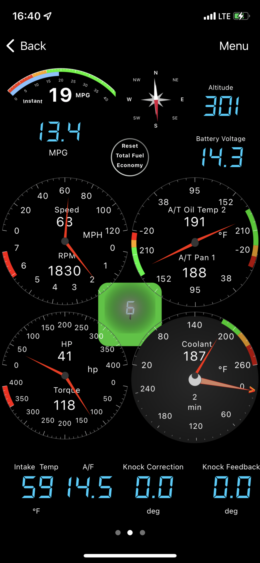

will the 6speed transmission lockup at freeway speeds?
Conditions
60 deg
Flattish
6th gear
63 mph
D mode
4.88 ratio
35x10.5r17 (34.5” book) roughly 95 lb a corner
Lockup? Yes

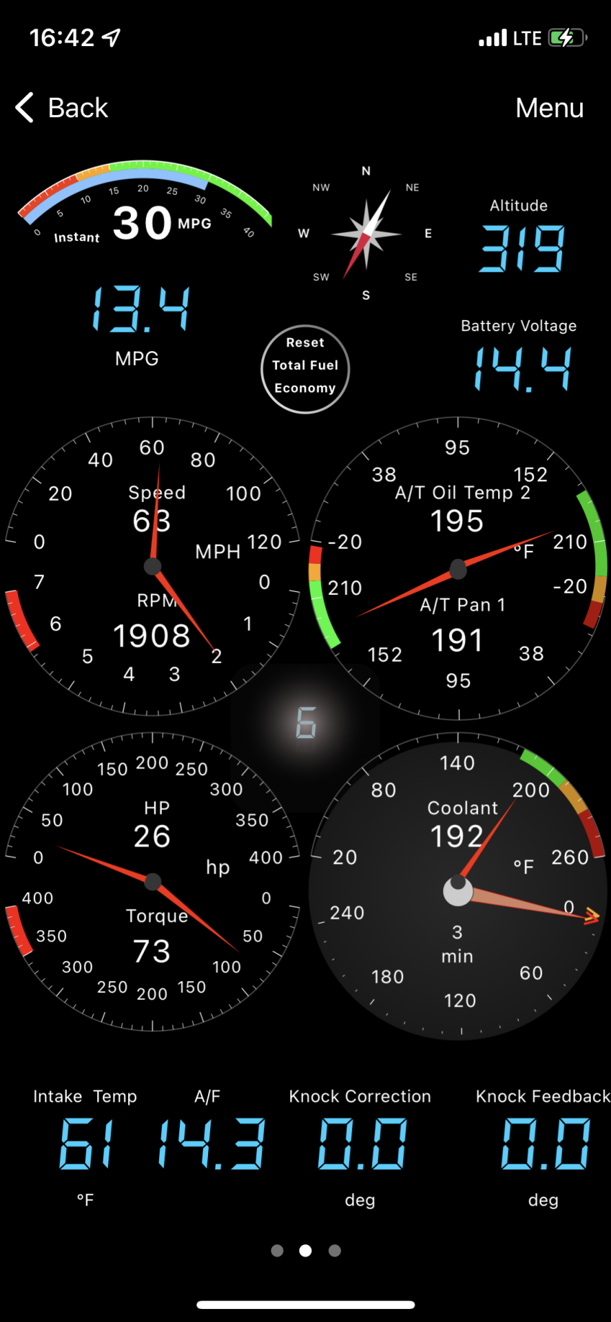

I also posted a pic of an unlocked (no green light in center) to show the dashboard isn’t broken.
Stayed locked up a medium hill, so it looks to be good

Data...good stuff!
I think we know that it will lockup in 6th. The question was would it lockup in 4th and 5th, with 4.88s, and when towing? I think we got an answer of yes in another thread, but it seems there might be some impact to the degree it will readily lockup?

Yes I can confirm it will lock in 4th and 5th when towing. It’ll lock in 6th too but you pretty much need to be going slightly downhill to keep it locked. 5th is tricky - it’ll lock up on flatter lands up to 75mph when towing but on hills or even into a bit of wind it does unlock, whereas in 4th it pretty much stays locked except very steep grades.

May I ask what app/system this is for monitoring the vitals?
