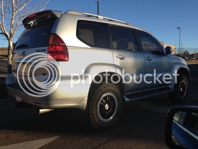

I met the owner in a Home Depot parking lot. As I was leaving another silver GX pulled in and I could tell right away is was slightly different.. pulled up next to it at the light and was digging how these TRD wheels, Duratracs, and lift looked on it.. now trying to convince my wife that this is the future ;)
