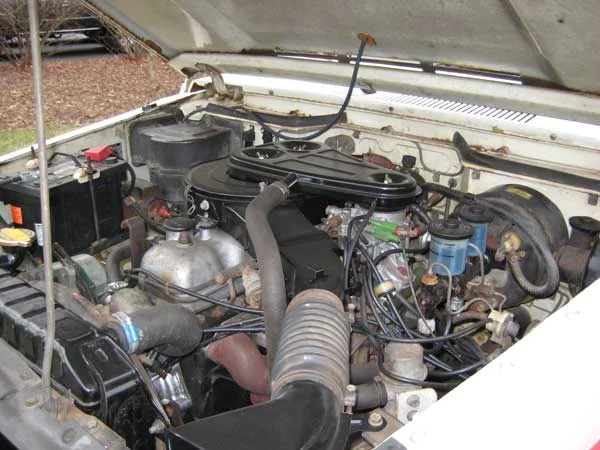

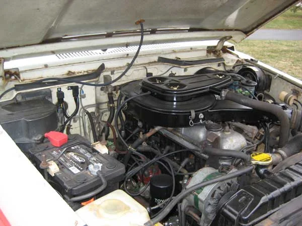

Under the hood things looked pretty well, well used. Cosmetically, the air filter housing was one large island of rust. Most of the vacuum lines were cracked, the radiator had dreaded streaks of blue green in several places. There were extenders on two spark plugs so I kind of new that our latest piggy would be an oil burner as well as a gas guzzler. The parking brake needed attention as well.

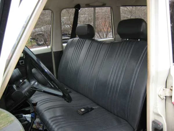

The interior is in good shape. One small tear in the head liner and a saggy drivers side seat which is the source of summer swamp ass (piggy owners will know what we're talking about). The heater/defroster hoses have been replaced and the air plenum from the firewall to the heater has been repaired. I've also added a 0 to 5,000 rpm tach and a switch for the fog lights to the dash cluster. The brake light and seat belt warning buzzer work as they should. We also had the original seatbelts rebuilt by SsnakeOyl products to keep the interior as original as possible. I also replaced the speakers that a PO had mounted in the doors. The PO had the Sony head unit installed and with out the dash plate being butchered, very nice.

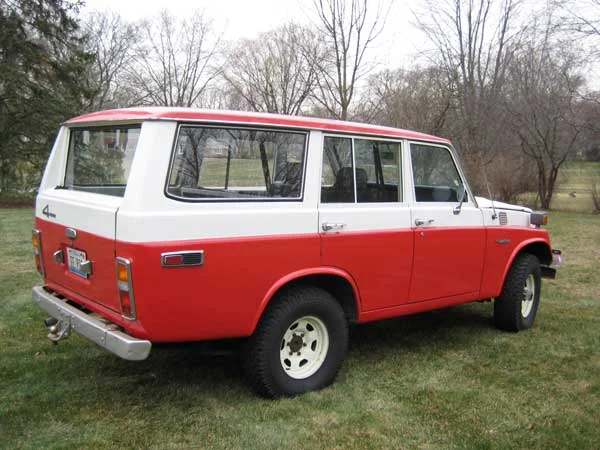

Cosmetically, rust in the usual places, rear quarter, front quarter, hood (surface only), roof (surface only). It’s been repainted once although the red/white color scheme has been retained. All the window seals are shot as are the door weather seals – especially the rear window/tailgate. The rear window works well but the rear heater, windshield washer and carb cooling fan are in operative.
New antifreeze revealed the radiator needed help so I dropped in a spare that Gumby had given me from the war wagon when he did his engine conversion after a local radiator shop reconditioned it. New BFG TA’s replaced the dry rotted Bridgestones. All vacuum lines were replaced. Several of the bulbs for side markers and tail lights needed replacement as well. The carb went out to Jim C for a rebuild and tune so that when spring popped Arnold would at least be drivable. A new voltage regulator and alternator rebuild were added to the list after we figured the battery wasn’t fully charging. I removed, cleaned and replaced the odometer which is now functional again and had the wife install a new fuel pump – her very first wrenching experience.
With time running tight I had a local shop change all the fluids, diffs, TC, oil, antifreeze plus a tune up. Only problem arose when they failed to completely fill the radiator. I’m only 5-6 miles away from the shop but 2F heads are not tolerant of running hot. Next on the list was a new/rebuilt head and since Arnold still had all its original exhaust manifold/exhaust system it still had the California emissions “thermal reactor” which had cracked to the level of being unusable. I couldn’t find any later exhaust manifolds which would have been an easy swap so I ended up finding a “thermal reactor” that Mark A had buried under a work bench in his shop. One little weld to repair a small casting break and I was back in business.
Since the wife is now a certified master of 4 speed manual transmissions we bit the bullet and swapped the engine this spring with a reconditioned 2F from SOR – it was cheaper than a local rebuild, and added a new clutch, water pump and thermostat.. What a difference. The old 2f had an oil appetite of a quart every 100 miles or so and had zero “umf”. Now it drives, and pulls, better that Wang who’ll be getting Arnold’s old 2F after a winter rebuild (my winter project).

Can someone tell me what's up with the shackles? Arnold drives great no pulling or death shake. I'm planning on Alcan's next spring.
Thanks,
Harry
It looks like someone installed an extended shackle on the drivers side only!?!?

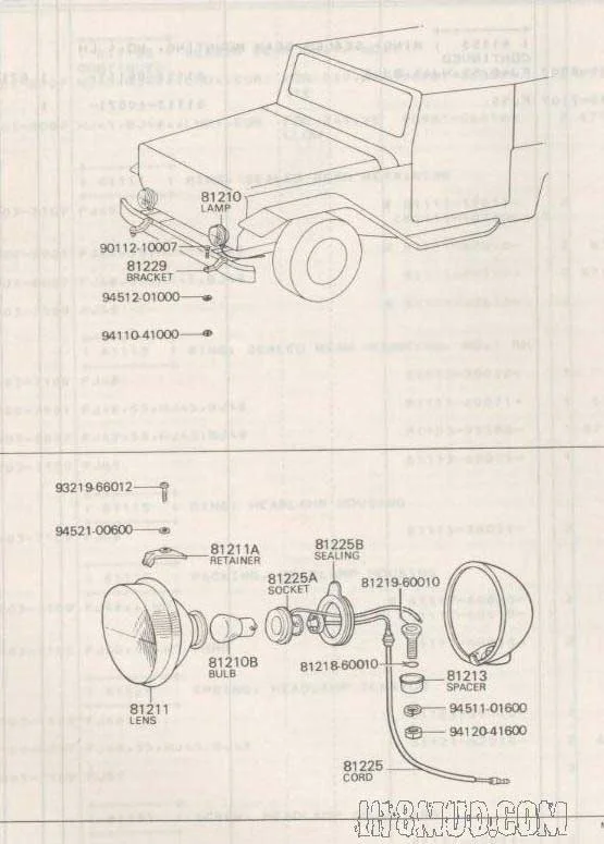

Nice ROM...wife has also had an fj60 for a DD for a long time.......... btw, any pix of your foglight brackets?, they look and give a nice touch to the vehicle........an fj 45 used at work overseas had them...........wouldn't mind putting some on "Rusty", Trollhole found site in his thread that had the foglights but could never get the website to come up; Marshall any luck with the site on fogs?
Lou
Lou,
The fog light brackets are nothing special - just a few chunks of flat bar with holes in them. If you really want a pic I can oblige.
Harry

Harry, your cockpit looks great with a lot of detailing......am curious, what is that little green button to the right of your tailgate glass switch?
Lou
Nice Pig!!!
Lou
Lou,
The green toggle is for the fog lights. I'm still searching for an OEM fog light switch.
