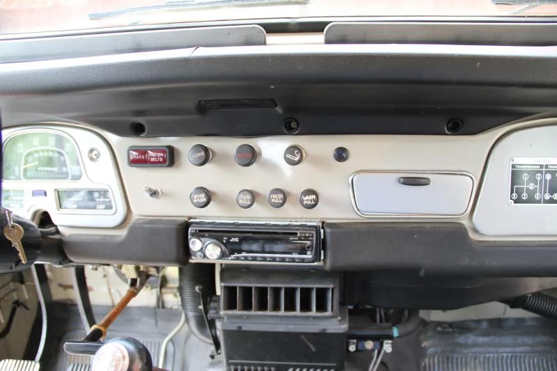

I'm still looking for the red dash single DIN pic someone sent me, but until I find it, here is another example, and it looks like they did not have to cut the pads (I would set it a little further back to you don't see the light colored metal of the stereo):

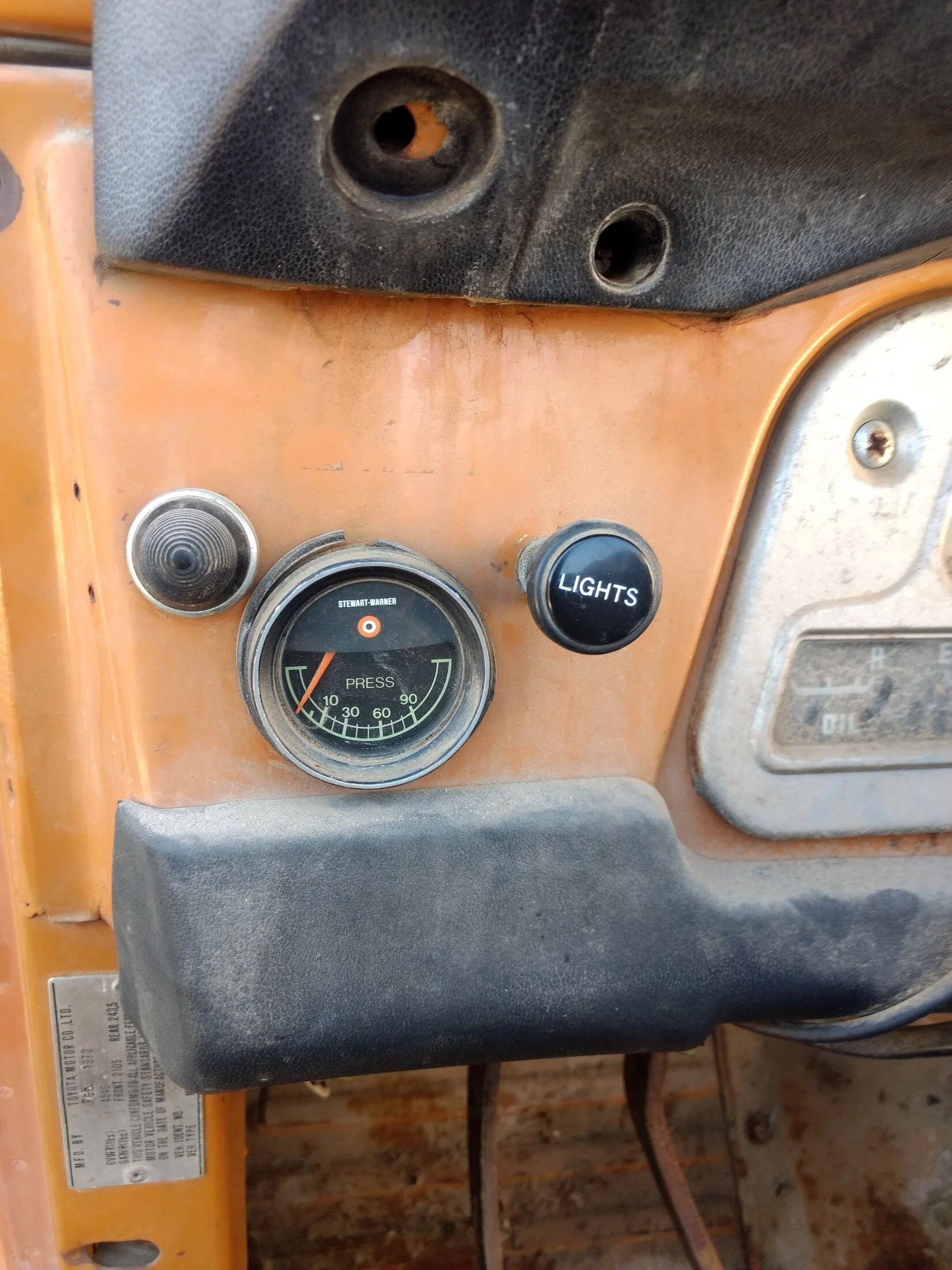

I would never have hacked up a dash like this but a PO did.
Can see you have a little room to cheat without having to cut the pads. The cap that covers the opening wider than the opening. Many modern radios do not have a bezel which helps.

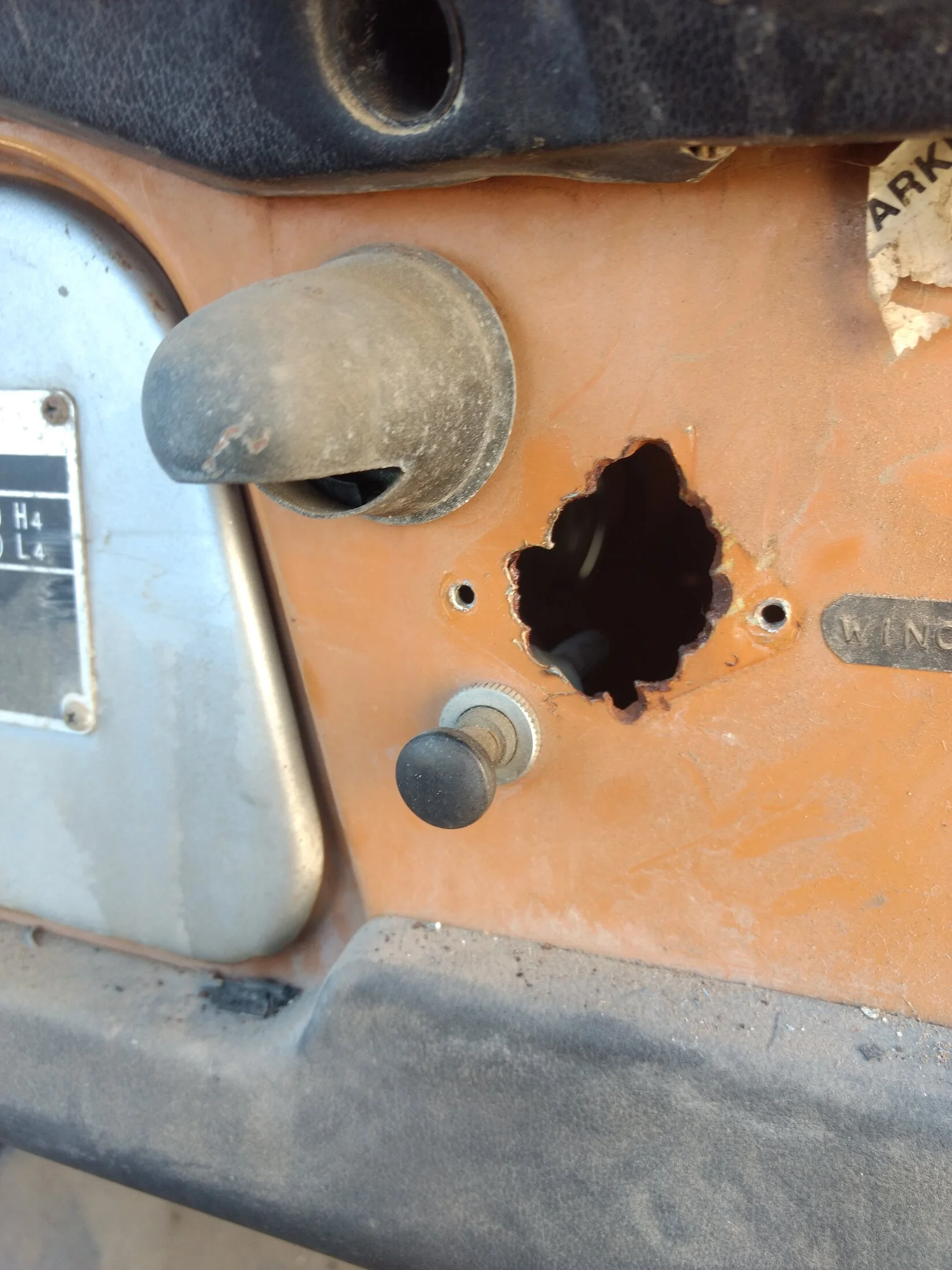

View attachment 3741594View attachment 3741595View attachment 3741596
Yeah that would drive me nuts having that hole there. People did some crazy things back then.
Because it shows a floor shift my guess it is for a 72. Doesn't show the hand throttle as an option but as of 10/69 it was gone from the US market. My 10/69 70 model has a chromed metal plug there. Later Toyota use black rubber plugs.
My 1971 (build date Dec '70) has a chrome plug there too (to the left of where my missing Hazard Warning Switch should be). I'm going to pop that out and put the Bluetooth unit from @thecrazygreek in that spot. Then get the missing Hazard Warning pull switch in its empty hole, and I'll probably replace the cig lighter (since the actual lighter piece is missing) with a very inexpensive piece I put on my motorcycle that had 2 USB-C ports (like all modern cell phones use) + 1 regular USB:
Here is the red dash example I mentioned. It's tight, but it looks like it does fit without cutting the pads. It also looks like if you ever wanted to remove it, the si

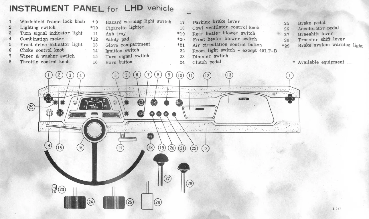

EmanC sent me the link to download a digital copy of the owners manual for my rig (thank you). Looking at the Dash Configuration info, I'm looking forward to looking under the glove box area of the dash this afternoon or tomorrow to see if the "Inspection Light Socket" is still there. I hope so. That would be neat to have.

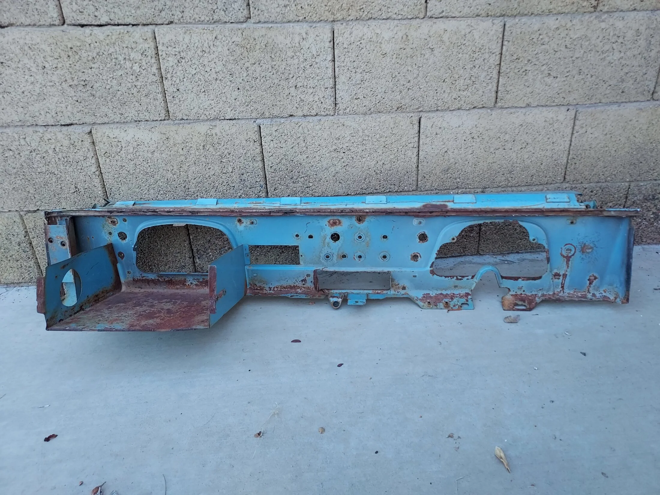

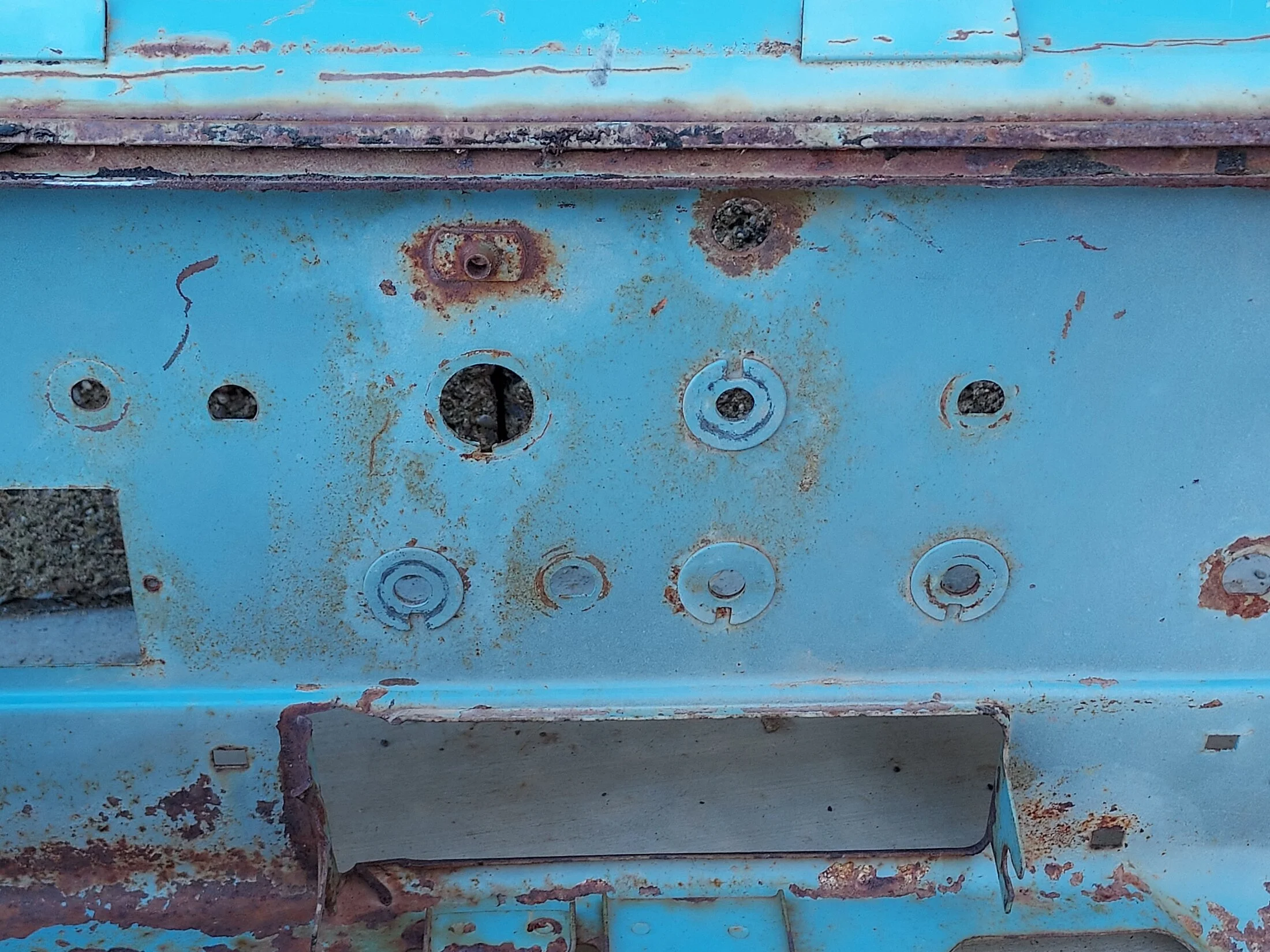

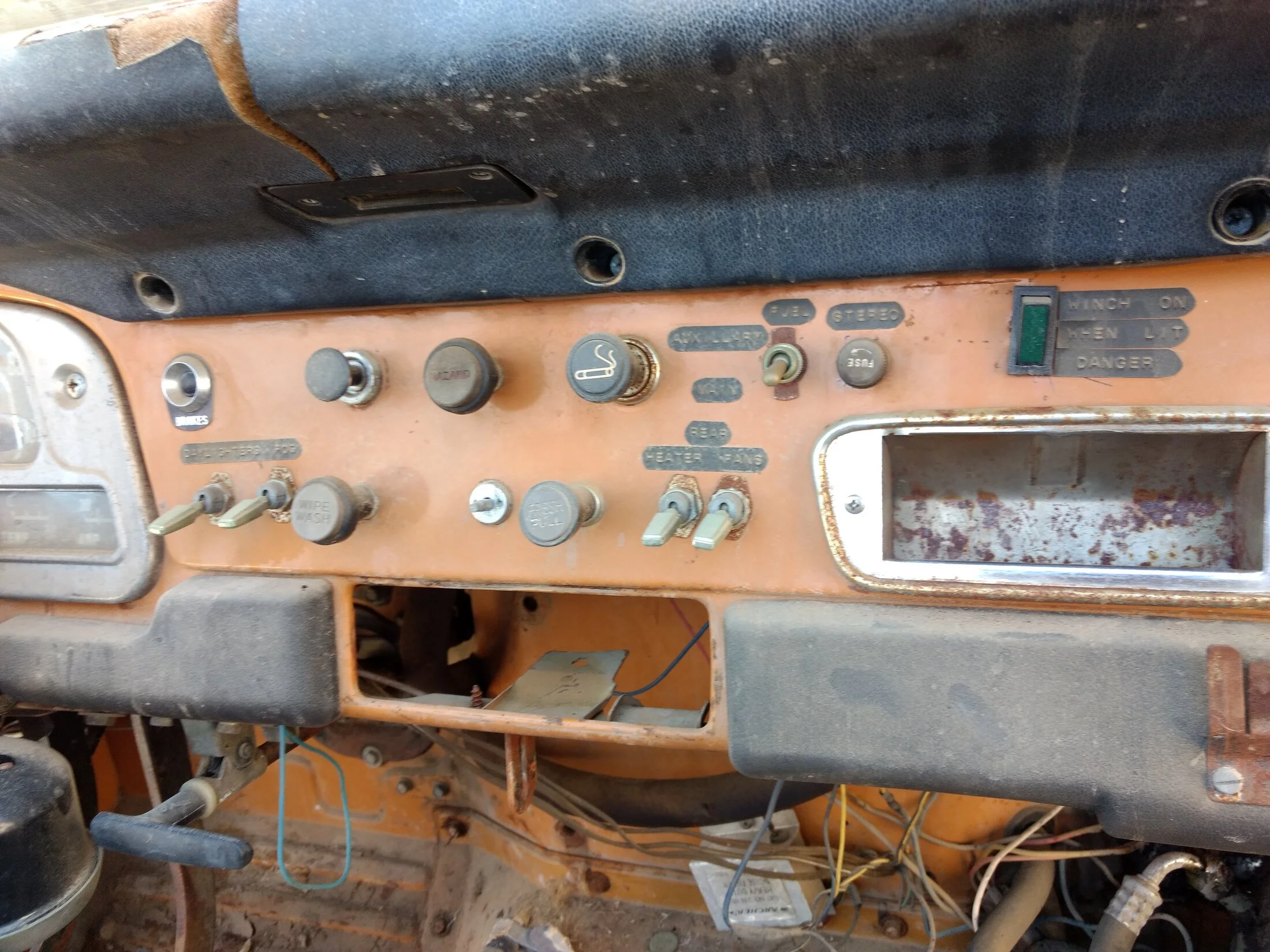

The PO hacked my dash for a slide in radio or what ever you call it. Its weird, the retainer/sleeve mount doesnt fit in the hole. The radio fits, but not the sleeve that holds the radio. I stick a good looking junk radio in the hole at car shows so its not a gaping hole. The junk radio barely fits without the sleeve. Fortunately he didn't hack the pads.
73 is a one year only dash. It's the first year of the radio opening and last year of the working cowl vent in the US market. Believe it is the last year for the Vader light. The interior light moved to the B pillar on the driver's side. Even the B bow on the soft top had the light. This is a 73 dash a friend gave me many years ago of a 73 he parted out. Only a few extra small holes. Widened for a radio but not a total hack cut.
The PO hacked my dash for a slide in radio or what ever you call it. Its weird, the retainer/sleeve mount doesnt fit in the hole. The radio fits, but not the sleeve that holds the radio. I stick a good looking junk radio in the hole at car shows so its not a gaping hole. The junk radio barely fits without the sleeve. Fortunately he didn't hack the pads.View attachment 3741724
Sure a close up would reveal your opening been cut.

Speaking of the cowl vent, for the less than 24 hours mine was here before being towed to the paint & body guys, I remember that to the right of the steering wheel, just below the dash, there was a (if I remember correctly) a round black knob maybe about the size of a ping pong ball, connected to a lever and I think you could push down on the knob towards the floor, or pull it back up. Is that to open and close the cowl vent? Or does that have something to do with the transfer case and 4WD? Again, mine is a 1971 FJ40 with a build date of Dec '70 with a 3 on the tree (which I'm changing to a 4 on the floor).

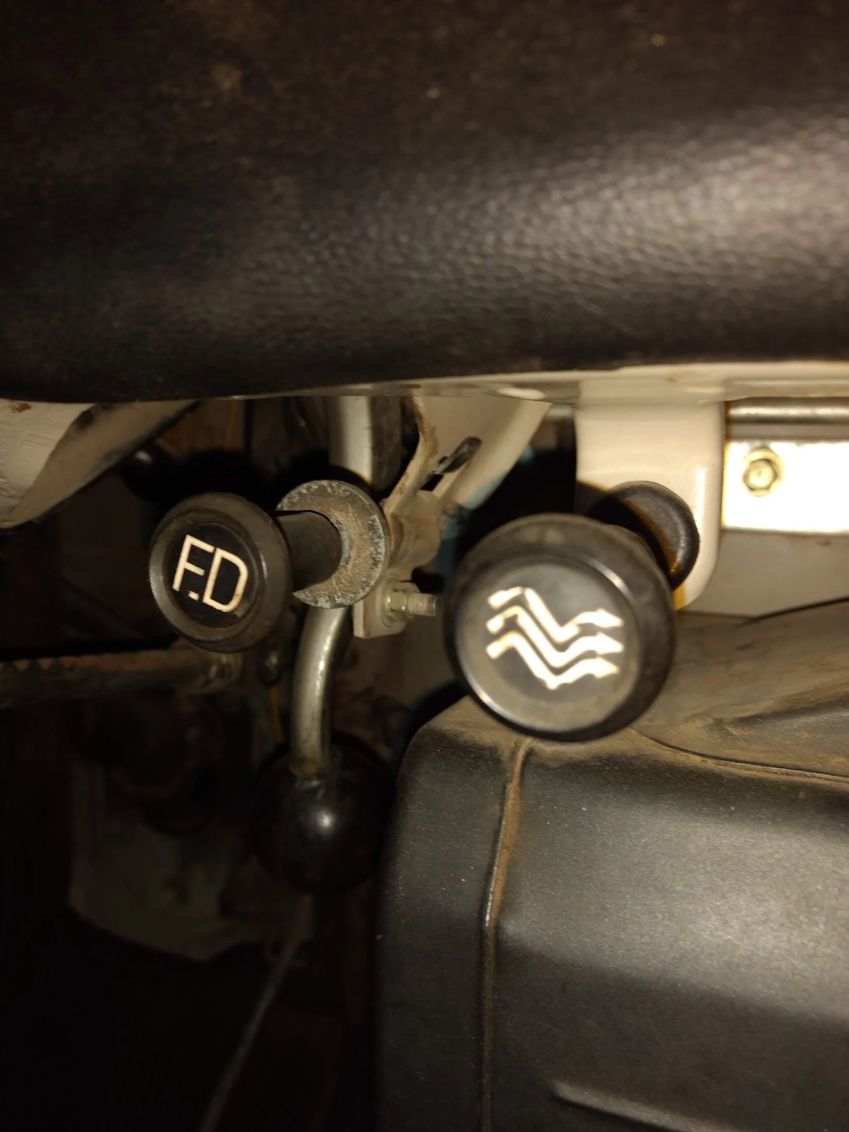

Number eighteen on this dash. Smaller than a ping pong ball. Can see the wavey lines. It also works the opposite of what you would think. Pulled out is closed. Pushed in is open.
OK. Depending on how my back feels, I'll either go over there this evening or in the morning and check it out, and look for the plug behind the dash for the Hazard Switch, and look to see if I can find the plug under the passenger's side for the small plug in light.
Plug for the light will be close to the heater hoses.
Thought I had photo of the plug on my phone but didn't f see it. Here is the vent knob.
Ah, I see the knob I was talking about! In your pic, look to the left of the cowl vent pull knob you are talking about, then the knob with "FD" on it (what is that by the way?), and below the FD pull knob there is a round black knob. That is the one I "thought" might be for the cowl vent. What does it do? Hi / Low Transfer Case for the column shift models?
FD is connect to a cable that operates a vacuum switch for four drive when pulled. Two wheel drive when pushed in. The ball below is used for high, range/neutral/low/range. It has pin out the side of the lever to pull the FD knob out when in low range. The lever is connected to a rod running behind the dash. It's this rod that needs to go when cutting a hole for a radio.
Better picture of the ball and lever.
That's good to know. And, since I am converting from a 3 on the tree to a 4 on the floor, I can completely remove this lever and the rod you mentioned, which means it will also help with installing a radio should I decide to do so.
