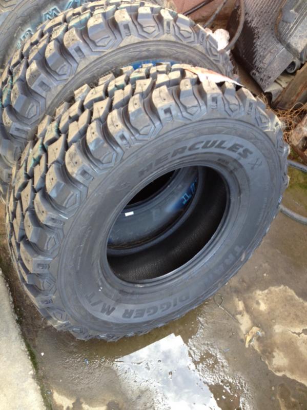

I like your pick of tires. Would you mind posting what size they are. I'm still up in the air on mine.
Thanks,
Ron
You have some nice spare parts laying there sir

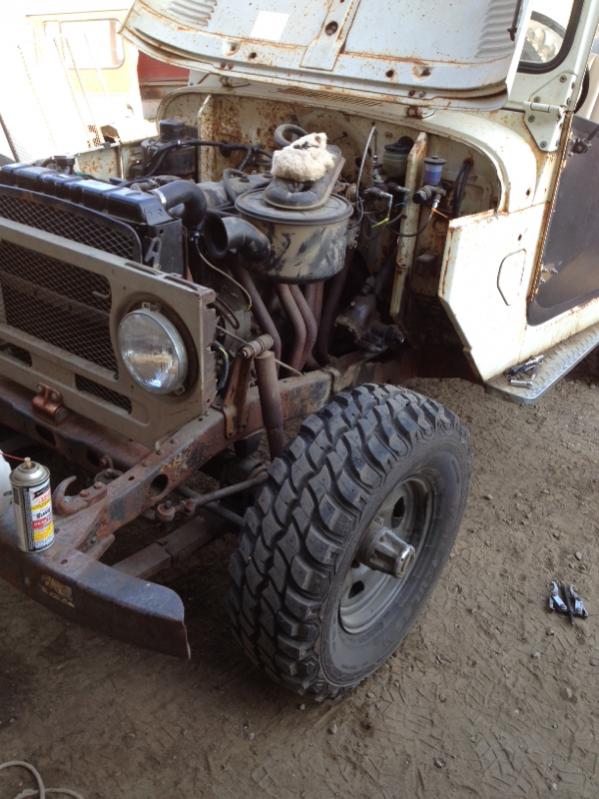

No bezel, so I guess you are not done yet???? What's next?
Well done! Nice looking rig, and a lot of character.
Fantastic build Dan!
Carb on, Intake torqued, pedal installed, throttle cable routed and clutch master installed.
