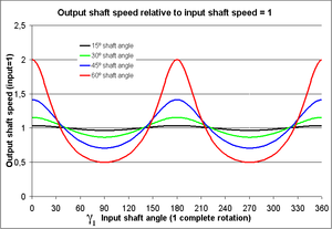

Drive shaft "time" Toyota is very odd to me in this one. Is the picture what you changed it to or they way it was when pulled out?
What about the other shaft.
The picture shows what I would call out of phase. And not correct for drive shafts. I have seen LC with non or both drive shafts in the "time" configuration. The best I can figure is Toyota was fighting harmonics with inputting known harmonics. Kind of like noise canceling head phones. Once you start lifting and things get more worn you have to go back to phased proven approaches.
The ds was off when I pulled it out. What you see in the pic is the way it went in. Here is the pic I followed from beno
My rear is inverted phase and my front is in same phase according to the pic.
That is the great debate I don't agree with Mr.T. When I'm home tonight I'll link a few you tube clips about drive shaft orientation and phase. Inverted phase is the correct and in phase explanation used in the rest of the world.
Cool thanks! Like I said in learning...
