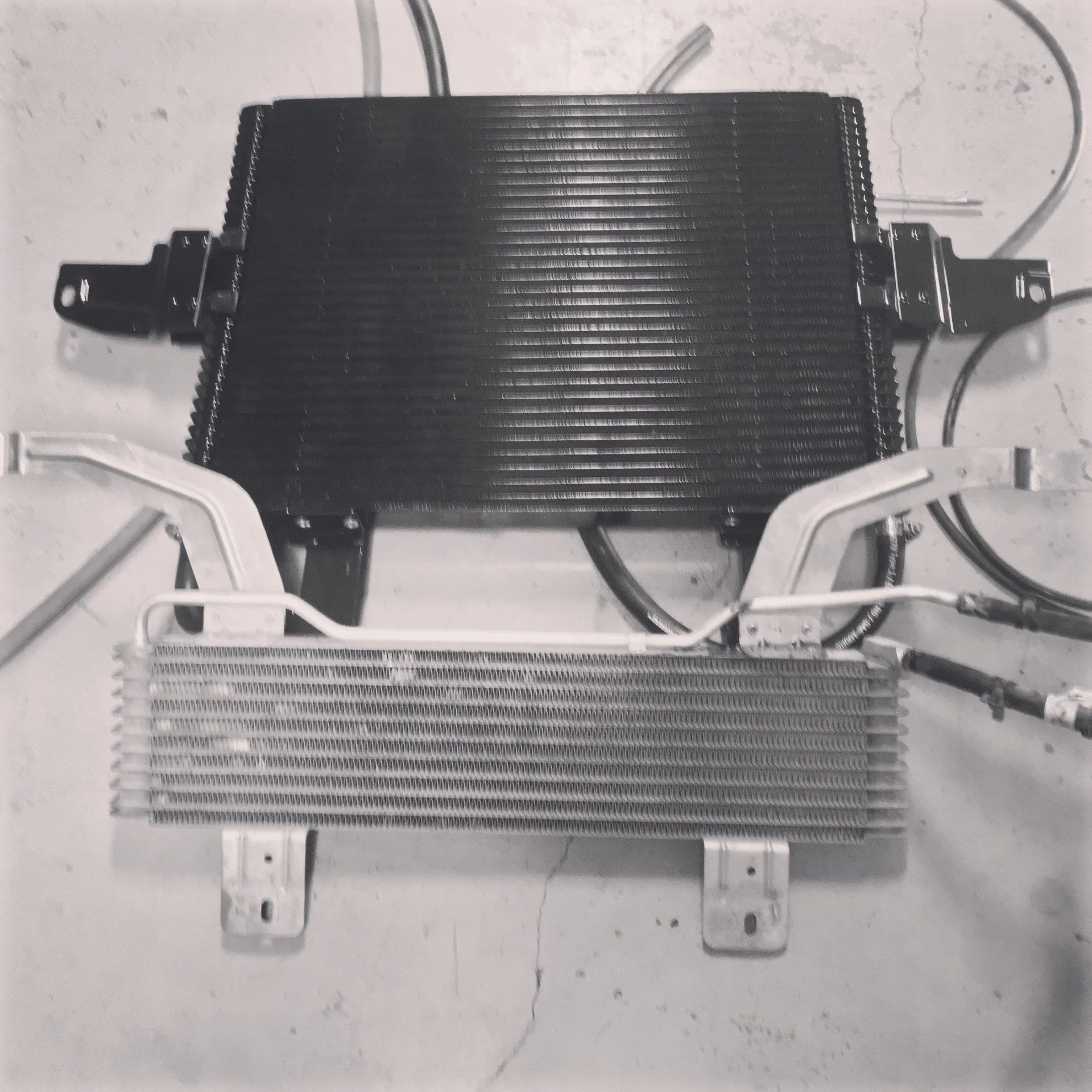

So this was a pain today. I upgraded the trans cooler on the 7.3 to a 6.0. You can see the difference. The trans got up to 230 degrees a few times going from ouray to silverton. From Durango it got warm pretty quick since the climb was almost 4000 feet in 8 miles. This is as hard as the truck will ever have to work so I'm hoping this upgrade will get 'er done. I also dropped the pan and changed the filter.

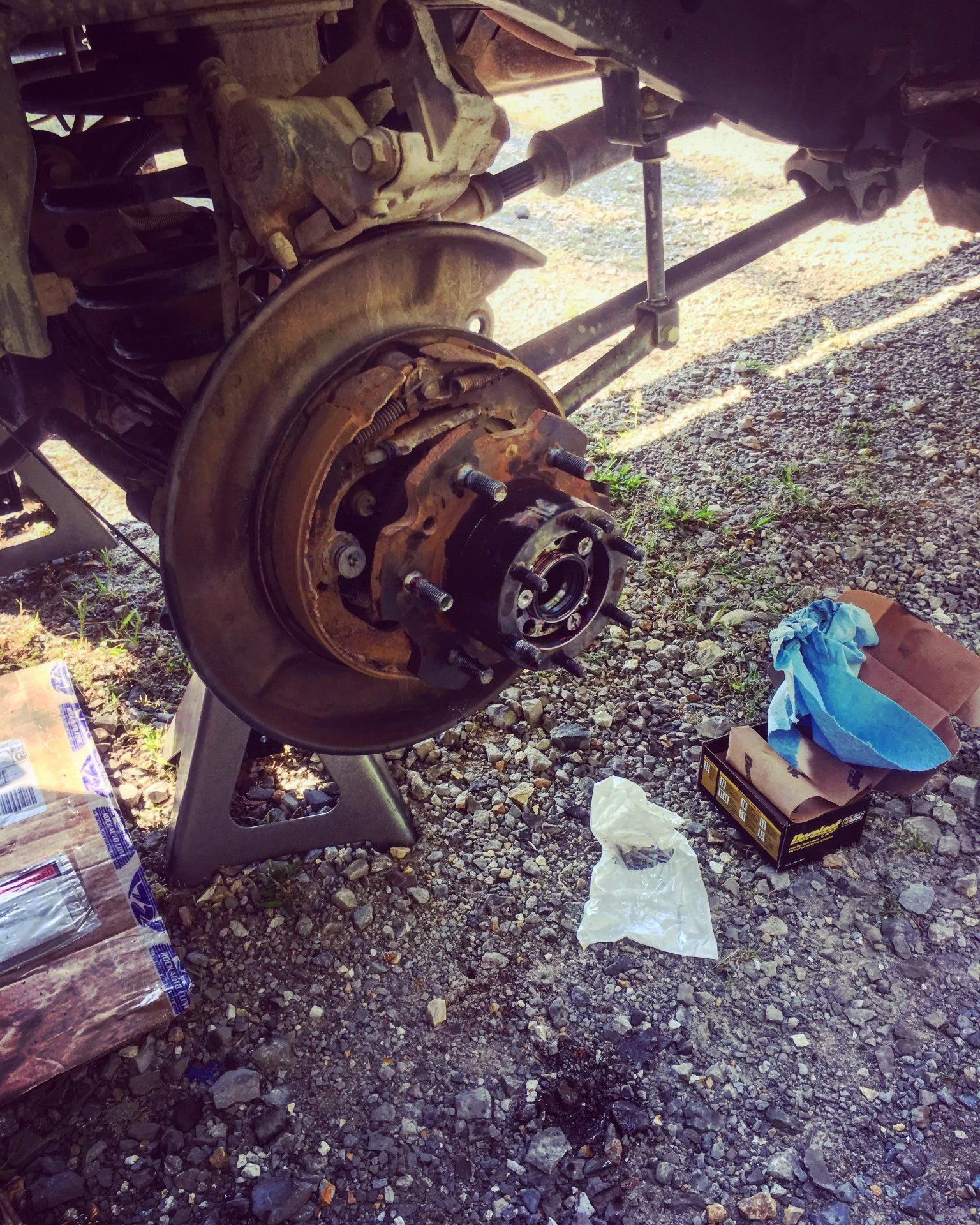

Replace rear axle seals and bearings
Replace all the fluids (both diffs/tcase/trans and oil)

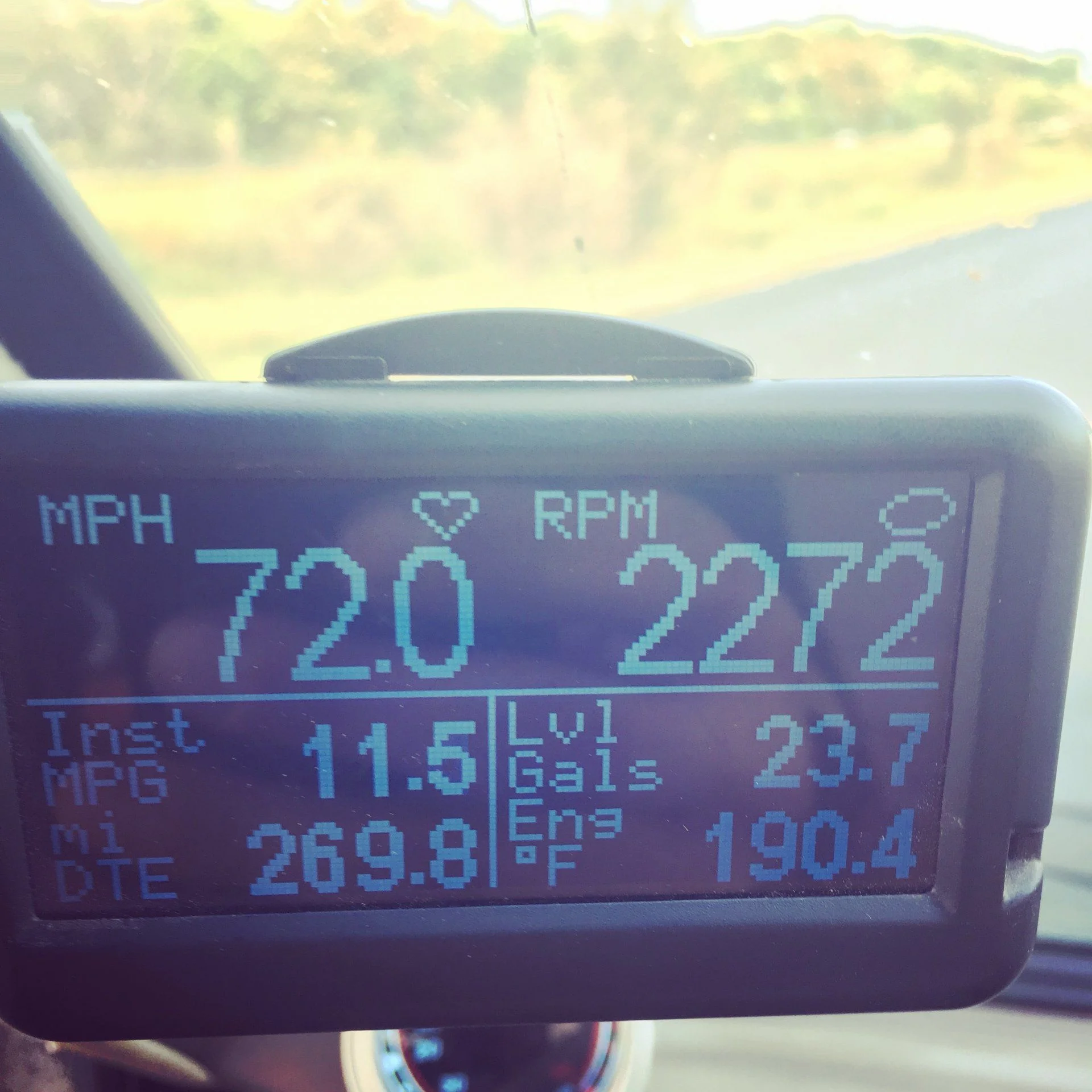

I was running little warm in Colorado due to smaller fan that comes with the supercharger kit/Chinese fan clutch. After I read and re read several topics on mud here is the plan to deal with that
Modified blue fan clutch
93-94 toyota v6 fan part 1636165020
Later radiator swap to 93-94 landcruiser( these are 3 core and have trans cooling lines)
All of these should get me back to where I was before around 190-194 under load doing 75

All done. Oil change. Both diffs and tc. New pads on the back new trans fluid. Fan clutch and fan in. New seals and bearings on the rear. Temps are better but not yet where I want to be. So the next step will be 93-94 3 core radiator. The 93-94 fan is the same diameter as the sc fan but without the ring. I'm not sure about the fan blades.
So this was my temp 90% of the way home after the radiator swap. Pretty happy. That was with ac on and 85 degrees outside. The highest it got was 194. The 93-94 radiator is about 30 pounds heavier. Bolts right in.

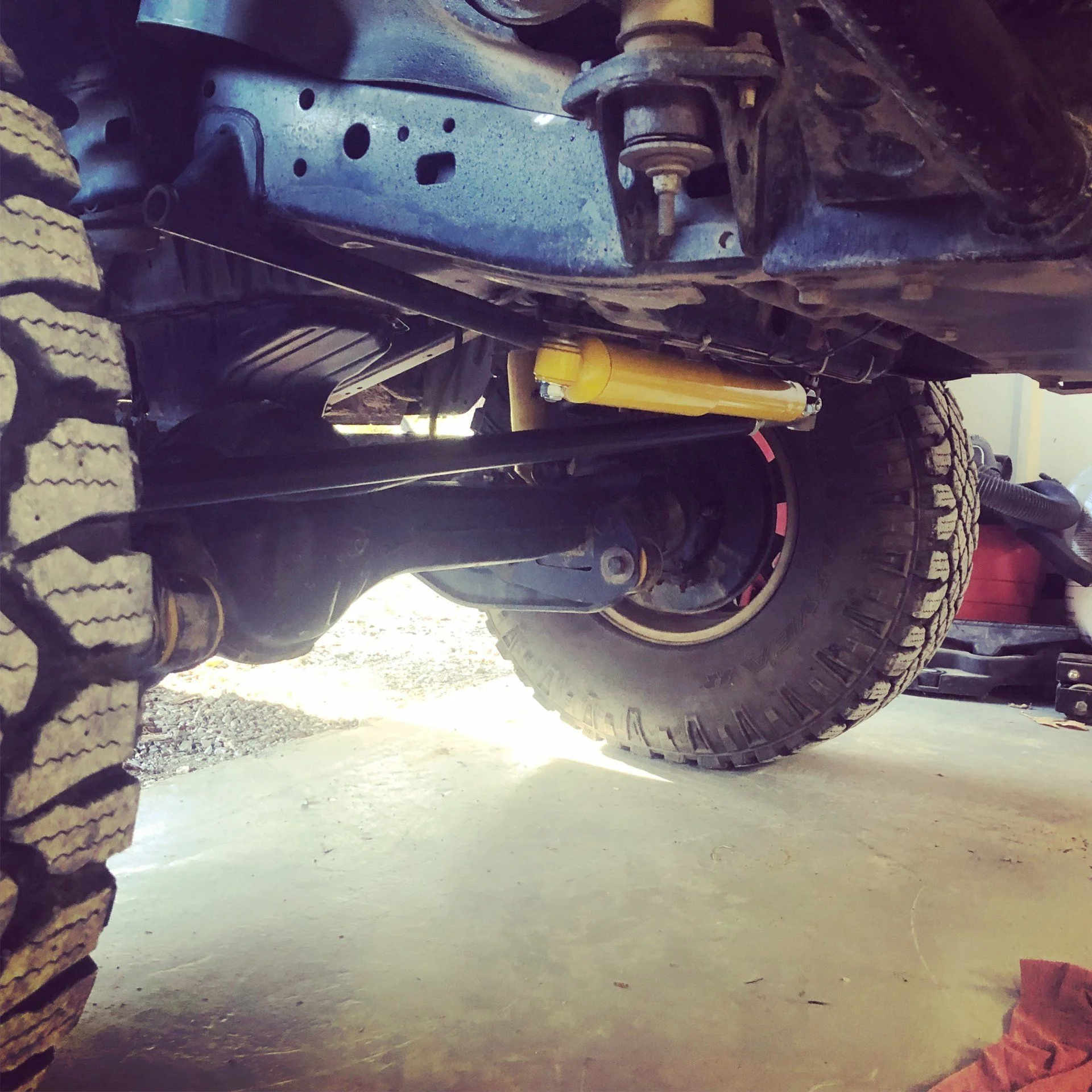

Quick upgrade to the lx. Drag link and ends along with new steering stabilizer. I have some big plans for 2019.....stay tuned.
