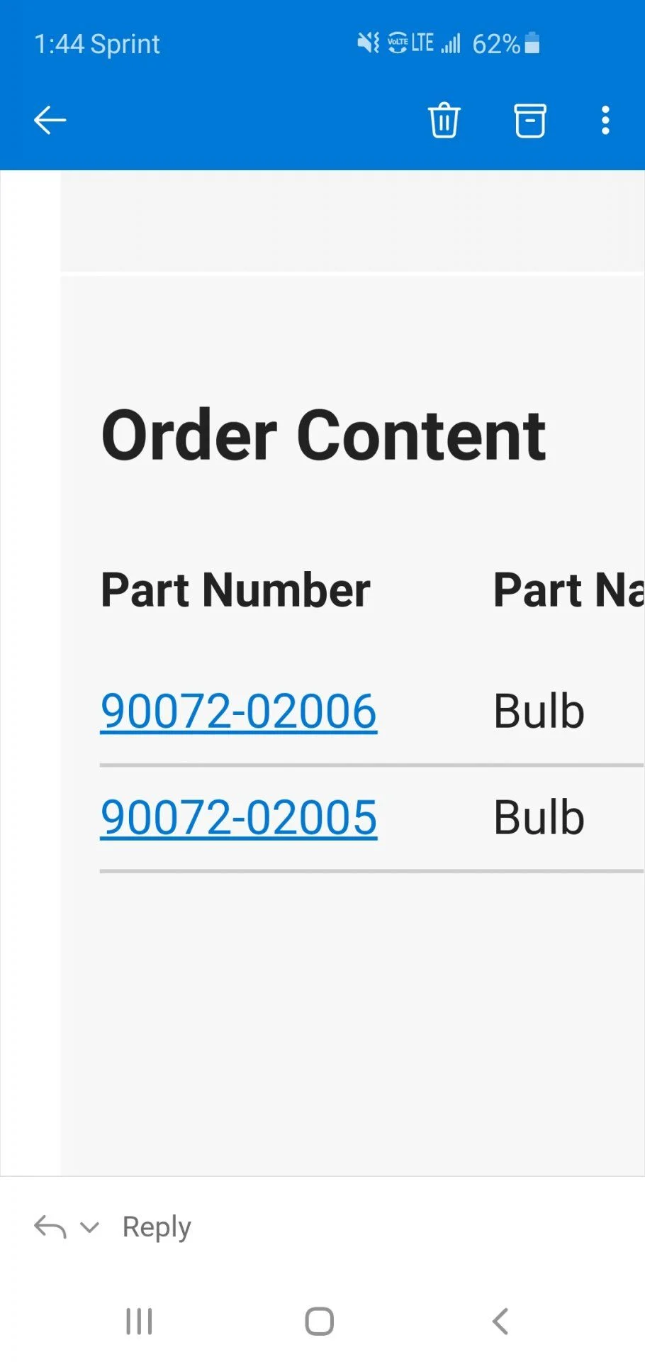

and yes, the little bulb can be had from Toyota - and there's a small "sock" that goes over those bulbs, to make them light up red or green or whatever Mr. T wanted them to be
sorry, I don't have the parts numbers handy
@Onur know the P/N for the green bulb condom??
Top number is the for P (park with the green condom) the bottom part number is for the rest. Just did mine.
