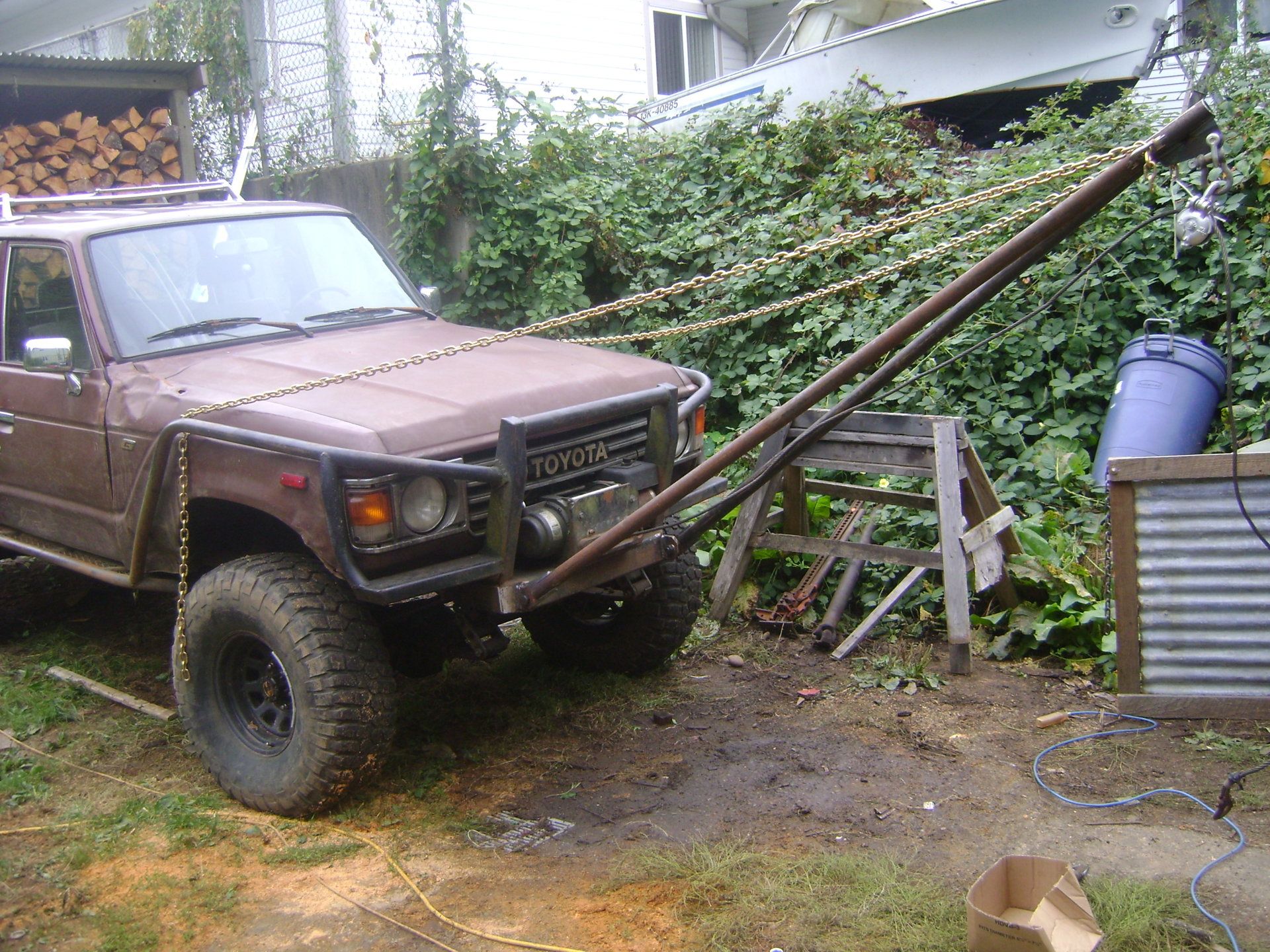

Got the second beam up today, and it's kindof a tall bitch. :lol:
Lifting methods look rather sketchy, but it's not that much weight.

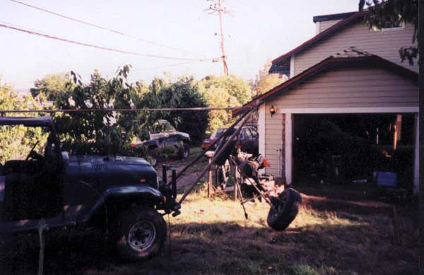

Crane life with a cruiser
