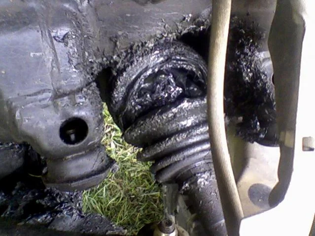

As long as you don't drive in rain and mud it should be fine. Mine was completely separated for about 6 months. No rain, no mud and no automatic car washes during that time frame (not the wifes daily driver). Even after that time period and lots of grease slinging out, the joint was still coated and covered very well in grease.
Get a grease gun and pump some grease in there if you can't fix it straight away. I had to do this to mine for a while till I got time to pull them.
attachment.php
attachment.php
That looks like a crime scene.
