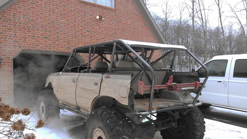

cut to here and do a very minimalist cage and you can keep it hovering around 4200lbs with 35s. 1fz is great at that weight......along with brakes. Relative strength of parts increases 20-25% to boot !
