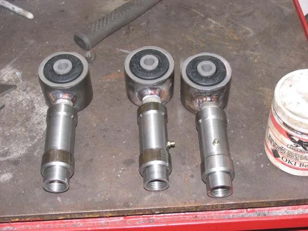

NEWPIG is sporting an off the shelf J’ lift F&R. I am running 2” drop spacers in the front to level and get the true lift. Shocks are also off the shelf Old Man just for this coming event. There is no correction for caster or pan-hard bar pull for now. This is a non issue since the truck will spend distance travel on a trailer. When I get back from CM the front axle is getting linked using my Hyper-joints I started testing this last year.
attachment.php
Here is a thread by Rascal were he 4 linked his 40 with a set of the proto’s. https://forum.ih8mud.com/showthread.php?t=51130&page=9&highlight=hyperjoint
The key thing with these is you get the shock absorption with the almost 3” rubber bushing, yet it can freely rotate on the threaded shaft. The main body that welds onto the control rod has a zirk to grease the threads directly and an engineered lip seal to keep the junk out (No offence Junk!). The concept has been around for awhile. My thought all along for these is for under the 80.
We now have 4 test trucks running these all are large V8 built FJ40’s (38” to 40” tires), no issues. I will do a three link in the front with the panhard bar and 12” coilovers. The rear will just get re-linked and a set of long travel shocks. I hope to move the rear axle back a few inches to be able to cut into the body more for stuffing the tires better. I would love to do it before CM but just don’t have the time. (Wondering if I will get even what is started done!) I will use Rubithon as the dead line for the front re-linking. I am loosing travel by not being able to put a longer shock on up front. The brake master cyl. Is in the way to extend the shock height under the hood, unless I pull the ABS system, and I am not ready to do that.
Mark
